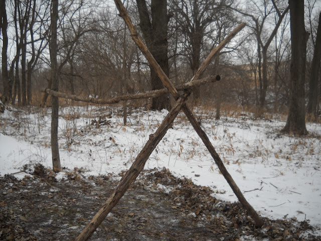

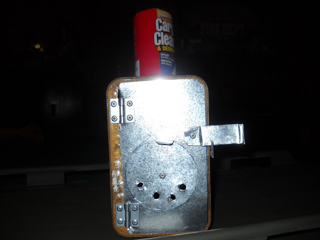

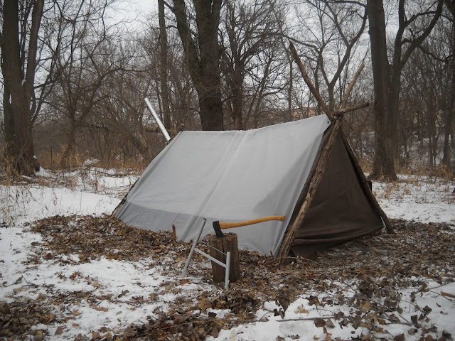

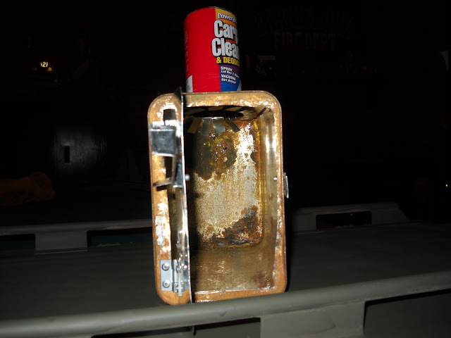

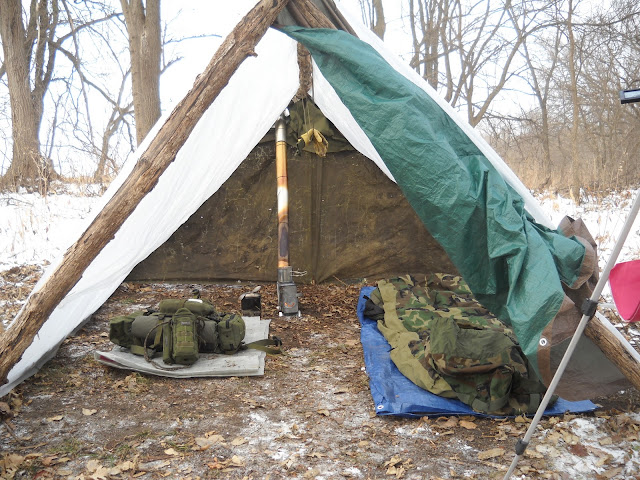

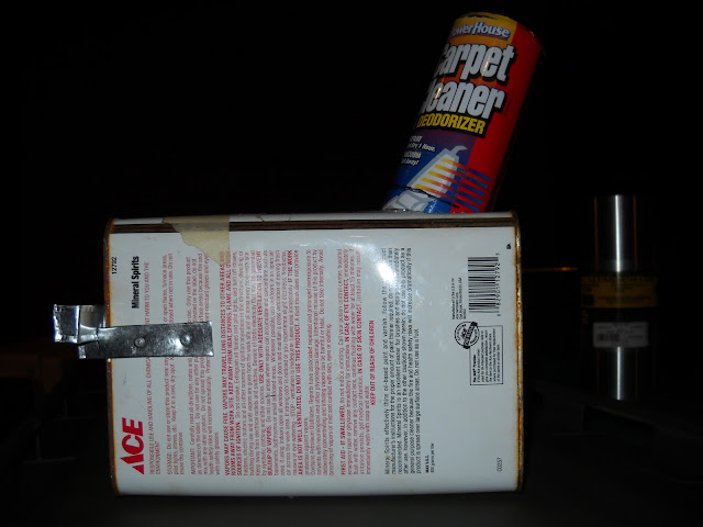

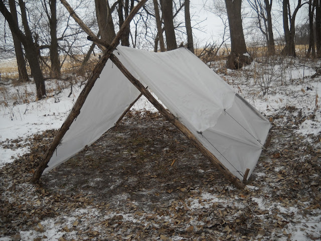

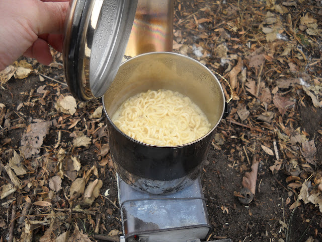

For the last year or so I have been trying to muster enough coin and guts to buy a high end tepee type tent with a stove. I have come to the conclusion I am going to make my own. I put up this shelter to test my I gal Coleman fuel stove I made I learned a lot. The next stove will be much better.

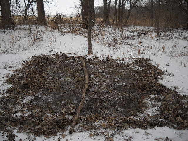

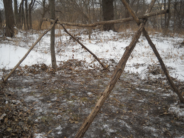

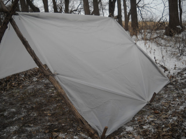

These are some pics of the shelter going up.

How big is this overall width, length, height @ center? How did the stove work out inside there? Thanks for letting us take a look . . .

I was warmer than outside. But not what I am wanting. I am gonna make a little bigger stove. I also need to add a damper to my pipe.
You can find some good info on living in and heating a tent during winter in "A Snow Walkers Companion" by Garrett and Alexandra Conover. They claim to easily heat their tent to eighty degrees while the temp outside is sub-zero. Obviously since a tent isn't insulated it won't hold heat for long when the fire dies.
It is about 5' tall x 10' long x 10' wide. I think it is a little big for this stove.

Also, did you raise the stove off the ground or have it on blocks? How long does it fire for and what size wood are you getting in there? Really want to play with this concept myself. Thanks!
After all of my testing I hope to use 2 10x10 tarps and 2 8x10 tarps for a mobile shelter. I would also like to figure out a way to fold the stove. This way I can put it in a pack or sled. I folded a couple of pieces of flashing and wired them to the stove to keep it off the ground. The wood is about 6" long and thumb size.
can you please explain on how you made that stove. i would really like to make one for my shelter.
