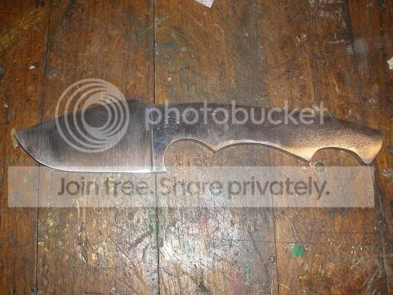

So here is knife number 4, not sure what this style is called. It is a single bevel, 660 layer 01 and 1095, 6 3/4" X 1 3/4" blade, 12 3/4" overall, and about a 1/4" thick near the handle knife that so far I really like. Maybe just cause it is different a little.
Not sure if I like the shape of the handle, got too make another one anyway cause this one has a few bad spots where the 1/8" end mill bent egging out the holes. ( I was going down SLOW to, took almost an hour to do the 10 holes)
This is the first knife I have tried to bevel on the contact wheel, not sure what that kind of bevel is called? All my others have just been straight bevels. Where I am running into trouble is here,
can't seem to get that corner crisp. If you remember my homemade grinder my contact wheel does not have a work rest on it.
This bevel is completely free hand. So any tips on how to get a nice crisp corner? If a work rest is all it takes I'll make one. ( I did do them uneven for practice sake, figured I would not get it right on the first try) I have quite a bit more to take off until the line to edge is even on the tip.

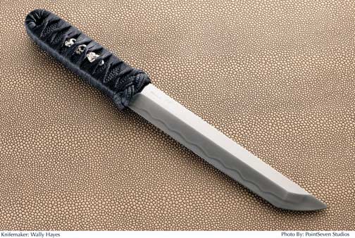

Looks like an interesting piece. Handle looks a bit small though, but seems designed to fit your hand. The style of blade that resembles is a Tanto.
If it had been my knife, I probably would have kept the overall width of the blade the same from the handle forward and even narrowed it a bit.
Since you are having to redo the handle, I would make it bigger then it would look more in proportion to the blade. Even then you could probably take some off the width make it more symmetrical.
Bevel looks damn good for free hand :)
Thanks for the input. I have been walking around the house holding it and playing with it, my wife keeps looking at me like I am some kind of nut job, but after doing so I do not like the feel of it, comfortable for a few minutes. I would not want to have to hold onto it for any long period of time. So the new handle is going to be different, just not sure what..I am open to suggestions. It does need to be bigger I do agree with you there GrizzlyBear, but a different shape, or maybe just smaller spaces between fingers. Guess I'll sleep on it.

If you're going to have the finger cutouts, I would curve the back of the handle to flow more with your hand. I think the handle needs more meat to balance the blade out, that's probably where it's not feeling right.
To me it looks like something is missing from the handle. For a blade that big looking the handle looks like it doesn't belong on it. I would have the handle curve like Grizz mentioned. If you want finger grooves in the handle for every finger I would make them curve and come to a point between each finger. Grab a piece of Play-Dough roll it into a log and then grab it and squeeze a bit. You'll notice the areas between each finger are very narrow. That tip btw was told to me from Bladsmth on here and a great way to mold scales or handles for a knife. Get some modeling clay or Play-Dough and mold your handle out of it. You can pick up a 4 pack of play-dough for like $2. Something along the lines of this is what I'm talking about for the finger grooves. I just opted to not put one between the middle and ring finger. BTW love the RATM CD selection but not big on the Jay-Z :D

Maybe put some lines cut into the spine where it curves up as the thumb rest.
And, maybe round the points of where the handle goes between your fingers and at the ricasso. Not much, mind you, but they look really sharp in the pic.
Yeah I made the finger areas less pointy that was taken right after the bevels were done. Lines in the thumb rest is a possibility as well probably use a hacksaw or something similar. I really need to get myself a checkering file too.

Well after getting the new handle to the point I was ready to start shaping it, I dropped it and it broke. Unstabilized wood sucks. I wanted to buy a piece of black G10 so I guess I will wait until I have a few extra bucks and buy a good chunk of it.
