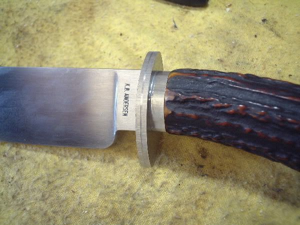

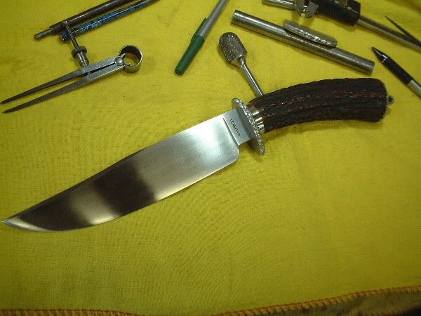

I'm doing a forge building tutorial for a few friends of mine and had the camera in the shop, so I thought I would show you the next knife from Andersen Forge.
Remember Andersen Forge?
It's a forged W2 8 inch Bowie with a rather nice hamon. One of those really dark Sambar Stag handles and a bunch of Stainless steel take-down hardware.
I got further along in the "progress" part before I took any pictures, and for that, I appologize.
The guard will get shaped and then rope file-worked for a little Western Flair!
Spacer and butt cap are shaped to the handle material.
Handle will be left about 97.625% intact shape-wise.
Stay tuned!

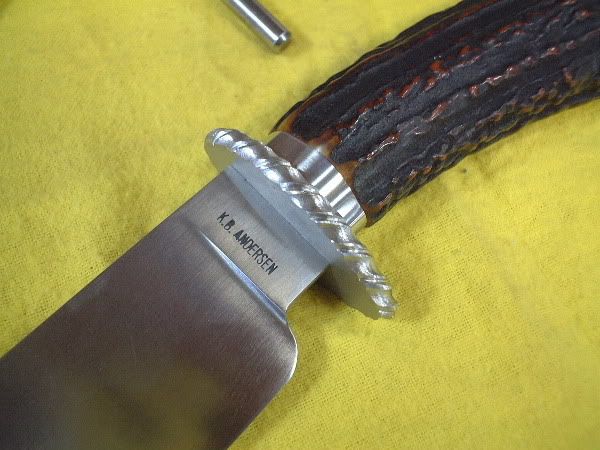

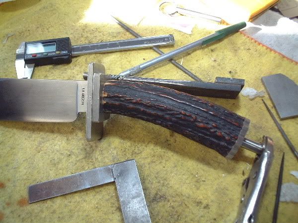

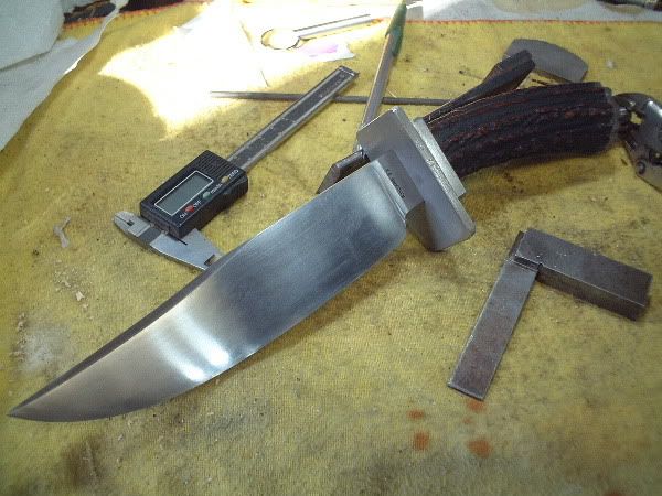

Here I have further refined the piece fitting and have turned the guard into an oval.

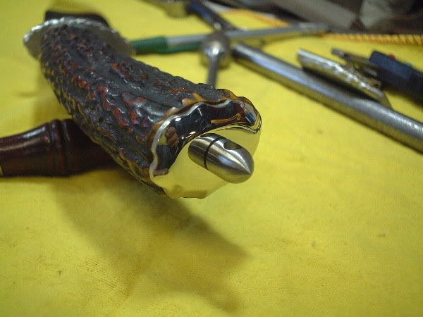

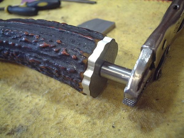

A little better view of the butt cap and finial. I always leave the finial in this condition all the way up to about that last thing. I tighten the knife up each time with VISE GRIPS!! That way, I'll know it's gonna last - if it's gonna break, I want it to break in MY shop - not yours!

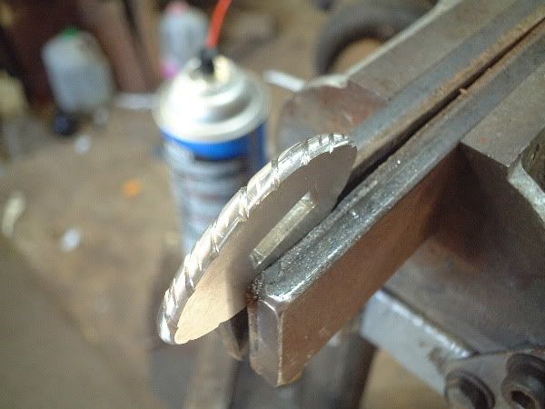

Here I have rounded the guard over in preparation of rope file work lay-out.
Here is some of that lay-out in progress:
File work mostly done. About all that's left is to polish the interior of the file work and handrub the remainder of the guard.

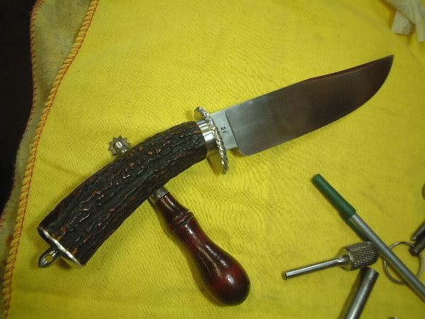

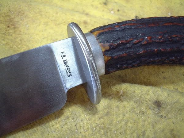

Another view:
A finished butt cap and finial:

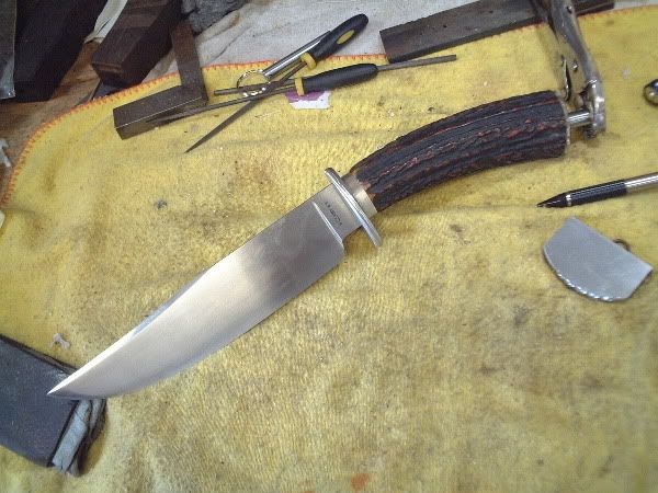

Two views of the knife about 90 percent done. I still have to polish out the guard file work and then etch the blade to reveal the hamon:
