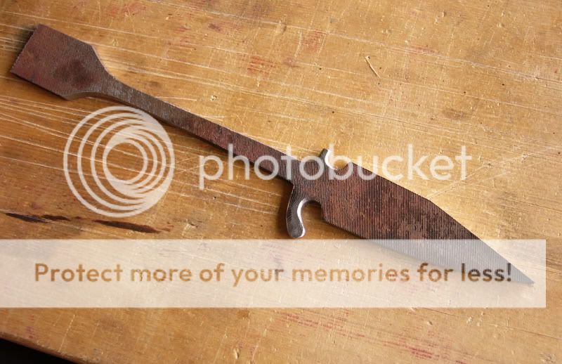

Hi all. I made this simple one a while ago, before I started posting here and thought you guys might like to see it. It was supposed to be a dagger.

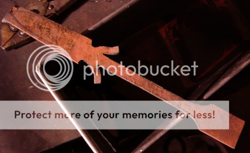

After some cleanup...

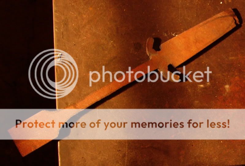

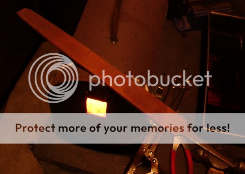

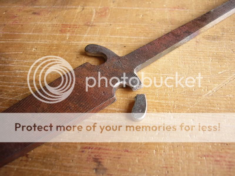

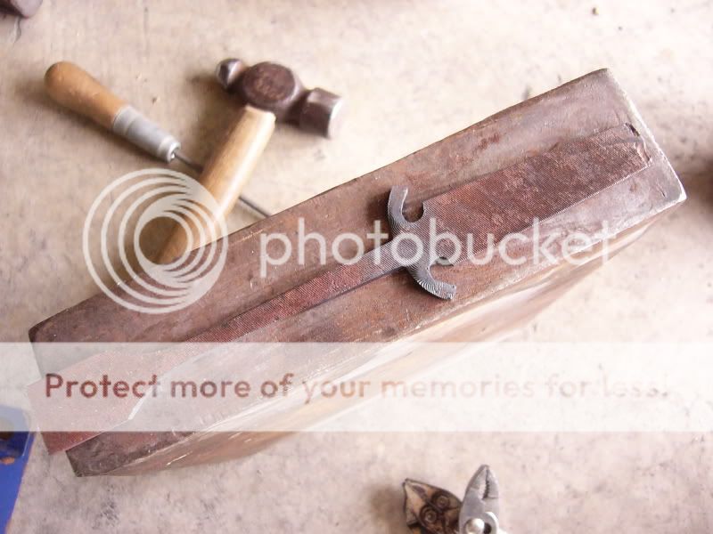

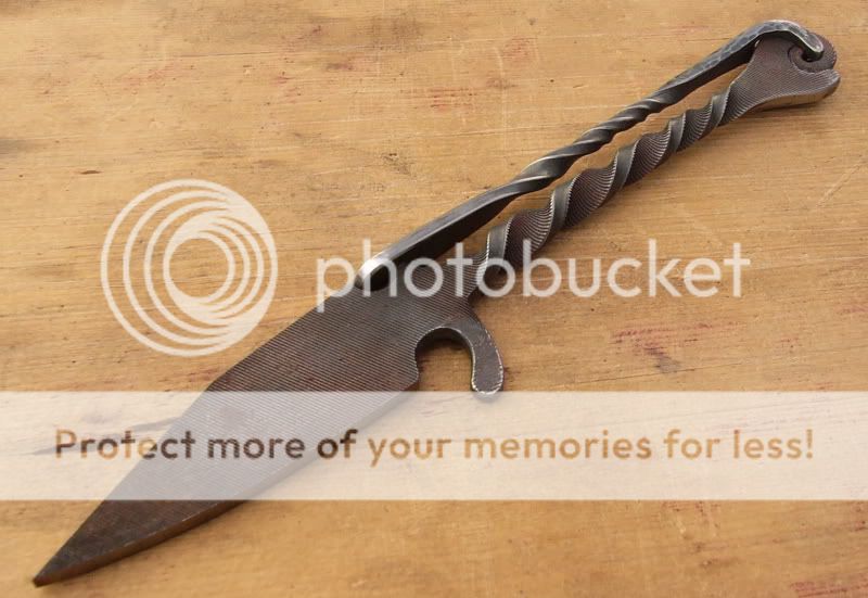

And then disaster! While bending the guards I notice two cracks appear on one of them.
Well, lets make something else with it.

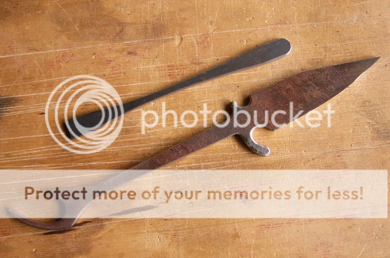

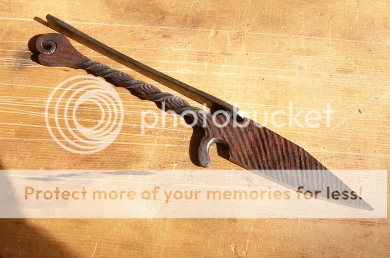

Butt area modified and second piece cut out.

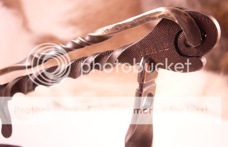

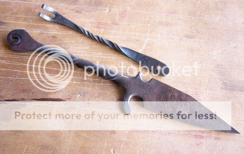

Twisted handle and trial fitting.
Second piece twisted.

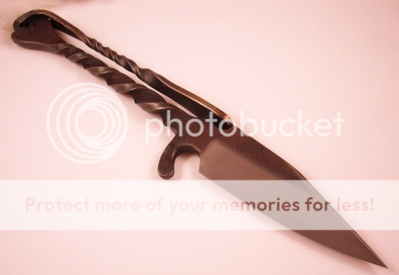

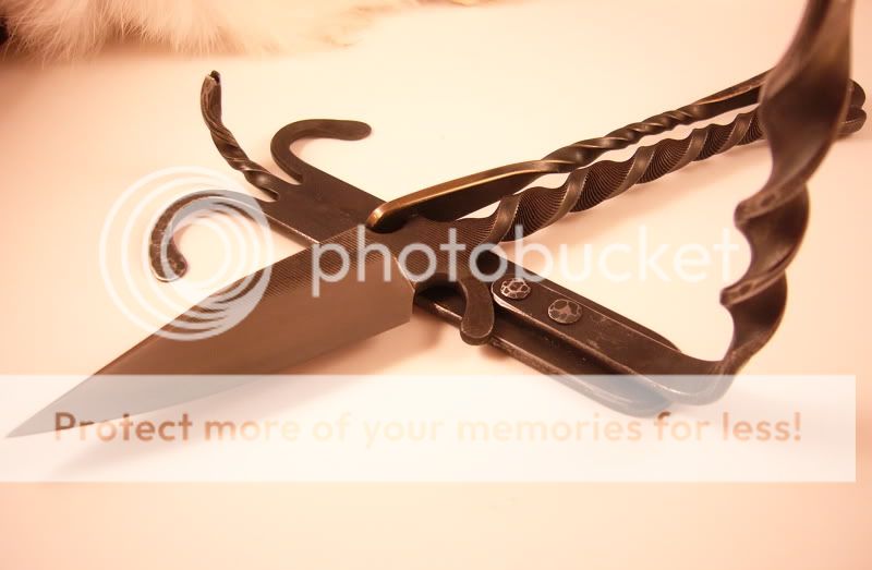

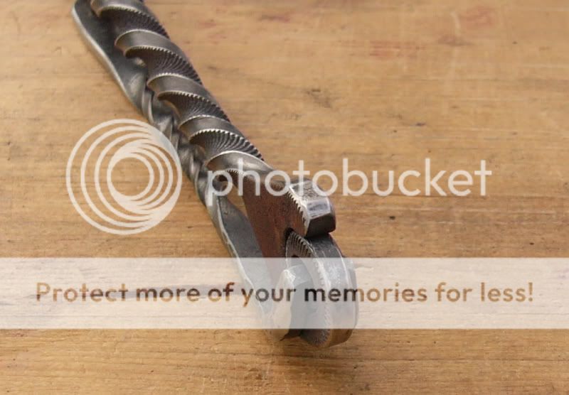

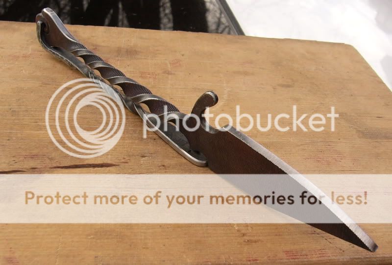

And put together.

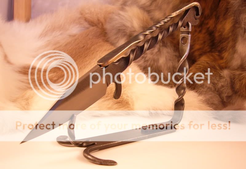

Finaly the finished knife and stand. Overall length is 7.75" with a 3" blade. Blade is made from a Nicholson file, top piece on the knife and both stand pieces are mild steel. I left a slightly bronzed color on the handle from the oven tempering. Blade has a slight temper line.
