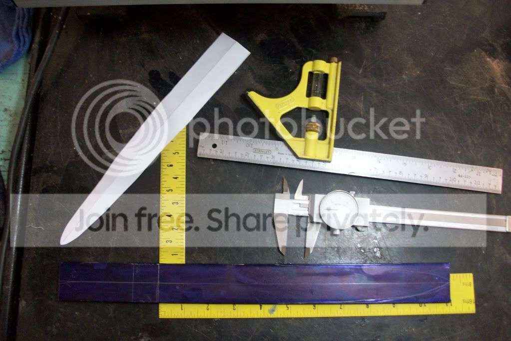

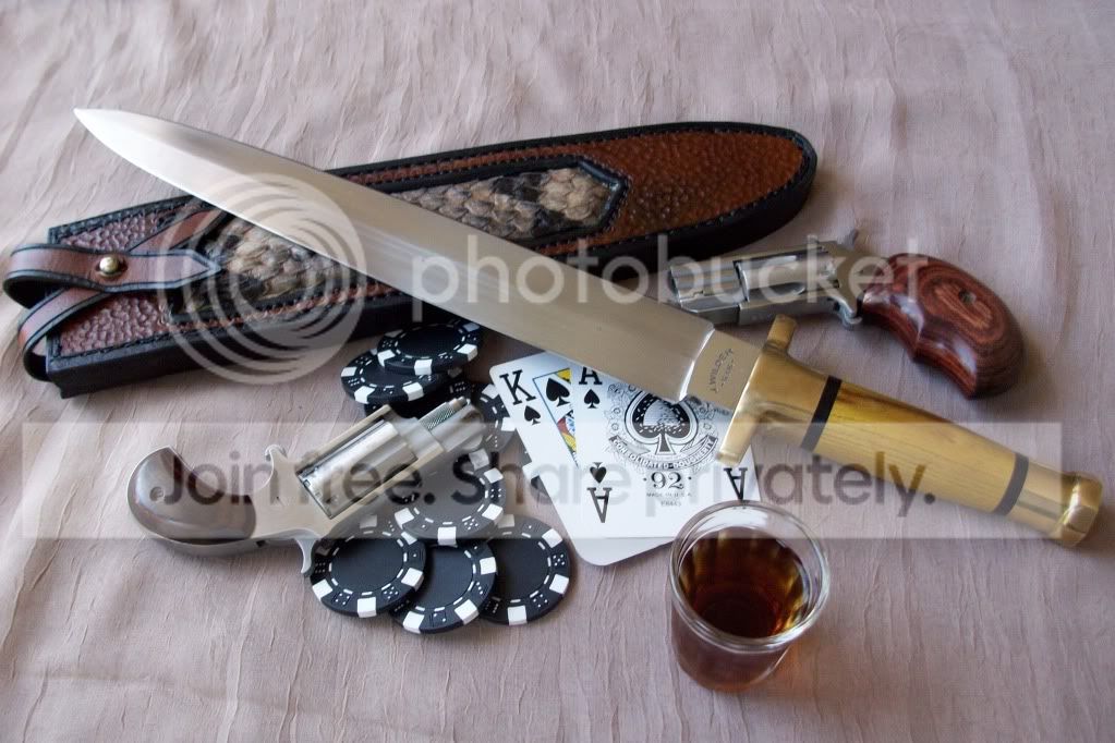

A friend of mine has always wanted an "Arkansas Toothpick" but didn't want one that came from China. He sent me a picture of one he liked by John Nelson Cooper and told me to see if I could make something similar.
Here is the picture he sent me:
So I got some of Aldo's 1084fg. This is 1.5" wide and 3/16 thick. I decided to do stock removal instead of forge so that I can keep the center line more even.

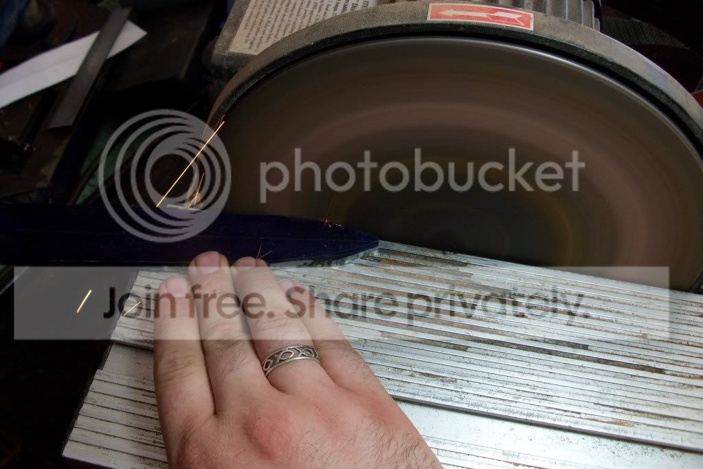

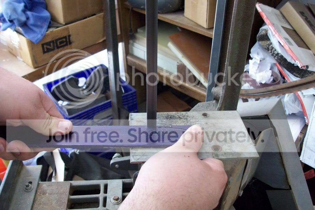

I cut out the profile on my metal cuting band saw then moved to the 10" disk sander.

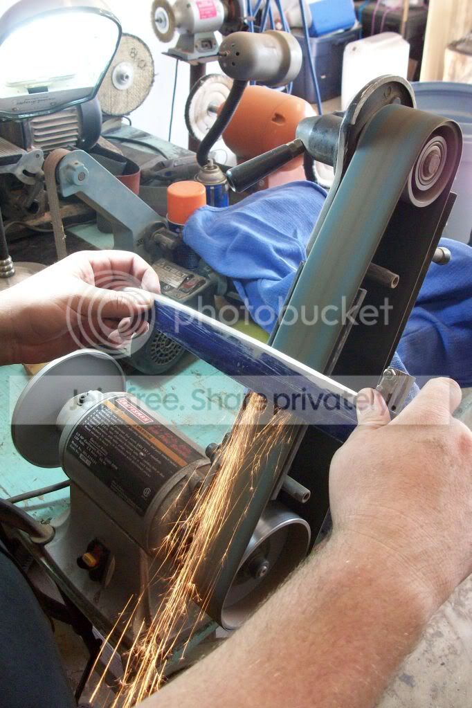

All of the grinding was done on my Craftsman 2x42 while my GIB was being built. This grinder has a 1/2 HP 1725 rpm motor behind it running it. The 1/3 HP Craftsman motor is unplugged and just used as an arbor.

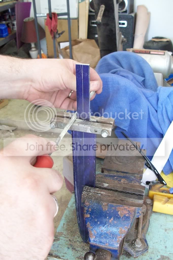

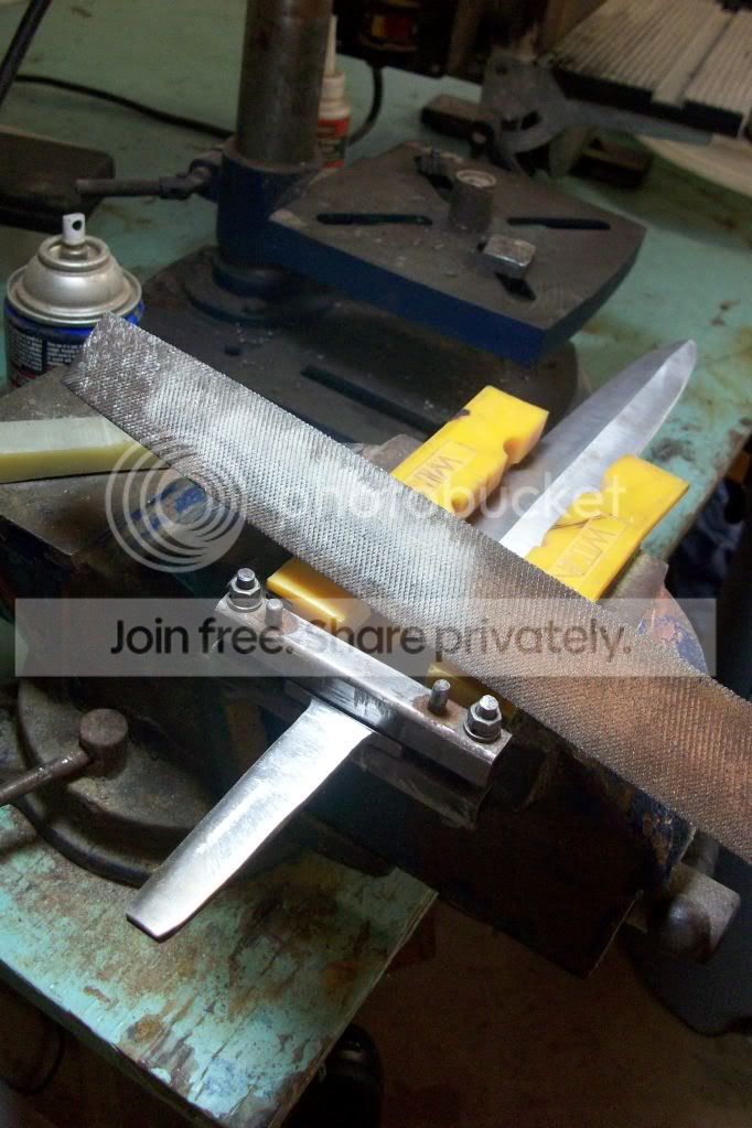

Next I work on evening out the shoulders. This is with a simple jig that I made. I would rather have one made out of carbide, but this works for now.
Here the shoulders are squared up. I even put a shoulder on the face of the blade. Thanks Nick for that tip!

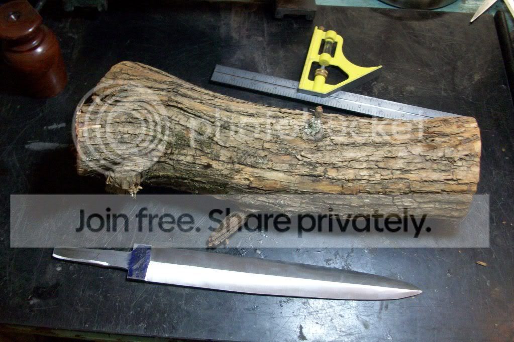

Before I go too far, I cut the Osage Orange out using a chainsaw. This stuff is horribly tough to work. I had nothing that would cut it except my metal cutting bandsaw, and the wood broke the blade!!!
The spacers are 3/16" black linnen micarta.

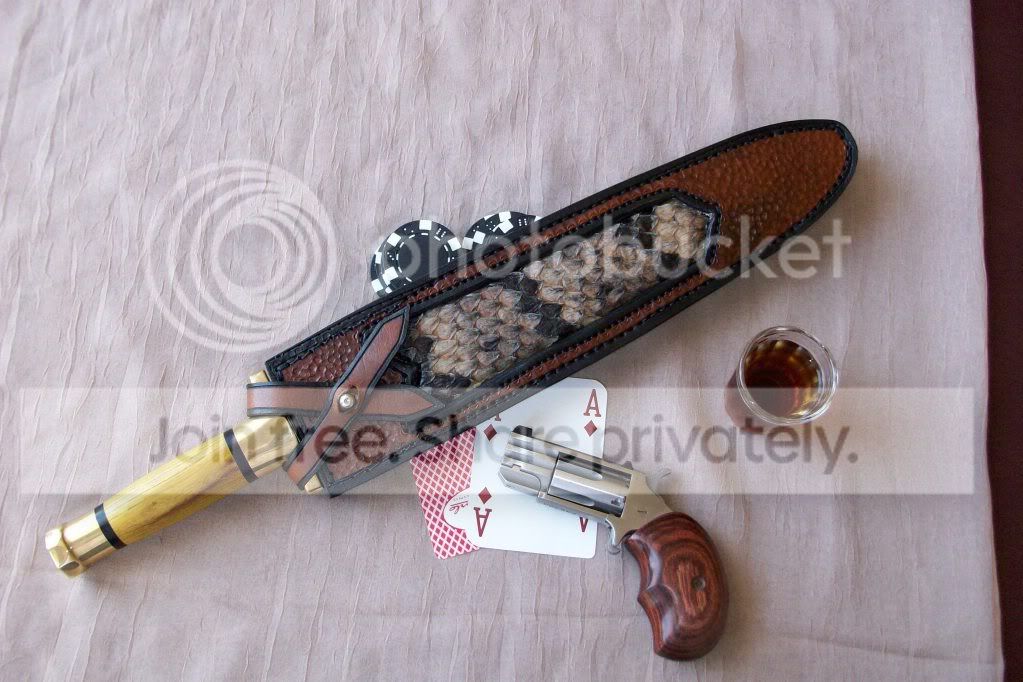

I made my first snake skin inlay sheath. The skin came from a timber rattlesnake that my friend kept as a pet for 8 years until it died. It was 6' long. He found another one the same day this one died. He was kind enough to skin and tan his "pet" for me.
After I took the pictures, I decided to force a patina, so the blade is now darker, but I didn't get pictures before I sent it.
Hope he likes it.

Jason, I'd love to criticize. My ability to spot flaws far exceeds my ability to correct those flaws.
I would have liked to have seen the dark streak in the wood more central in the handle.
The edge on the J side of the logo seems to be a bit wider than the other side. Even by the tip, the J side seems wider. Could be a trick of the photo/lighting.
Great point about the dark spot in the wood! That is something I wouldn't have thought much about.
I think the logo is centered right, but I didn't get a ruler and measure it before I sent it. I'll measure it next time before I etch to see how centered it is.
Thanks!!! Keep em coming.
Jason
Sorry, I think you misunderstood. Here's a picture that might explain better. Again, this may be a trick of the light and angle the picture was taken at, but it seems the same in a couple pictures. Any chance you'd show a picture of the back side of the knife?
I like the knife, very nice overall.
Not sure if I took any pictures of the other side before I sent it out. I will have a friend photograph it, and see if I can get one of the back.
