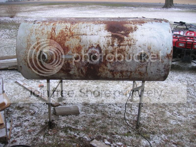

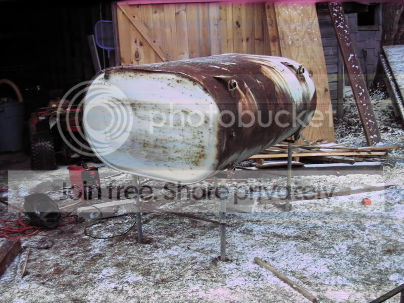

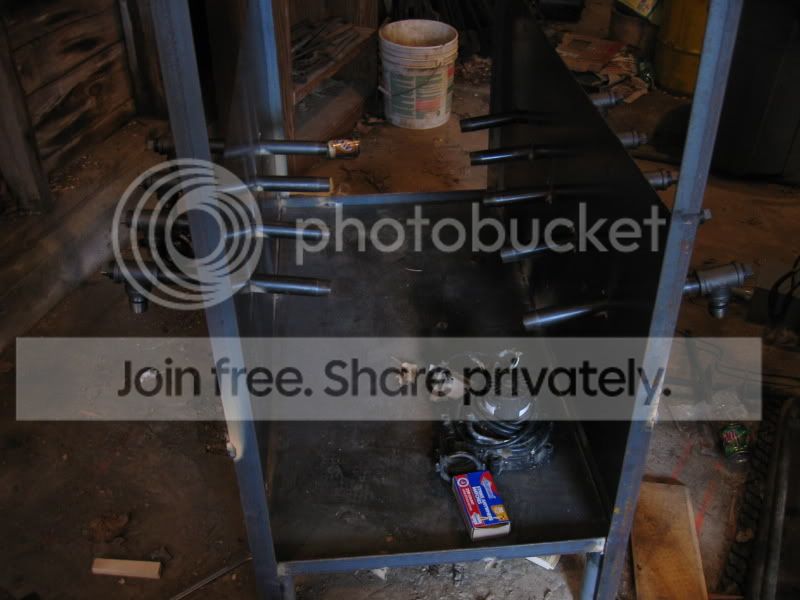

I've been making the switch back to charcoal so I needed a new retort. Blah blah blah, here's Betsey! A 275 gallon fuel oil tank and scrap metal. :D
With the gas tubes and door attached, I'm getting more mig wire today so updates are to come soon.
I hope this helps anybody who wants to build their own. Based on my math I should be able to get 200 to 250 pounds of pine charcoal per run depending on how much doesn't completely char.
-Dan

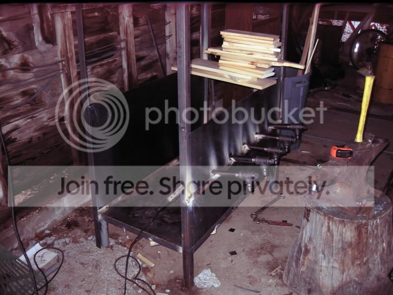

Well I finished welding the tubes on and I am going to cut them to size and weld the main burner tube down the center today. I'm gonna wait to run it until I have the outside walls up.

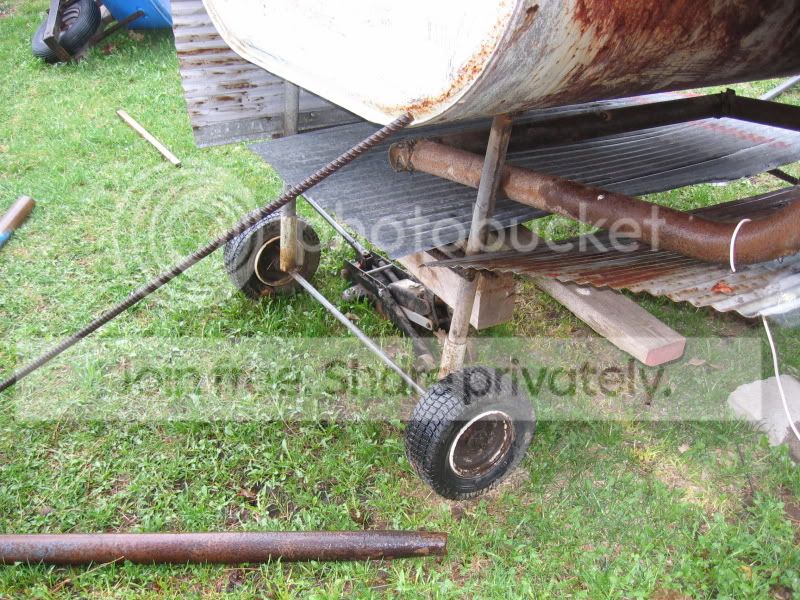

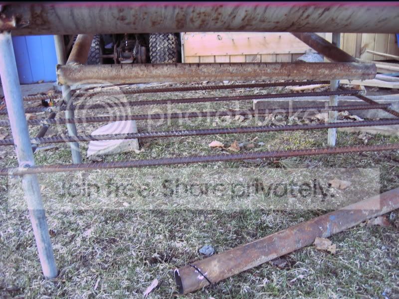

I have the burner hooked up, I'm gonna make the wheels, handles, and outside tonight and tommorrow.
I'm cheap so I'm using old steel roofing as the outside with a rebar frame.

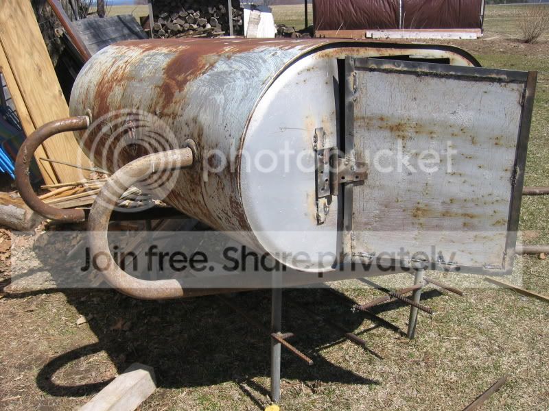

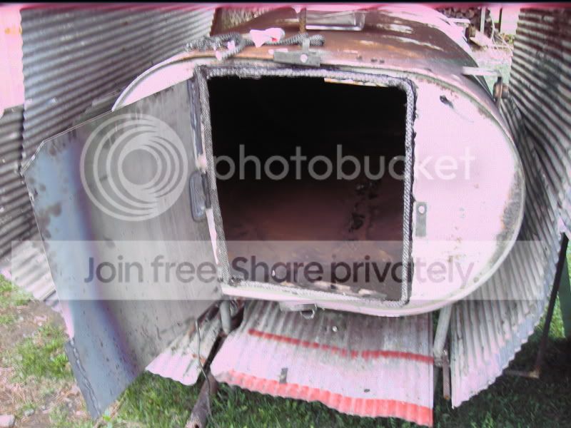

I've had mono for a while so I haven't been doing too much work. I got a bit more done though and am picking up the new door steel tomorrow. I'm gonna use a fireplace gasket and clay to provide a tight seal.
The super fancy removable wheels.

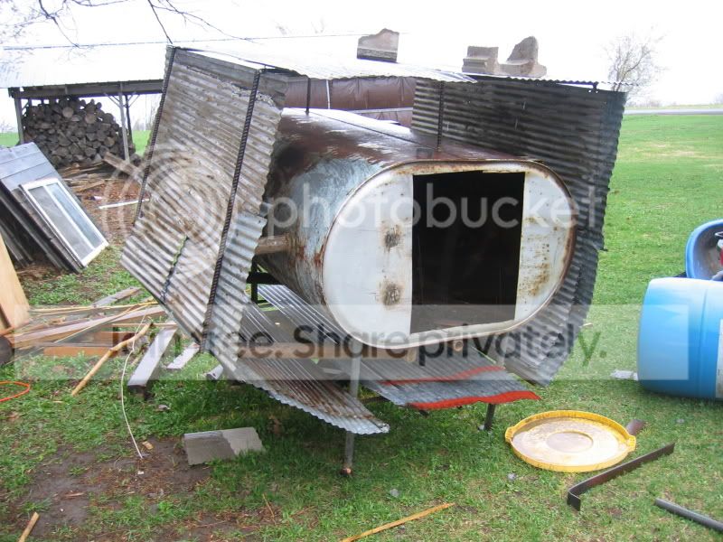

Well Betsey is almost ready to run. Just need to finish the front and back and then adjust the burner tube.

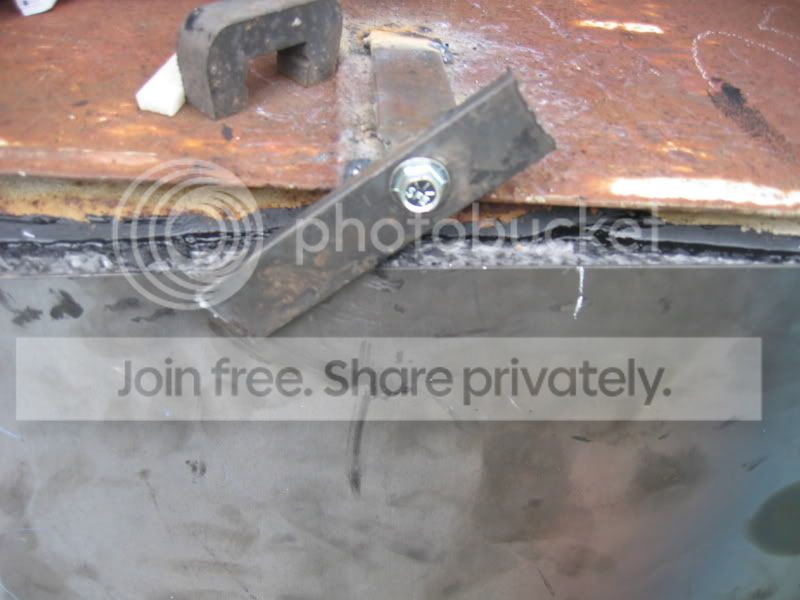

The new door with the gasket.
The super fancy locking mechanism. There are 3 so far and 3 should be plenty cause they fit tight.

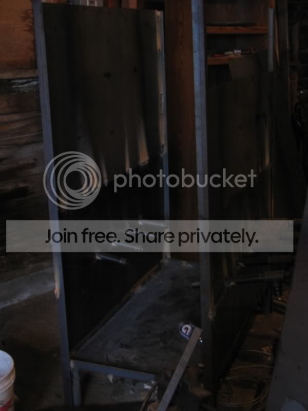

The tatara/forge; I'm missing a piece of steel for the front door still so I'm gonna have to make the piece.

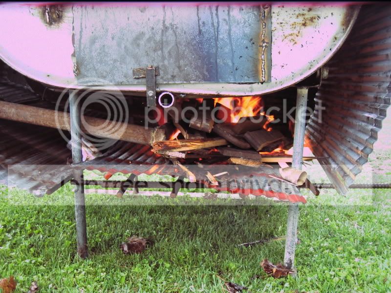

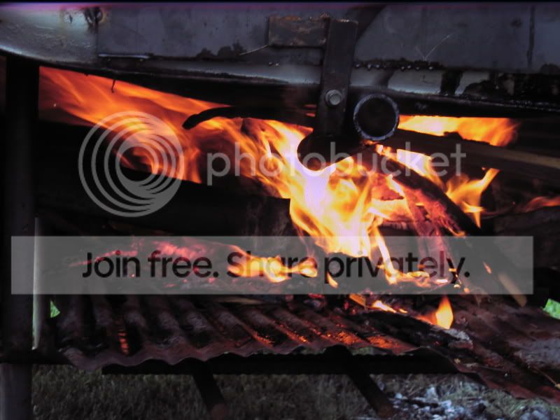

I did a test run today with about 1/4 the wood needed to fill it. I used small logs and larger logs split in half, so if I get 50% charcoal I know it will work just fine when I properly prep the wood. I'll find out tomorrow.
Just starting
A little while in.
Yup more fire.
Correct Sam. The fire under the tank distills the wood in the tank producing water vapor, tar, and then methane and propane. The methane and propane are vented via the burner tube making the fire much more efficient and self sustaining when done properly. Small dry wood works MUCH better than logs so I'm gonna be splitting pine logs and maybe collecting construction scrap.
