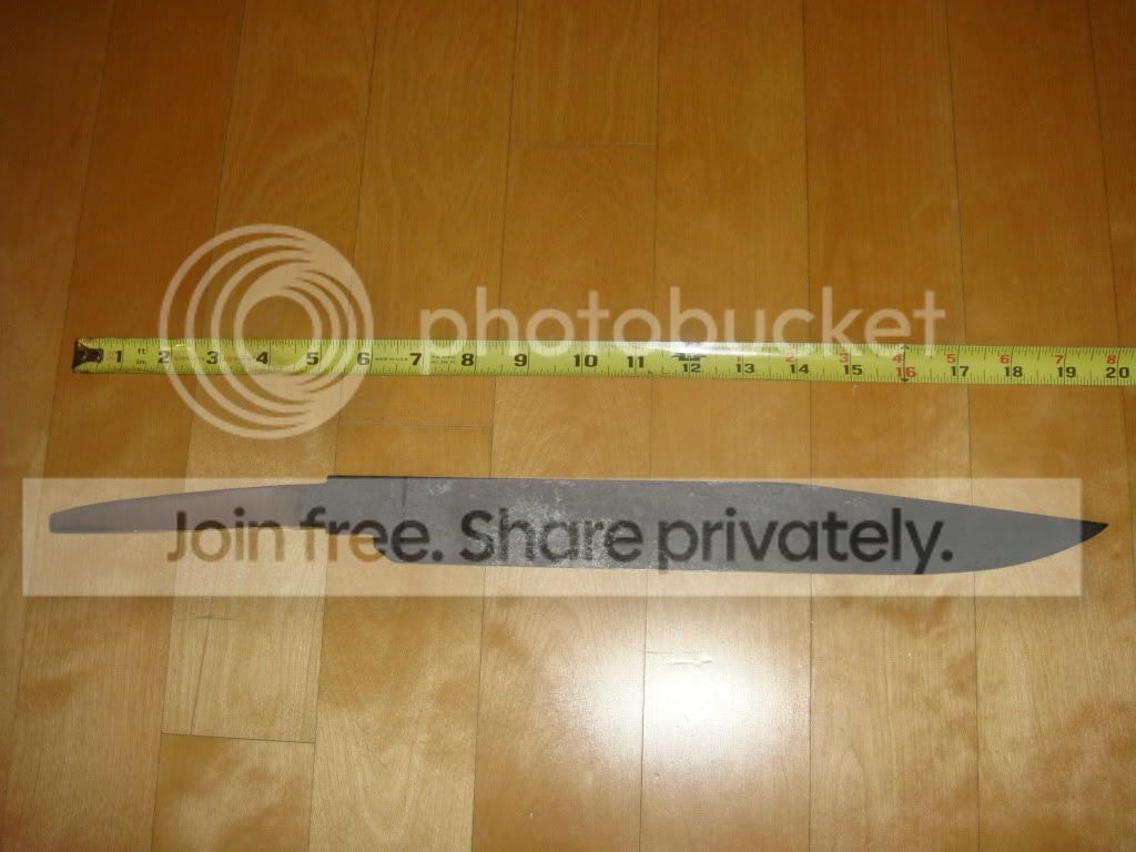

Here it is, forged and profiled.
Here it is after a vinegar soak to remove the scale. It's still dark, but thats a vinegar etch. About 99% of the scale came off in 24 hours.

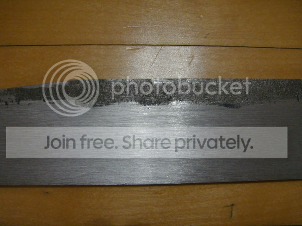

I finally settled on "push filing," or whatever the exact opposite of draw filing is. It is like using a Japanese sen, and with the double cut mill bastard it is really hogging off the metal. It also ends right at the plunge line, defining it a bit more with each stroke.

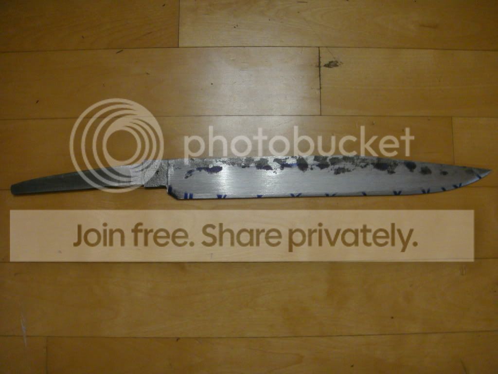

Here is a photo of the side that is "done." I put done in quotation marks, because I still have a medium and fine double cut, as well as a single cut file to work through. After that it is stones and paper, likely beginning at about 150 grit. But I do have the pre-heat treat geometry pretty good for the grit and stage it's at.

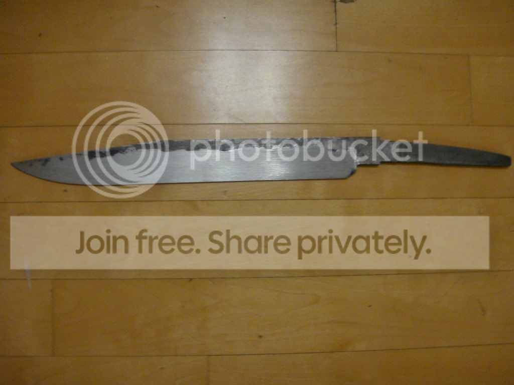

And here is the other side, which is still not even "done" with the roughest file.

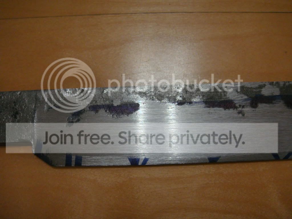

You can sort of see from the ink and scale what I am attempting to do. I filed in the edge thickness/geometry first. Now I am "push filing" in the primary bevel. I will keep working, expanding the clear section in the middle until the ink on the edge and the pits/low spots nearer the spine are gone. Of course, like the other side, I plan to leave about a half inch of "character" along the spine. It worked on the first side, so my fingers are crossed for similar results on this side.
Oh, yeah, the edge is down to about 0.050. It may get a bit thinner. Without a grinder, I am looking to get all the "grinding" pretty much done before heat treat.
