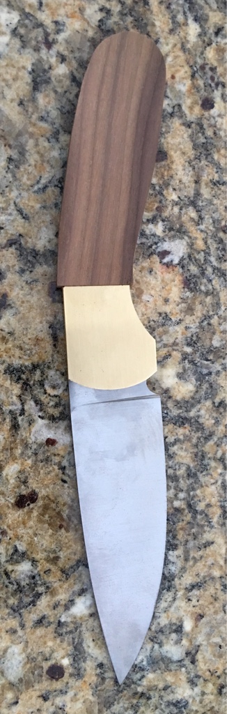

1084 .125" stock, full flat grind. Soft plunge lines. Brass bolster with walnut scales and will use .125" brass pins.
So I'm ready to drill the holes next and then on to heat treat etc etc.
Question is I see often people drilling multiple holes in the handle to alter the balance and aid in glue up. How does one go about it to determine the size and number of holes? Is it just trial and error?
The heavier the handle material the more holes I drill. Bring that you have a bolster I would drill 4-5 1/4" holes. Maybe only 3 as non stabilized walnut is not real heavy. Drill 3 and feel it. If it needs more then drill more. Looks good so far.
Thanks, I'll start with that then.
The way I think of it is like such. If you do a full flat grind your removing just about half of the weight from the blade. This means if the blade blank was balanced befor grinding the edge bevels your going to need to remove half the steel from the tang. I do this 2 ways, I drill some holes in a line between my 2 pin holes. Keep the holes away from the edge of the tang. Next if I need more weight dropped I dish out the center of the tang with a 2" wheel on my belt grinder and then taper the tang. This gets me about perfect. I like the balancing point right where my pointer finger sits so you just play with it. Generly speaking you can't lighten a tang to much practically, especaly considering the material we use for handles. Just ALLWAYS keep in mind the structural Integrity and as you remove steel your removing strength. I generally try and remove as much weight as I can if the blade length is at or under the length of the handle. Let me see if I have a pic of a lightened tang to show you.

As far away from the middle of blade you remove metal you have better balance . I would drill two-three more hole behind last pin hole. That place have not affect on structural integrity .......
Just a design comment:
The radically curved front of the bolster does not match the plunge or rest of the knife. It creates such a contrast that it draws your eye away from the other more important features. I would make it curve up from the choil as it is now, and go straight up to the spine ( no top curve). That way you get a curve in it, but it still end up parallel to the plunge and at 90° to the spine.
I was a little skeptical of that. Wasn't sure if it should be flat or curved. I think your right and flat might look better. Thanks.
