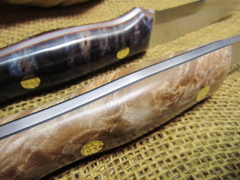

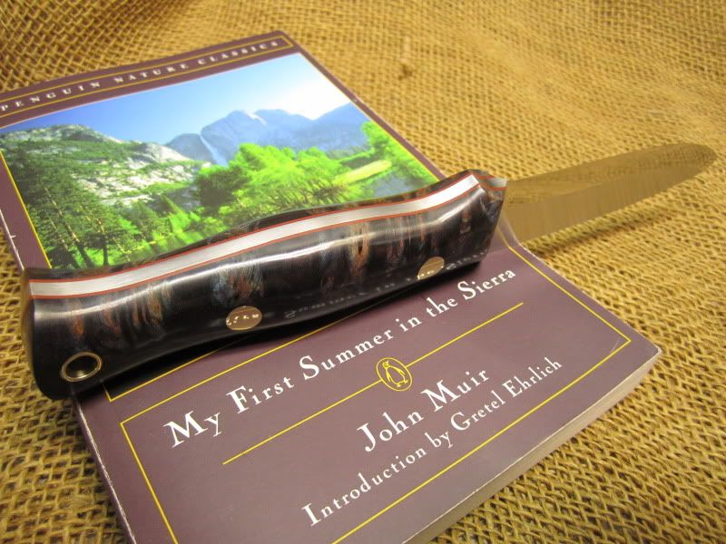

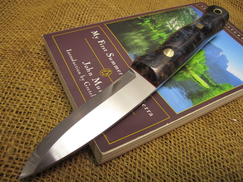

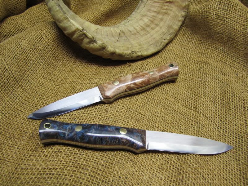

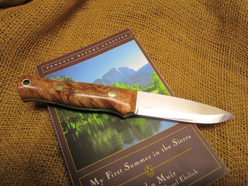

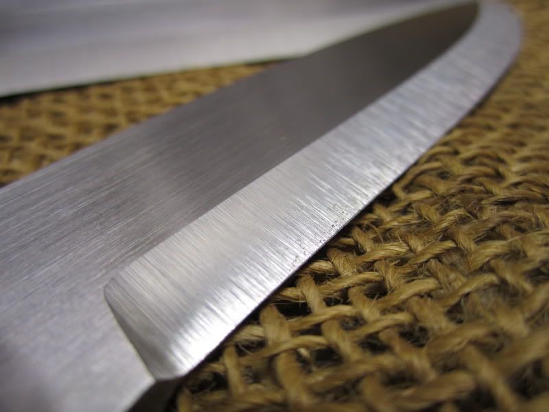

Got some Work In Progress shots for you guys. Haven't done this before but I decided to take some pictures this time as I went along. Not a ton of them, but check it out.

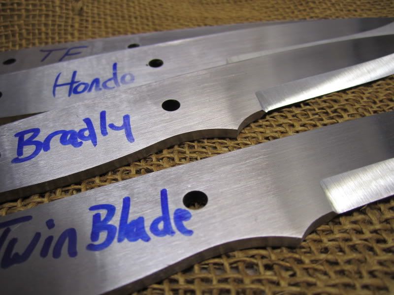

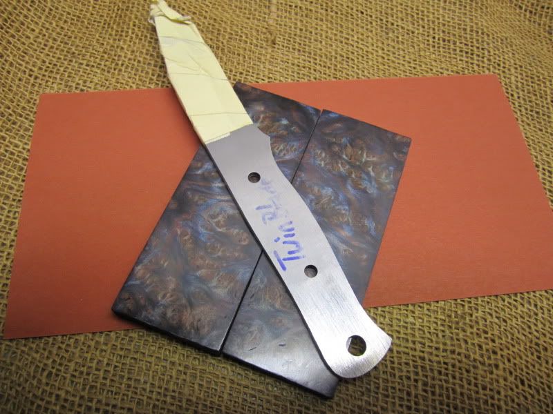

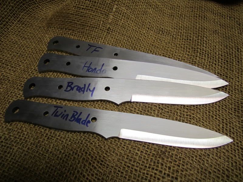

All are WL clones. The basic blanks ground out. Yeah I know I'm a geek, these are the forum member's usernames written on the blanks. It helps me remember. :cool:

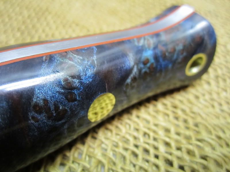

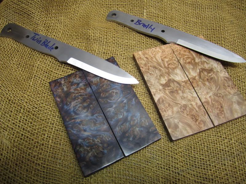

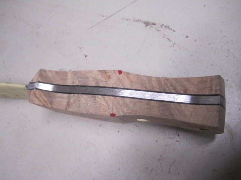

Dyed redwood burl, and natural maple burl. Both are stabilized.

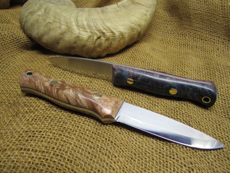

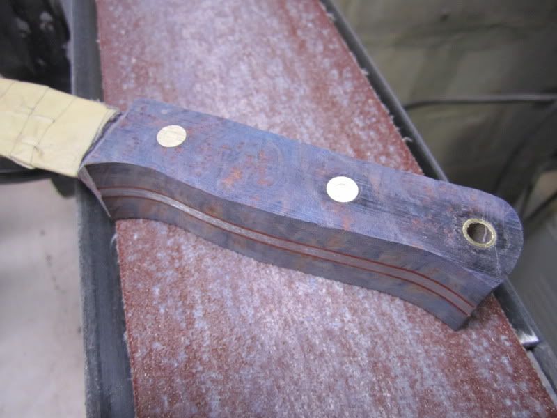

Scales fixed on with the epoxy & loveless bolts. Ready to take some form.

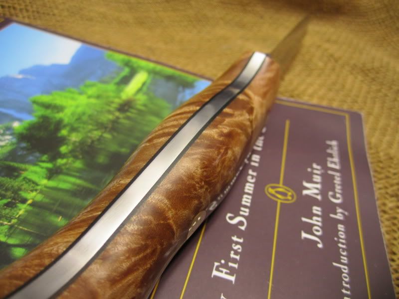

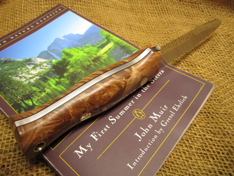

I mark where the palm-swell would be most comfortable on the knife and aim for that. Worked out great in these cases. The coke-bottle shaped base is finished here. Time for the contouring.

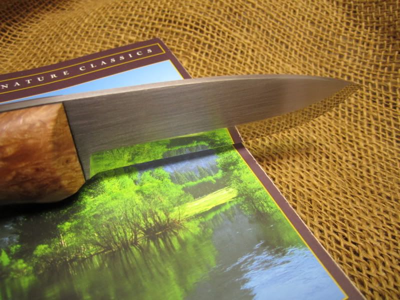

I get as close as I can the belt sander. I got to this phase by using only the belt sander and going down the grits on the belt until quite fine. But no need to get excited, I have a ton of work to do by hand yet.
After a bunch of hand-sanding, the hands of course pay the price...
...but I like to think it's worth it. ;)

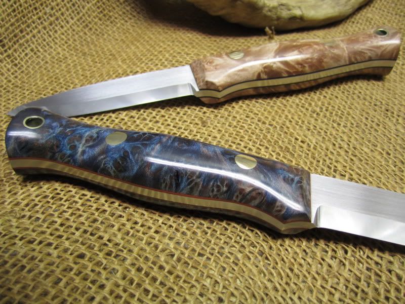

Now all I have to do is put on the maker's mark, and finish up the sheaths with Amber.
Two more coming later on this week; Hondo and TF, you're up.
Thanks for looking guys, keep your eyes peeled for more WIP in the future.

Those are awesome. Where do you get your stabilized wood? What do you do to get the contour of the handle (the indent in the back that gives the "neck" of the "coke" bottle)?

I do all of the contouring on a 4x36 belt sander (and a little bit of an oscillating spindle sander) before taking it to hand-sanding. On the belt sander I first ramp the scales from the back to the front. Then I find where the palm swell should be, and simply create the start of the dip behind that, using the wheel of the belt sander. It takes a while slowly sanding away & creating the dip (and making it symmetrical) but after you do it a lot it becomes second nature.
