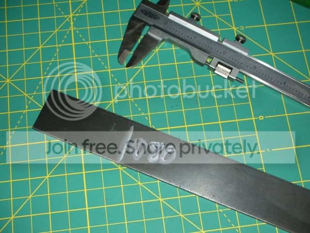

The steel I get from Gene is 11" x 1.3" x 0.130" 1080. Really a perfect size.

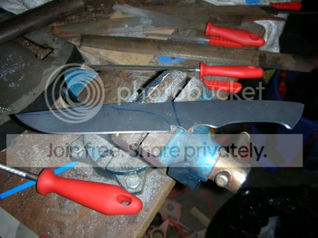

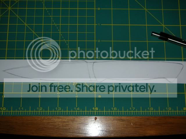

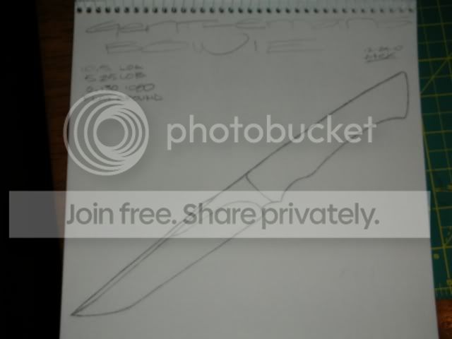

I pick a design from my sketch book that I think will fit within the steel, utilizing as much as I can. This is what I started with.
Well being indecisive at times, that design got altered, thinned, stretched, and just plain morphed into this. A Gentleman's Bowie.

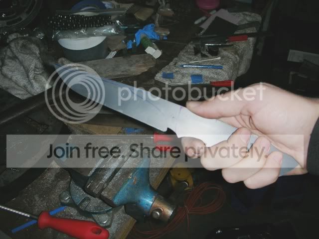

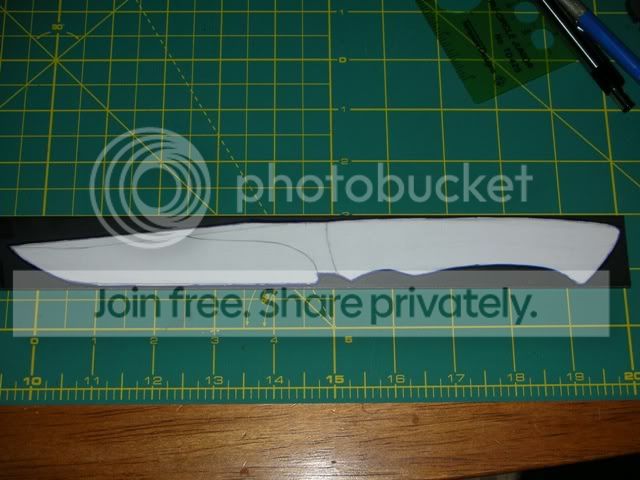

So I copy it to some heavier stock and cut it out to check out how it will feel. I liked it. So I refine the dimensions to 10.5" LOA, 5.25" LOB. I use 3M photo mount spray adhesive to hold the template to the steel, so I can remove it without destroying my template.

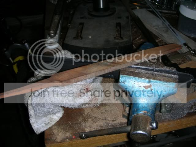

I break out the ODB and start in on the section close to the edges of the steel. This thing eats metal like Cookie Monster eats chocolate chip cookies.
NOTE TO SELF: stock up on cut-off disks for the angle grinder. The blades I had were new, but lasted only a few strokes.:thumbdn:

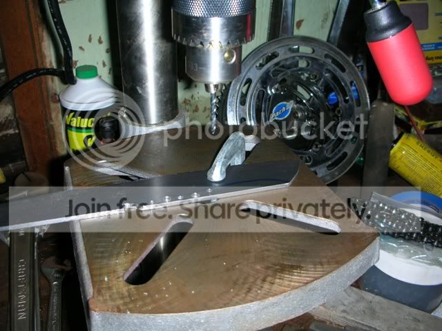

So I switch over to drilling holes and playing connect-the-dots with cutoff disks in the dremel. It was better than cursing at that damn hack saw!
Well I made it! I got it cut out! This is as far as I made it tonight before the wife came home from dinner with the girls. Perfect place to stop. All edges are squared up, and finished at this point to 120. I drew on my grind lines and where the front of the scales will be just so it could look like a knife.

Looks great so far! impressive form and flow for your first knife. It really shows you've done your research and lots of drawing.

that looks like a good beginning. Be really careful if you go with cutoff discs, they tend to become shrapnel if you try any sort of lateral pressure. If you are going to use files to shape, buy Sears "Craftsman" files. They are not the best files, but Sears will replace them when they get dull, and you will go through several in the process of making the knife.
-Page
What type of hack saw blades are you using?
I spend a little more and get the bimetal ones. They seem to work better for me.
Try upgrading your hacksaw frame to one of the high tension ones. The hacksaw in the picture is good for light stuff, I have one of those and it doesn't hack it when it comes to cutting out knives (01 tool steel). Using a high tension hacksaw makes a world of difference. The high tension frame keeps the blade from flexing too much and yu can apply much more pressure on the cutting stroke.
I tried a jigsaw with a metal cutting blade, but I got impatient and ran it too fast and over heated the blade. So I just take my time and use the hacksaw.
Might try a Sawzall sometime. The demolition blades will go through nails and other junk without a problem.
Nice looking design.
Ric
Great design! It has a really nice flow to it and it's looking good so far:thumbup:
Keep the pics coming.
Let me echo what so many have said, you have a very nice fluid design. Do you use any drawing aids like maybe a french curve?

Paul, I do sometimes use french and flexible curves but mostly when I am drawing symmetrical patterns, daggers and such. I was the last class in my high school to be taught mechanical drafting with pencil and paper and love to draw other things as well, so I have a fairly well trained arm. All drawing comes from your arm, your hand just holds the pencil.
One of my favorite ways to play with design is to close my eyes and just make a few different marks. I open my eyes and look at what I drew, if it resembles something I fill it out and complete the drawing. For knives I make sweeping lines and see where i could use it in a knife. Sometimes The line just becomes the center line of a design.
Ric, I have been meaning to get a high tension saw frame, but I had some time to get out in the garage, and wasn't going to let it go. If a jigsaw didn't work then a sawzall will be exponentially worse. longer stroke and it will tear up the part of the steel you want to keep. A 4" angle grinder, if you know how to handle it properly, it the farthest I would go from proper equipment. I am a foreclosure contractor and use the above tools on a daily basis, so I am well aware of dangers each one presents.

Keep an eye out for a used portable bandsaw in pawnshops and on craigslist. Build a frame for it from angle iron or 2x4 lumber and you will be able to cut your steel with ease without spending much money. And whether you use a hacksaw or bandsaw the bi-metal blades are money well spent. You definitely have an eye for design. Welcome to the addiction of klnifemaking.
