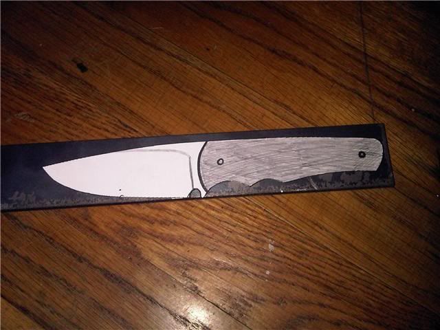

Template I decided to go with, done in MSPaint.

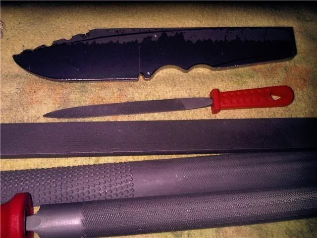

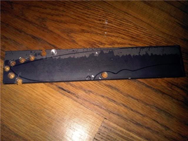

The very very rough beginnings of the cut out...

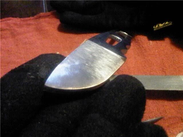

And after about 3 hours of on and off filing in front of the tv, got a little shaping coming in.
I don't have any images of something fantastic like a ton of the beautiful work I am seeing on this site, but I definitly enjoyed the file work. I am in no rush and it gives me something to do in doors while the cold is setting in.

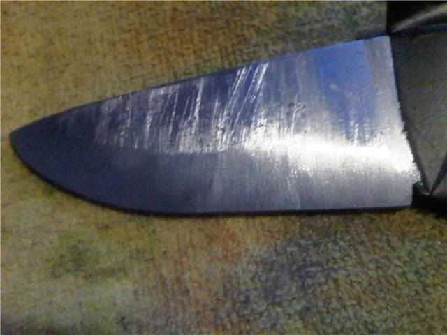

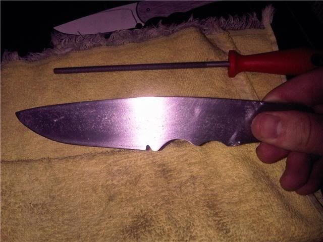

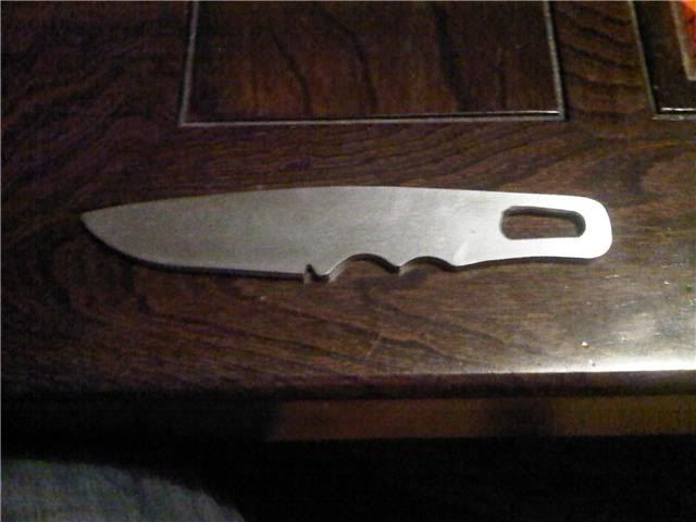

Night number 2:
Went mad with the fileing tonight. Think I have the shape where I want it though. This is after a quick rough sand because I wanted it to shine a little bit.

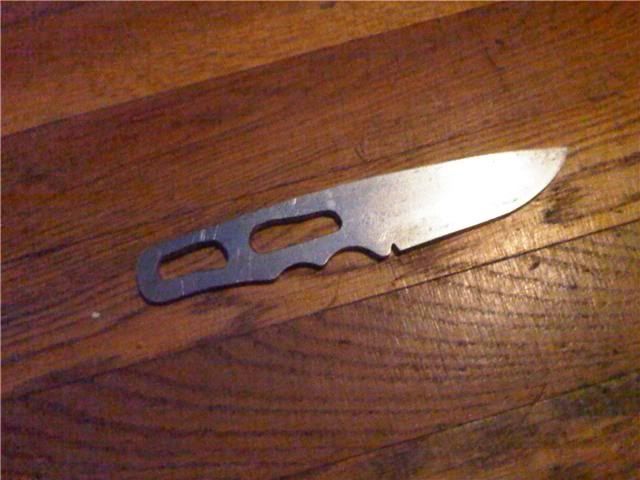

Now what I have learned is that 3/16 steel is heavy... I decided to go with a pinless handle so instead of just drilling holes to lighten it up I am going to be cutting out pockets. Again with my rudimentary tools this first one took about an hour to file out to where it is

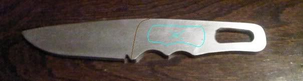

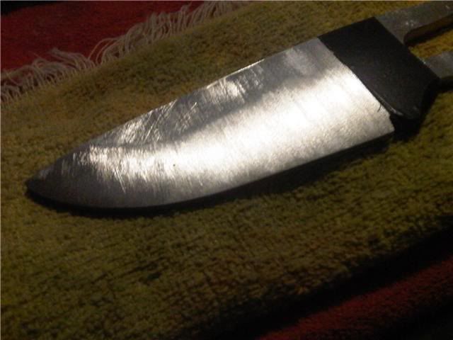

Another quick edit:
This is where I decided to go with the handle line, and also an outline of the other cut out section for lightening the weight.
