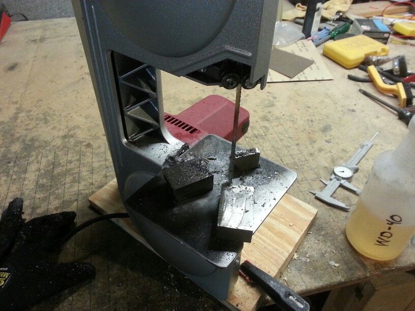

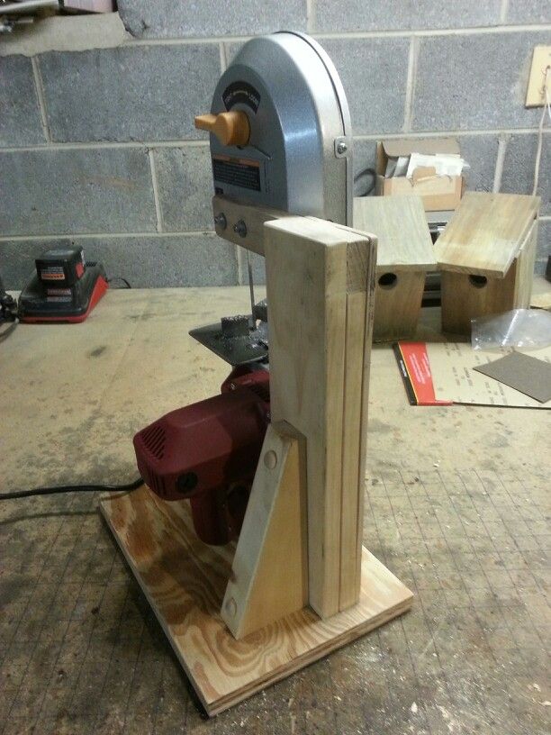

Well, not much of an update, but I was able to cut some guard material to size. Instead of just being able to cut away for the past couple of days, instead I had to go and buy a new bandsaw. And then make a new stand.
I had a Dewalt porta-band that I had honestly just strapped to a craftsman work table. It used to work OK... but not really ideal. Therefore I had a tendency to use my angle grinder more than the bandsaw. So... I got a HF saw and built a mount. A real solid mount setup changes things dramatically. As does a larger work table. I think I will be using the bandsaw much more often now. Something I have sworn I was going to do anyway...
But, here is the material I was able to cut to size and the new bandsaw.
And the back of the mount...
I am clamping it down ATM but eventually will bolt it down somewhere... Man what a difference. I didn't really ever take the time to do this in the past as I didn't think it would make much difference. And I was planning on getting one of the vertical/horizontal jobs and just putting a seat on the frame. But for now, I am very pleased with this...
-Eric

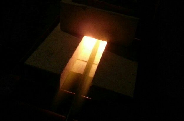

I'm having a weird problem since lining my forge with the Matricote 90... Obviously the forge is much more efficient and heats much more quickly, and the heat reflected is palpable. In so much as the round bar I use to weld my billets onto is getting screamingly hot. The 1" square peep hole used to blow out a little heat and the bar would get warm enough I had to use welding gloves to handle it... but now the stream of heat coming from that opening is like a blow torch. It is highly noticeable 4' from the opening.... Kevin Cashen (at least I think it was him) had pics up of a handle he made using threaded sections of rod and pipe that fit together and had a shield etc etc... Anyway, it looked like it would work well. I do use tongs a fair amount, but prefer the handle welded on for obvious reasons. My tong technique isn't what I would call a really strong skill for me... :)

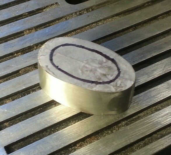

Here is the guard, cut from a stainless drop, squared on the disk, and ovalized. Template glued on to cut the step.

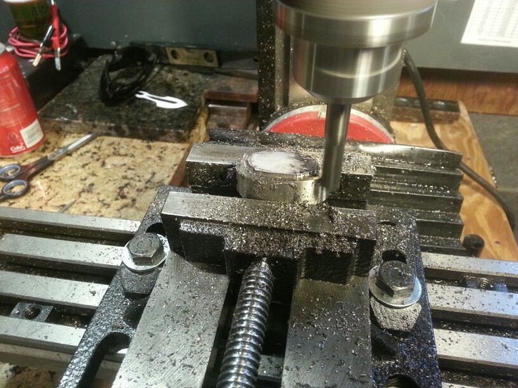

Used the mill drill to rough the step. Just trying to get uniform height on everything. Will finish it out by hand after everything is rough fit. I want the spine of the handle to match the spind of the blade as in the drawing. I've made a slightly undersize surrogate tang to use while rough fitting. Forgot to photo it...

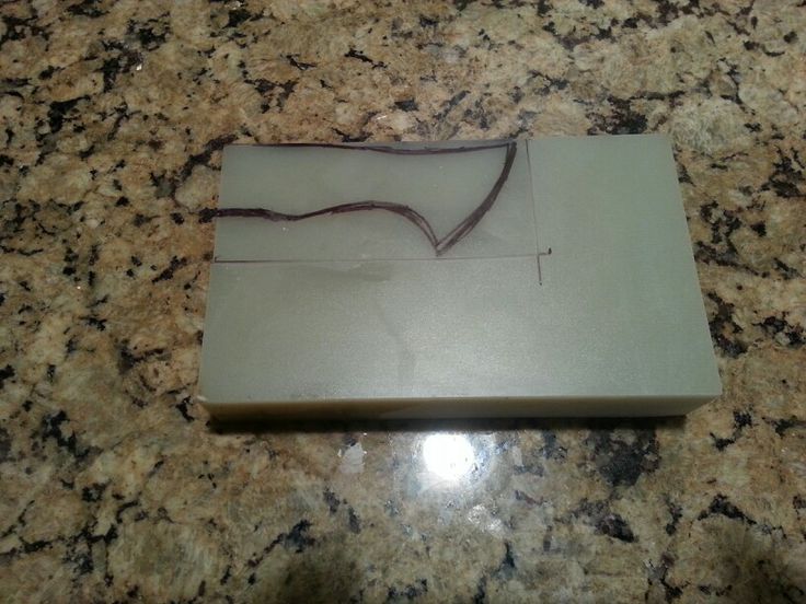

Here is the huge block of FR4/G10 traced and cut into a smaller blank.

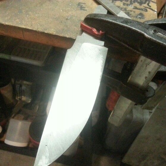

The blade is 90% ground bevel and plungewise. Swedge not done yet... But it's dead flat, straight, yadda yadda yadda...

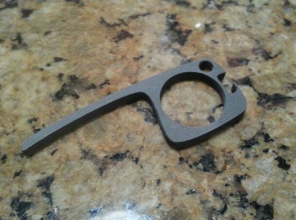

BTW here is one of the little knuckle duster bottle openers I did a run of. Nothing special, and honestly barely more than a break-even for me... but I like em. The idea was to look as little like any sort of weapon as possible, be light and compact, and useful. 1/4" aluminum, waterjet cut, media tumbled and acid etched. Gives it a raw titanium kinda color IMO. They sold out this time in about 72 hours. So I'll be doing another run soon for anyone interested. Any more and I'll have to switch to a manufacturer membership... lol.
