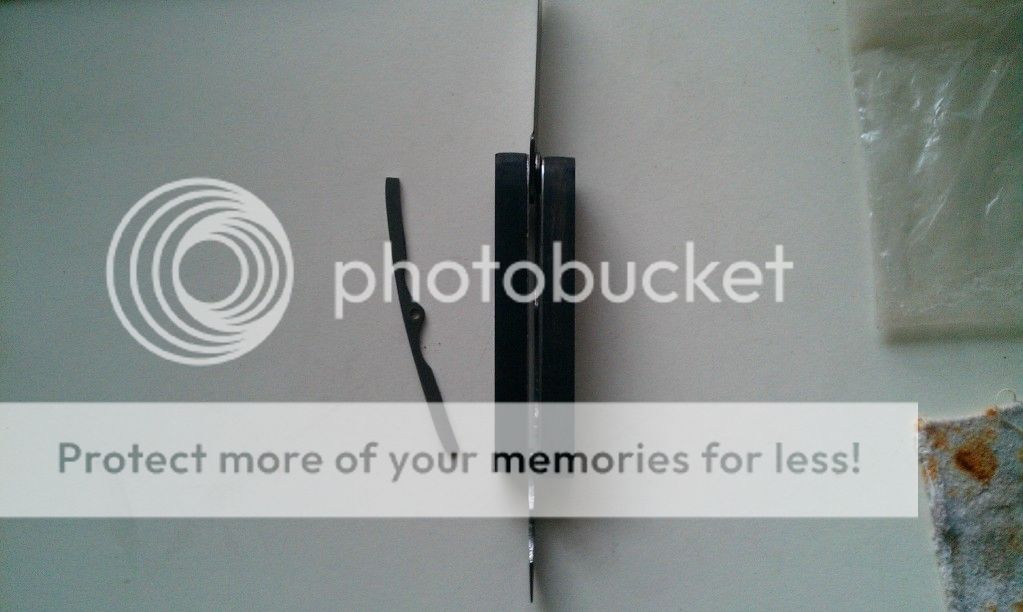

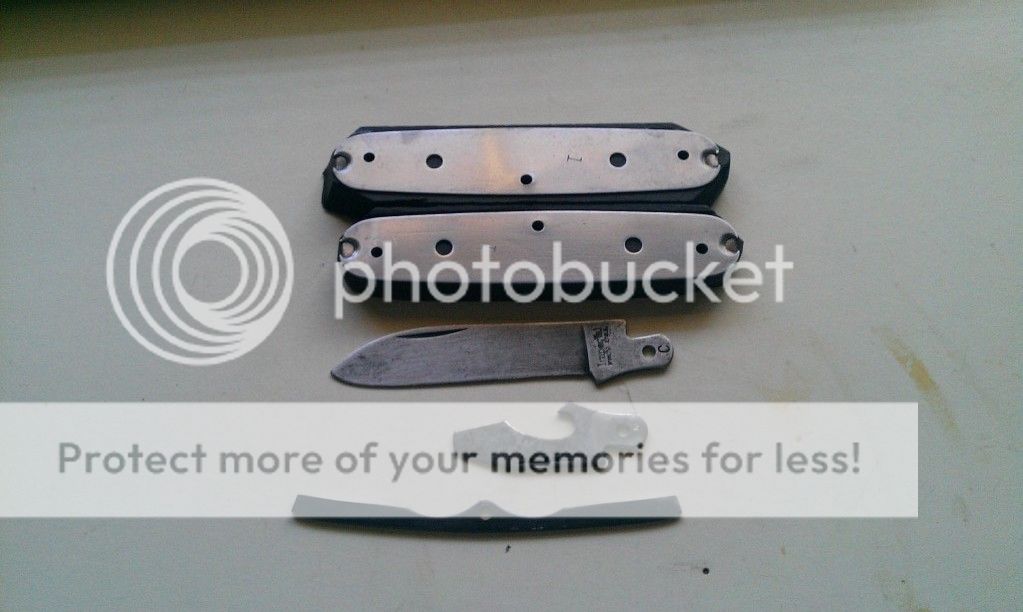

Not to long ago, I bought an old Kamp King from a fellow forumite. I was low on projects so I thought "hey this'll be a good experience." (On a side note, I could also use a new name for this knife, half-camper is more or less a stand-in)
Here it is from the sales thread (it's #9) Not the prettiest thing, but hopefully it will give a few more decades of good service.

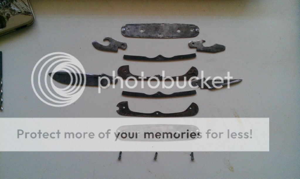

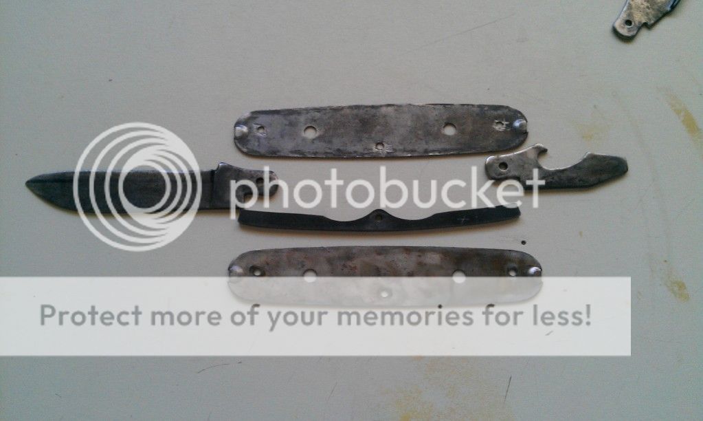

Here it is, taken apart. So far the plan is to scrap the faux scales, reground can opener and awl, so just the Spearpoint and bottle opener/flat head. Also don’t know why it has two dividers, one of which was right next to a steel liner.
The intended bits:

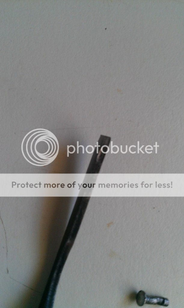

The spring for the blade and can opener seems to be worn down a good bit, to form a channel or worm like grooves. I guess the tempering in the spring is a tad soft for the blade. The other seems to be in much better condition, the pin in the corner is also where the blade was, quite worn down and deformed.
So We’ll see how it turns out, I plan on making some pine templates for the scales, then probably use the Gaboone Ebony that has been sitting on my desk for a good 6 months as the actual scales, probably in a shadow pattern as I don't want to deal with making bolsters just yet.
Any and All advice/criticism welcome

Will the blade clear the cap lifter?
Thankfully yes, the cant(not sure if that's the right word) on both the blade and cap lifter were the same angle but different sides so it should mesh well. if not . . . . I'll figure something out lol

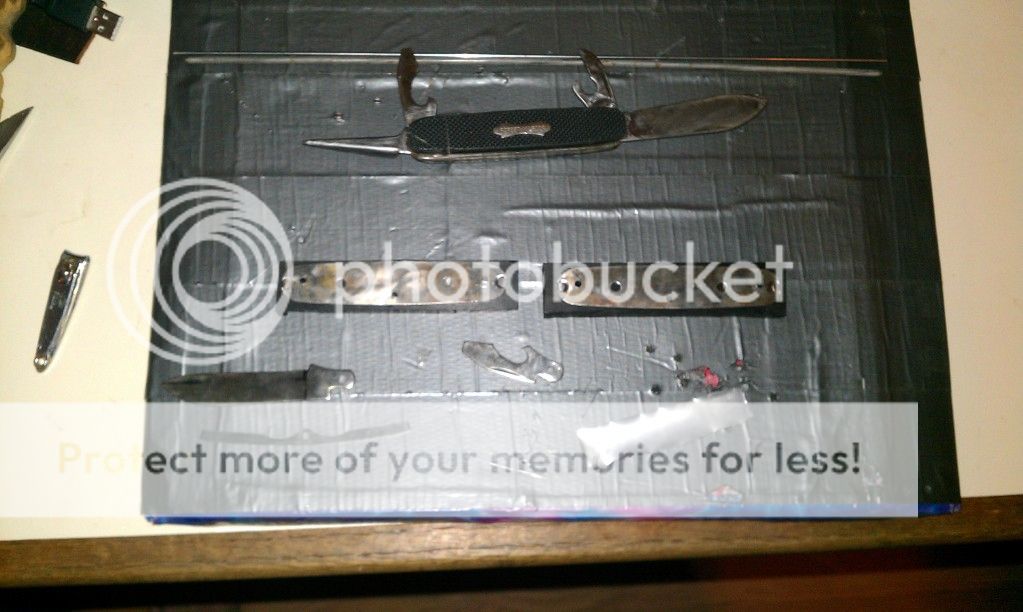

the Fruits of today's labor:
Ebony is cut and curing with epoxy to the steel liners, I have them covered with a small piece of paper and under one of my 2lb dive weights. The next one is an attempt at showing the figuring of the Gaboone Ebony, Photography is not my thing.
Edit: the steel in my pic looks a lot rustier then it actually is, though I'm sure a nice silicone bath wouldn't hurt . . . .

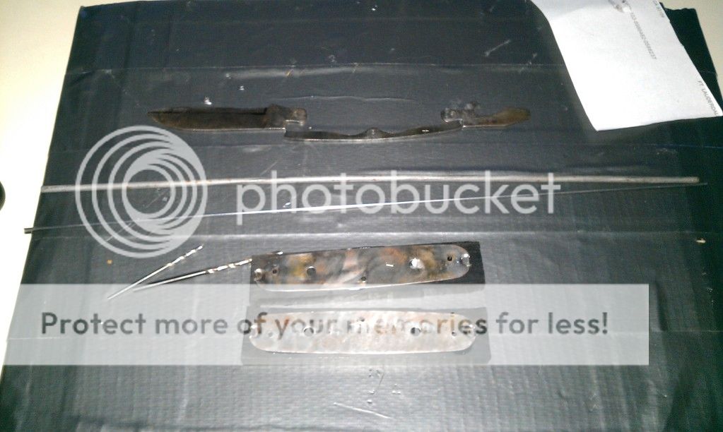

So, I ran into my first few problems today (as these projects always have) . First I had to figure out how to drill straight holes so the pins will align. Sadly this did not happen but I got it as straight as I could manage with a steady hand and an undersized drill bit.
Next, the wood chipped a little around the drill exits, but this isn't a huge deal as I realized the wood is in fact a 1/2" slab so some slimming will be in order, or a palm swell, now that would be interesting on a traditional.
And thirdly, resizing the holes. the original pins and holes were around 2mm or a .079in something that no one seems to carry in pin stock, so I resized it to a 1/8" not a biggie, maybe a little more time peening but hey it'll be a new experience and isnt that what life is about?
Finally, the last problem so far is drilling the cap lifter, the steel liners, spring and blade took all of 5 min drilling and reeming with a dremel carbide bit, but that cap lifter does not like change.
I'm also considering modifying the blade into a full fledged wharncliff. There just isn't that much belly in the blade so once all said and done its just going to be a slightly recurved wharnie with a nubbed tip.

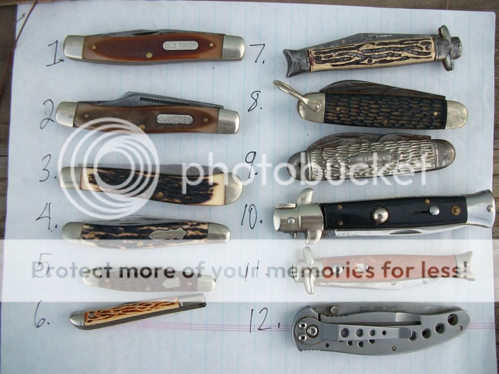

I'm intrigued by your project. I hope you don't mind me posting this knife. I thought it may be of interest.
No worries guys, I always love seeing other people's work.

Here are some updates, not too much has been done, still trying to finish drilling out the cap lifter and I decided everything needed a bit of a shine, currently working on shining up the liners. Stabilized wood is a serious pain to grind down I might add.
Well I've finally ground the Scales to size at least the main dimensions of the liners. Still need to trim it down in width as it will be around a 1 1/4" overall width, which is a tad over what I'd like. More drilling and reaming still needs to be done, man are those pieces stubborn.
I've decided to add the middle spacer to help compensate for the angle of the blade. The more I think about it, the more I worry it'll start clipping the steel liner, so "better safe the sorry" as they say.
To help eliminate some of the work I've been playing with the idea of a palm swell , might be interesting. any ideas on such?
