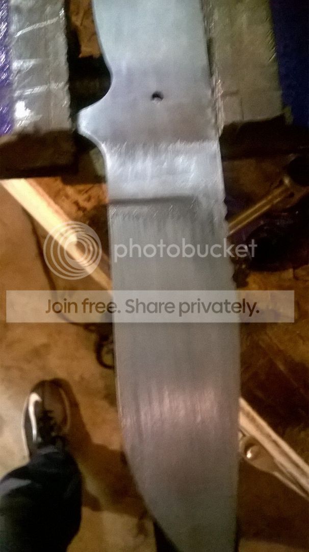

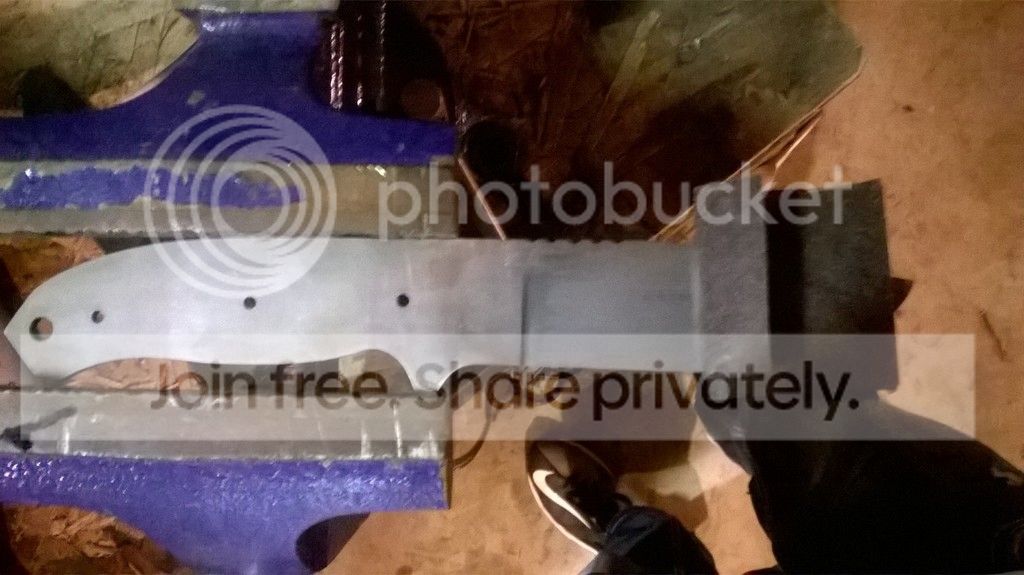

WIP.. looking for critique along the way with this one.
Jan 22, 2015
50
I started this one earlier today. I'm not finished grinding the bevel yet it will come maybe a quarter to a half in up farther then what it is now. I am also debating on if I should bring the plunge line back a little farther.
Profile looks good. How about tanking the grind all the way up? The plunge looks fine where it is.
agree with the grind, but disagree with the plunge... I don't think a plunge line looks good with a choil unless it intersects more toward the centre for flow in so much as just visual appeal but I'd take this one back a bit.
I'm no expert by any means but I think the ricasso. Area would greatly benefit from that choil being more even and moved up just a tad. Maybe until the plunge comes down about 3/16-1/4" into the choil. It would make sharpening easier! Also, I would make the radius where the index finger rests ( in the handle portion) a little bigger.... If that makes sense.
Don't forget to move your pin holes back if you do move the plunge. I think the plunge looks fine though.
I don't think the first radius is meant to be a choil which is why I say the plunge looks fine where it is. I think it's a finger groove when wrapping a finger over the guard. We'll let the OP clarify that.
I agree. It would be a huge choil!
Thanks for all the comments and suggestions. The radius after the guard is ment to be a finger grove. Which leads me to my next question. Would it be wise to bring the handle material all the way flush with this finger grove or should I leave it flush with the beginning of the finger guard? Again thanks for all the comments.

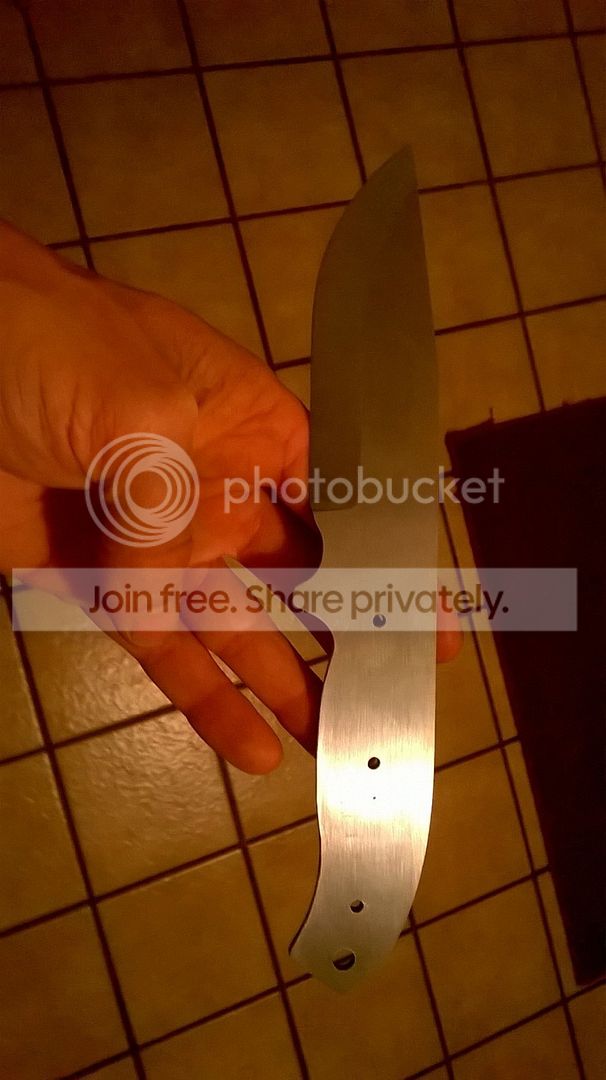

OK some progress was made this evening. I brought the bevel up and i am now hand sanding the blade. you'll notice that the finger notch is gone :mad: this is because while heat treating the blade had a weird warp in it and I tried to correct it and a piece of the blade got really messed up so rather then scraping the knife I ground it out which ended up making me have to get rid of the finger notch. I am still happy with how this one is turning out what is your opinion.
