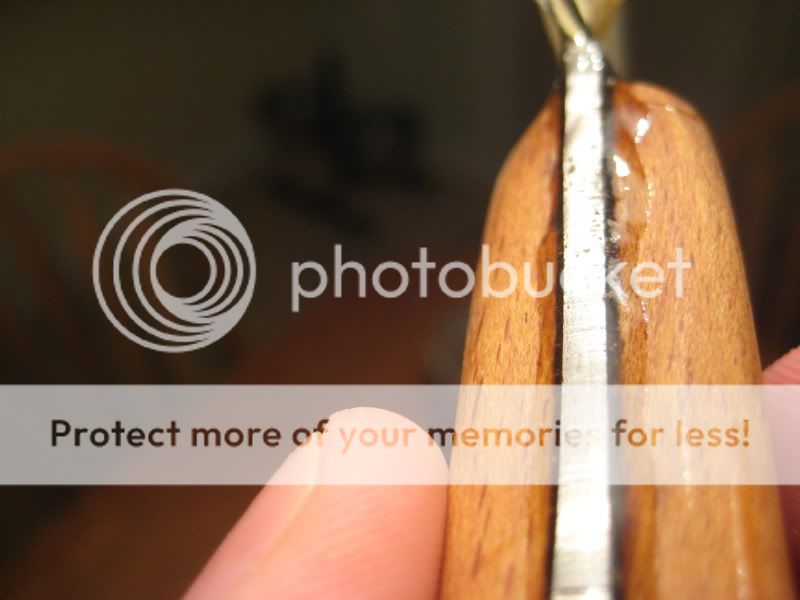

WIP - my very FIRST knife project - handle restore - feedback welcome

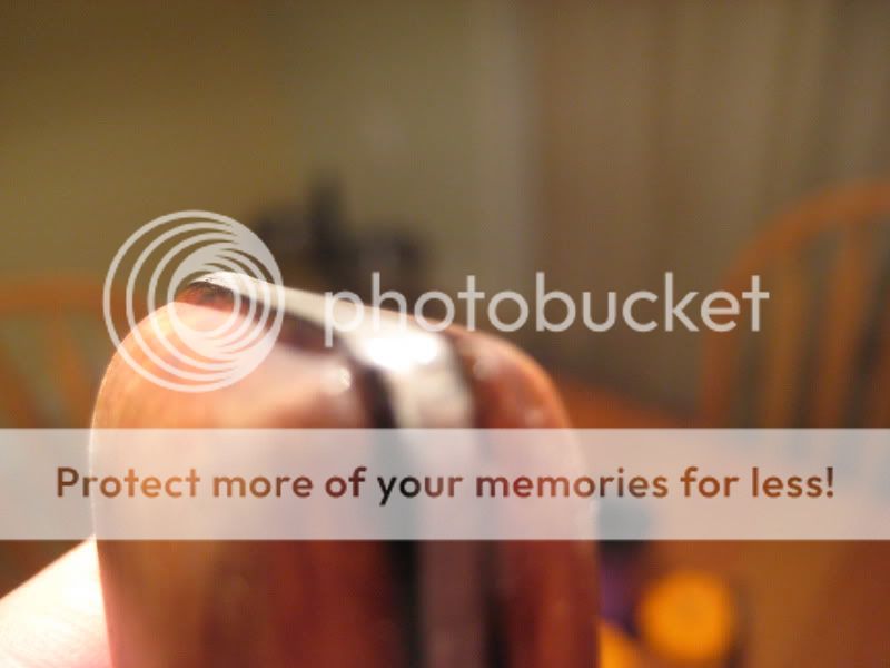

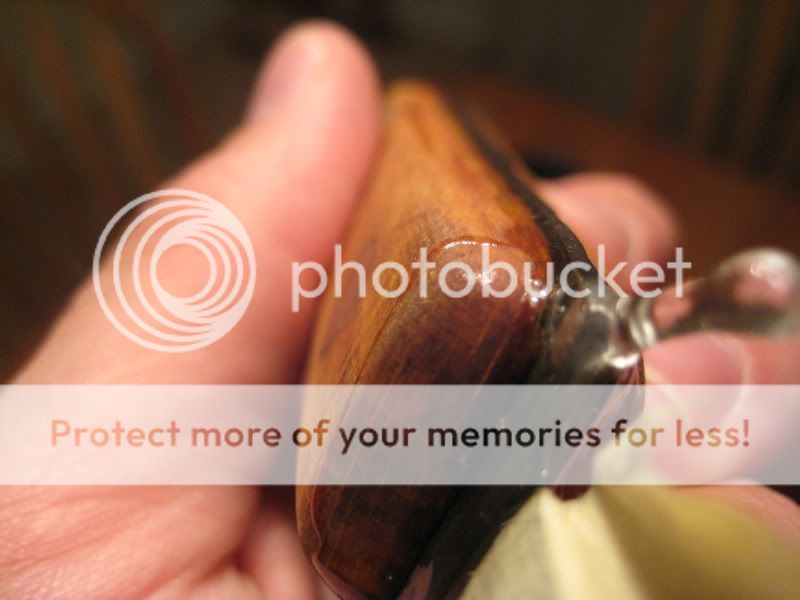

This little project took a back seat - but I messed with over the last couple of days and put some epoxy in the gaps and it filled in nicely.
Will sand paper work to smooth out the epoxy?
Trim the excess with shears or a sharp blade then sand clean.
Fine grit and leave a bit of a rise on the epoxy?
I'm actually pretty happy with it right now.
Next up - I need to decide how to finish the handle.
You need to file/sand the epoxy down on the edges, leaving epoxy only in the gaps. If you don't, that area will not finish like the rest of the handle.
