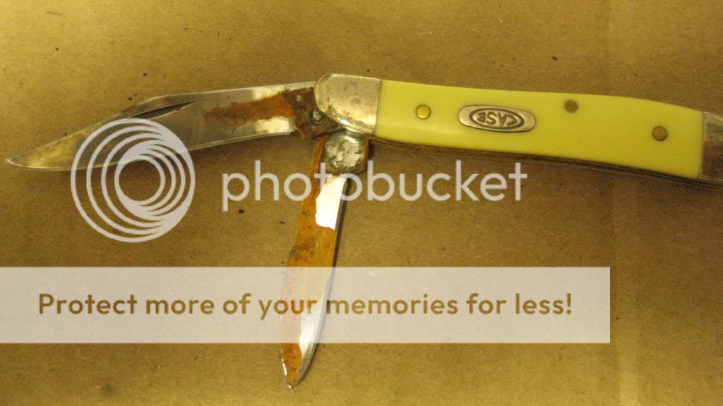

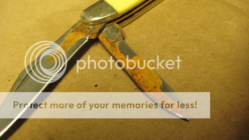

The knife I got back from Dad

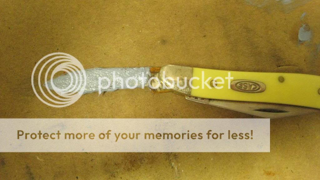

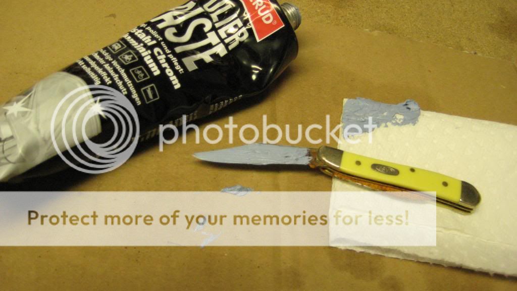

Looks bad,doesn´t it? I used some metal polish my wife uses for kitchen surfaces. It containes aluminium. I added it to the blades and let it on there for about quarter an hour.

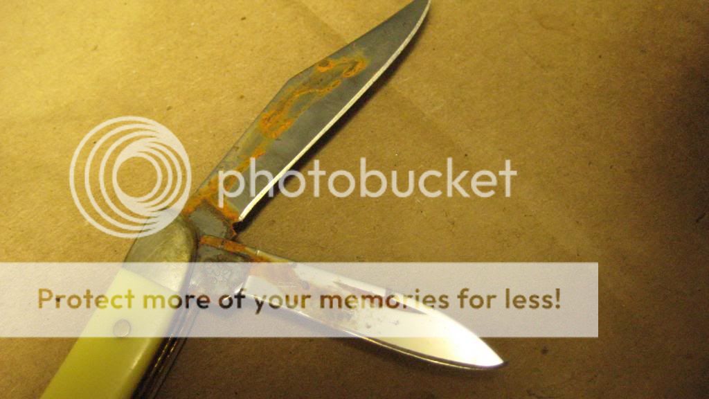

I had to clean it up with some sandpaper as well. The metal polish didn´t remove it all. The red stuff was only off while some of the patina was still on there. I used several grits of sandpaper on the blades, bolsters and inside the liners.
The metal polish usually removes the edge, so I had to resharpen it again. As well as polishing the bolsters and some steel wool procedure on the Delrin handles.

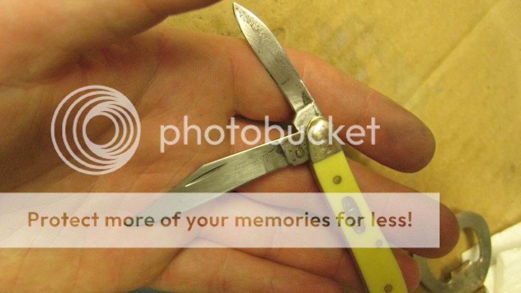

Here we are after sme polishing - and oiling, removing metal dust ... ;)
Some of the different spots seemed to be "eaten" into the blade and won´t propably never be able to get repaired, but I´m glad having this little fella back again ;)
