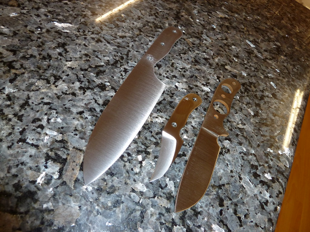

Full Convex grind Medium Large Santoku
Chisel Grind Pikal
BT4: Experimenting with a 36" Radius hollow grind. The hollow is very subtle and almost looks like a flat grind. It may be a good compromise to wring out a bit more efficient cutting geometry while still maintaining the strength of the flat grind.

The hollow grind on the BT4 really is subtle. One couldn't tell just from looking at the pic.
