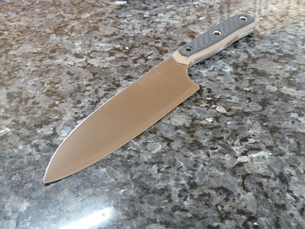

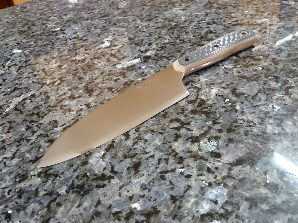

WIP Santoku, Pikal, and BT4 36" Radius Hollow
Tried out some carbon fiber on top of micarta today.
It has a very smooth feel to it. Feels like a smooth piece of charcoal ;)
