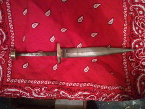

Here is one of my current WIPs. It is my interpretation of the WW2 era commando stiletto knives.
Started out from a large old Nicholson file that was in my Grandfathers old shop.
when i found this huge file, I instantaly thought about a commando knife.

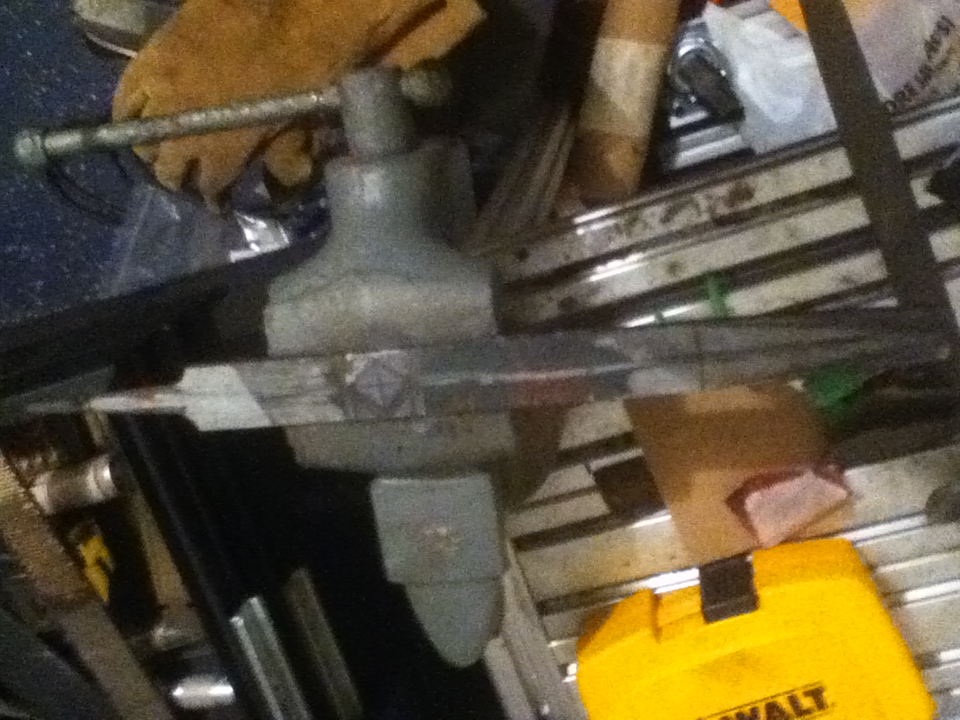

rough shape

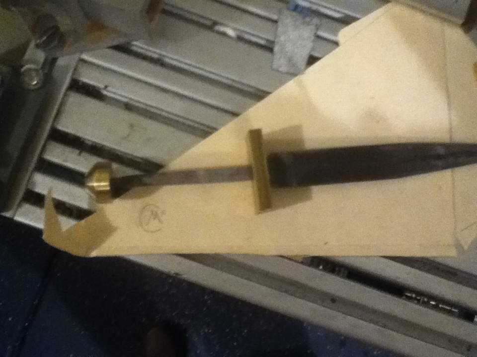

guard and pommel rough fitting.

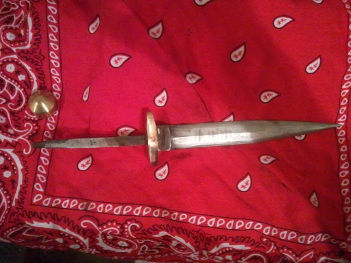

after grinding and heat treating
please offer comments and suggestions.
The guard is not a crooked as it looks in the pics. Although the next time i attempt a guard like this I think i will split the brass and pin it back together. That will allow a much tighter fit between guard and blade.
I shaped the hole in the guard with a drill press, dremel tool, and files.
What handle mat'l would you put in Mac?
Also did you leave the file marks for aesthetics?
@Jay,
I'm thinking about stacked leather for the handle. If that doesn't look right, I'll probably use some of the Walnut I have laying around.
Yes, I left the file marks for aesthetics.
@Bill,
What wonkieness that is there will be gone when it is finished.
