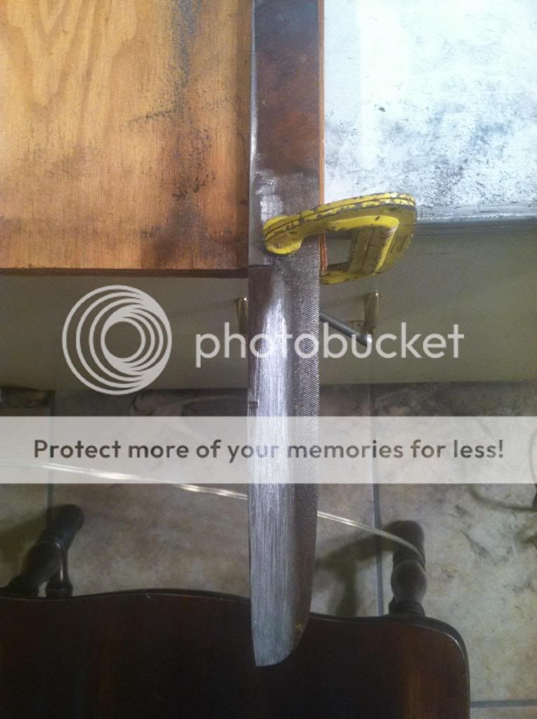

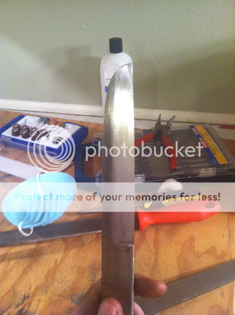

Started a Wharnie hunter from a Nicholson file. Research indicated it was most likely 1095 (fingers crossed). I annealed the file on the bottom of our woodstove and let it cool overnight in the embers. Very little warping, softened it right up.

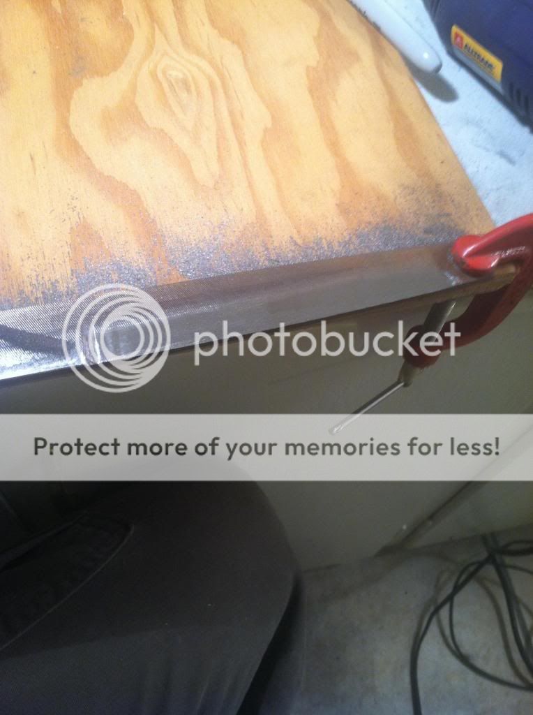

Bevel guide marks and rough filework started right side, ten minutes in.
Draw filing takes forever. 25 minutes in.

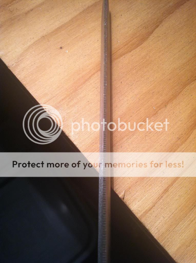

Re-applying sharpie. My process is as soon as the Sharpie is gone, I check the angle and re-apply it.

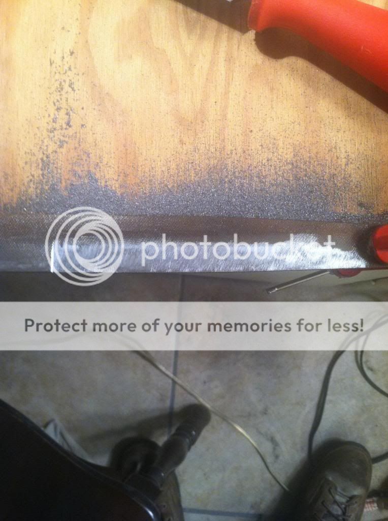

More Sharpie, draw filing from front, tip roughed out, will grind it to final shape later.

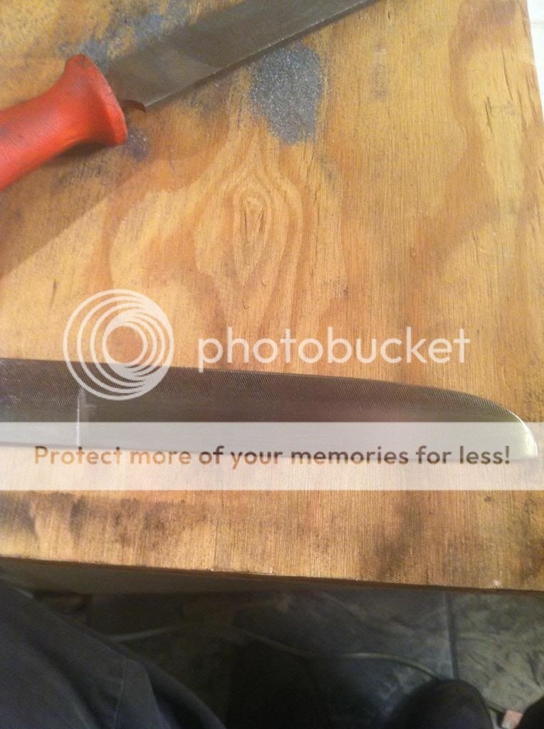

Final rough shaping done right side and tip. ready for 120 sandpaper.

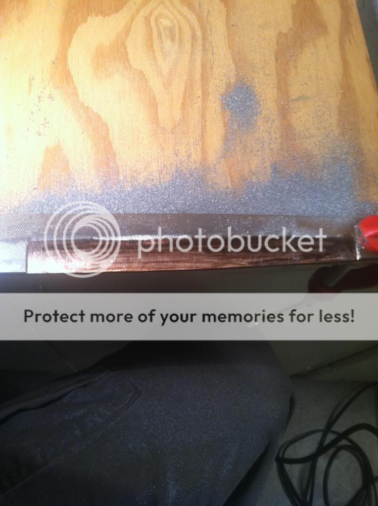

Deciding if I'm going to sand tonight.....
You can see how even careful draw filing leaves slightly uneven bevels. This is why I switch to sandpaper superglued to paint sticks and a block.
That's it for now. Will post updates on the sanding as it occurs, probably later today. Cheers, mates.

That looks like a lot of work!
It sure shows you something about how heat changes steel, filing on a file like that!
Voodoo guru. Hmmm, I like that. Although it reminds me of Tai Goo, which is both good and bad...
It is some work. I love making a knife completely by hand. My next WIP will be my 1080+ process. I have two hours into the file Wharnie so far.
Making a 1080+ with a 4" drop point takes about 6 hours actual hand work. Totally worth it though. Feel more attached, invested in a completely hand-made than I do a blank or machine-ground.
try a chain saw file to to get a nice, round ricassoline.
Looks like a lot of work. Don´t leave the edge to thick
