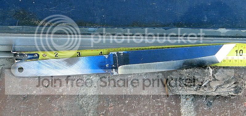

This one is for a friend who wanted one of my first knives:rolleyes: He is a customer of mine of other custom things I make so he wants one for his collection.
This is 3/16" 01. It has a 20* chisel grind and a tapered tang. The tang narrows to the rear and the corners have been removed to accomadate the wrap for the handle. There is a shoulder for the Turks Head guard to sit up against "ala Phill Hartsflield":D
It needs to get ready for heat treatment. Pohan Leu was kind enough to give me some tips on how to make a "Hartsfield Style sheath". If the sheath does not get made for this one then it is going to be made for my own personal knife that is on the To Do List.
Thanks for looking

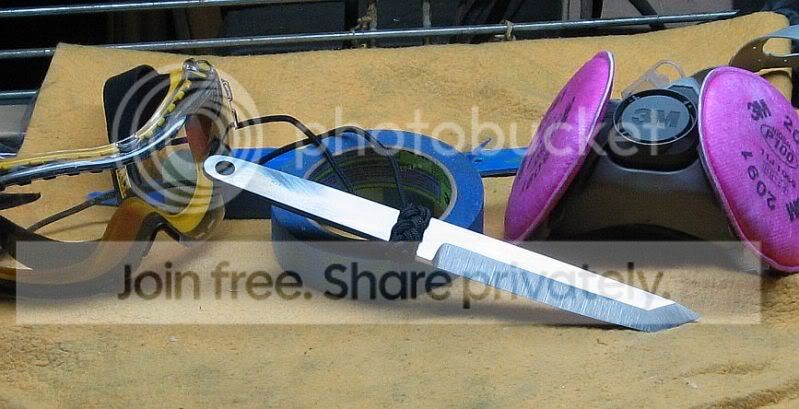

I am getting ready to get it wrap. Just gonna run a Gator 400 grit on the bevel. Making the Turks head is kinda a fun thing to learn after all these years. Now even my flashlite has a Turks Head :)

Good work and very clean grinds. I admire your ability to blend in the Plunge
Question for you: Would it be a lot harder to do a V grind, instead of a chisel grind Tanto? I think it would take a bit of math to figure out the perfect angle, so the both sides would match up in the height(primary bevel)

It is not "harder" to do a V grind. It just takes technique. You mark where you want the grind to end. Use the "Bubble Jig" with the clamp on the blade and you can set your angles and grind to the mark.
The nice thing about the bubble jig is it gets you started with equal grinds on both sides of the blade. One you have the grind angle established you just take it off and grind freehand. Since the angle is already established the blade will glide against the platen at the correct angle.
On my next Tanto I am going to try a double V grind with a single edge. I like what Ernie Emerson had to say about it and want to try it for myself.

Also, I would next time, apply your stingray plates on first, then tie a portion of the turks head knot if not the whole thing onto the stingray underplates. It will make your knot more functional as it won't sit almost level to the wrap and when epoxied, has something to stick itself to instead of just the bare tang.
Why is the tang smaller in width compared to the rest of the blade?
Pohan,
There is a shoulder for the Turks head to butt up against. I am going to wrap the tang with a nylon crochet cord right up to the shoulder. Then I will tie the Turkshead on top of the cord and butt it up against the shoulder. Then of course the Turkshead will have the shoulder on side and the Wrap on the other while it is epoxied on top of the nylon cord.

Yes, but that El Salvador Tanto had a Tsuba on it and that's the only reason (back then) why there was a shoulder put into that blade at all. Plus, because of the shoulder, the blade broke off from the handle as it was shot. Let me know if you haven't seen the photos of the broken blade (which is attached from handle). I suggest on the next one, leave out the shoulder...(unless it's strictly for aesthetic purposes only). Don't take any of this as criticism to your blade, I am only suggesting to you what I see as someone who has made several hundred blades and atleast 50 that have had turks head knots.
