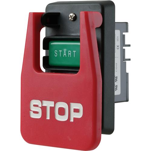

I have a 1hp motor for my grinder that I wired for 110 (yes, it used a lot of amp) but I have recently moved to a new house and the shop has a dedicated 220 outlet. Im going to rewire for 220 but I had an on/off switch for the 110, can I wire a switch to the 220? Is it as easy as using a push switch (or similar) rated for 110/220 at the middle of the wire run? ie; plug/wire -switch- wire/motor all of my other motors have been 110 and I ran them off of light switches. I just don't want to have to continually plug/unplug my grinder.
This is what you need for 220v. It will cut off both legs of the 220 at the same time which will be better for your grinder and safer
http://www.grizzly.com/products/110-220V-Paddle-On-Off-Switch/H8243

For the power on/off, use a switch made for turning a 220 motor on and off. It needs to be a double pole single throw switch. It is usually listed on the auction places as a motor starter switch. If you find one that is for 3 Phase, you just use two of the three poles.
The one Jason posted the link to is what you want and the price is right.

Sorry, double pole, I knew it was something like that. :-) It was wired for a kiln as the original owner of the house was a clay artist, so without tearing things apart, I can only assume it is wired properly but I am pretty positive it is. Yeah, at 220, the motor only draws 6.8a but 13 at 110. Without getting into it, do I still need 4 wires to match the switch and plug? The motor is still packed right now but it's new and still has the wiring schematic on it I just want to hedge my bets. Thanks for the help guys. And I can get that switch at Busy bee up the road for about the same price.
