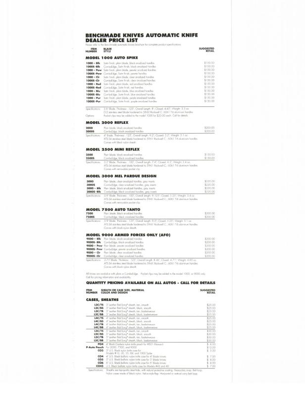

Cool, you have an early AFO here. This knife is a version of the Benchmade model 9000 (AFO). Only difference is the Al-Mar logo and the numbers on the blade. Blade steel and the rest of the specs are the same. BM may have made this variation for Al-Mar. I can't tell if they made them before or after the regular production version came out. I don't have military catalogs from the early '90s, but the first evidence I have of the model 9000 is the 1995 Mil catalog. Street price for this knife was about $150 in 1995. In my opinion, the prices quoted are too high for this knife. It is no different than the other ATS-34 and anodized aluminum-handled autos of this period for BM like the Reflex. The numbers and Al-Mar logo definitely add to its collector value, but 200-300 is a pretty large run by BM limited edition standards. If you want more specific info, fell free to email me. I've seen other early AFO's sell on the market over the last few years.
