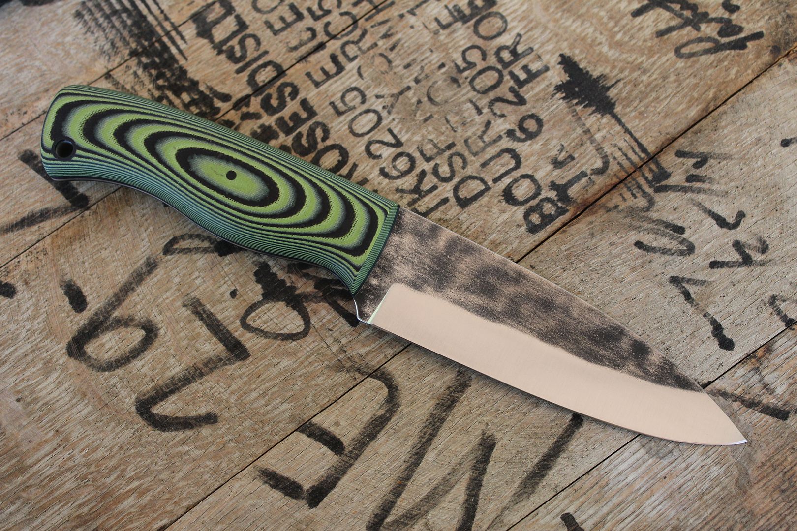

Specs:

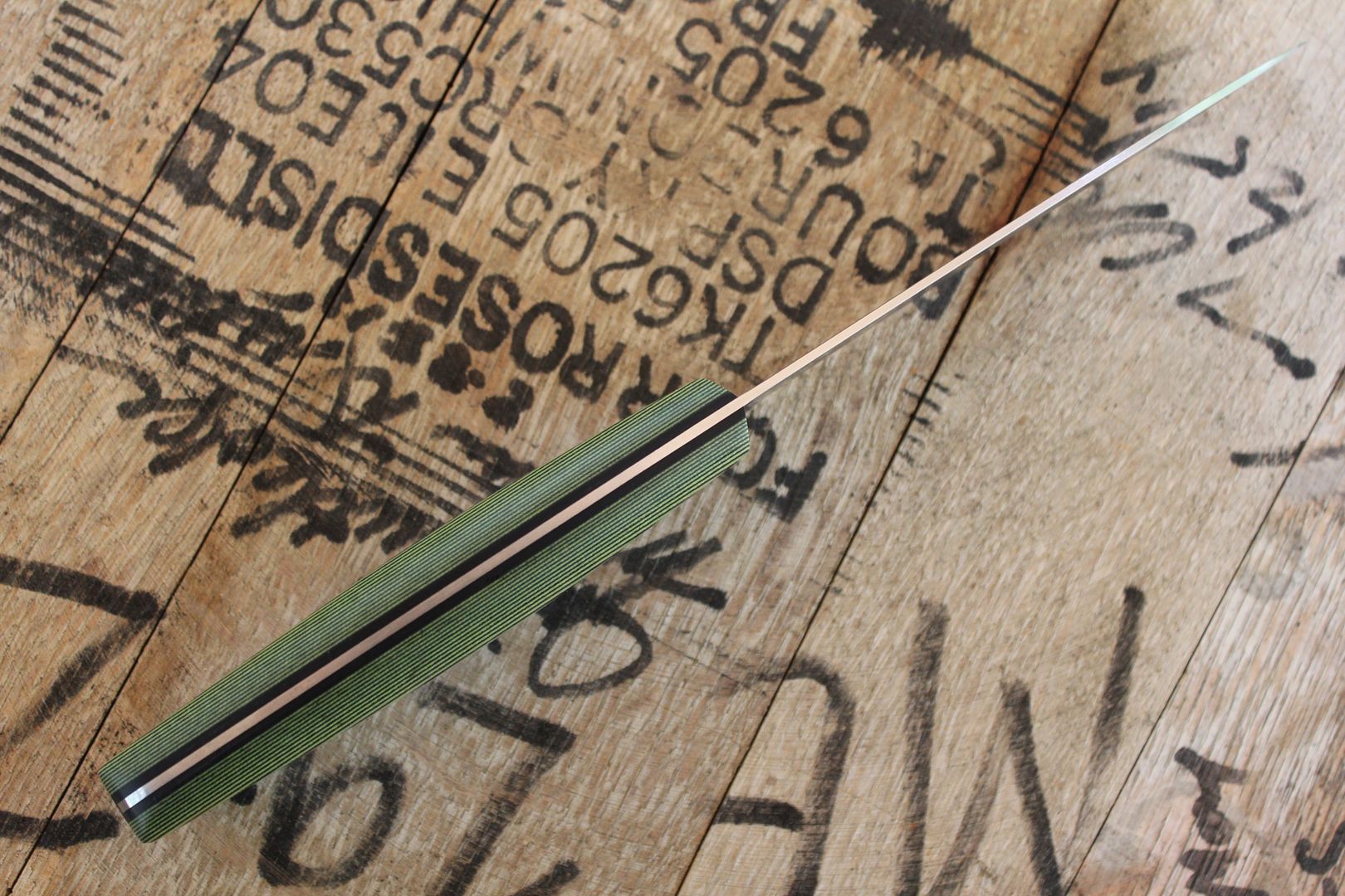

.065" CPM 10V
9.85" OAL
5.16" Blade
Flat Grind
Textured Flats
Heat Treated to 64-65 Rc
Black Paper Micarta Liners
Black/Toxic G10 Scales
Carbon Fiber Pins and Tube

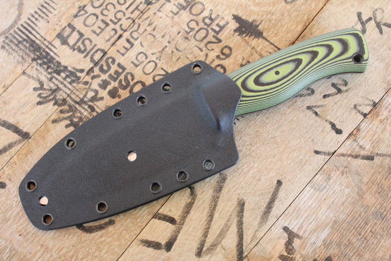

Black Kydex Sheath
Large Tek-Lok Compatible
Asking $ SOLD

Laser. You could perform Civil War surgery with it. All day.
I'm sure you could.
Not that it's the best suited for going through bone, but the flesh around it would not slow it down.
This pattern is a great Utility pattern for sure.
I honestly feel it is the most versatile I make.
With the exception of the Opinel, I've never owned a blade this thin. Much tougher than I imagined and cuts like a laser. 10v is an inspired steel choice. It's my "If I could only have one knife" knife. Someone should grab this knife and report back on their experiences with it. You'll be pleased with yourself for your wise choice.

Yes, I have used 10V for a lot of outdoor knives. While the steel really excels at edge holding and cutting of abrasive materials it is far from weak or brittle.
I currently EDC a 10V Bowie EDC and use it constantly.
If your concern is about the thinness of the blade stock, you should not be.
While you would not want to baton with this knife it is more than capable in any cutting or slicing scenario.
For knives like this I try to strike a balance for stability and cutting performance with the edge geometry.
Please let me know if you have any other questions or concerns about the steel or knife.
I have done a lot of carving with a Big Chris .065 10v and it is simply amazing. It keeps an edge for a long time and I've popped pine and cedar knots out and dug deep into these two woods and pulled the knife to the side to make notches and never had any problems with this steel. The only steel I've ever had chipping issues with being thin is s110v. 10v is as tough as D2 and it is going to take a lot to damage this steel.
Thanks for your comment Martin.
10V gets a bad rep for being weak and chippy and I am not real sure why.
It is actually quite tough and durable.
I have seen some minor rolling of edges that are .005" to .006" BTE but no chipping that I can remember.
That thin of an edge is kitchen use territory anyway.
The knife above, I have not measured recently, should have a BTE thickness of around .010" to .012" which is perfect for efficient cutting and stability.
When I first got a full thickness 10v wolverine from you, I kinda went to town chopping some new lines on the ranch. I had one tiny little edge roll, was not even difficult to fix on a Sharpmaker (of all things!). I am really impressed that you seem to be one of the few makers who challenge us to accept thin blade stock as totally capable of hard work. I've grown somewhat tired of the beastly blade stock that look like a chisel and probably slices no better than one. Keep them thin!! This one looks like a slicing beast!
Please do not confuse my statements.
I am not saying that this knife is good for or going to hold up to "HARD USE", I am saying "DO NOT BE AFRAID TO USE IT".
There is a difference.
10V makes a great knife, I carry and use one daily.
I have dug roots, cut carpet, made PB&J sandwiches, carved wood and dug out knots, all with 10V.
I try to make a light and functional knife that is a joy to carry and use, otherwise why would you want to carry it or use it.
