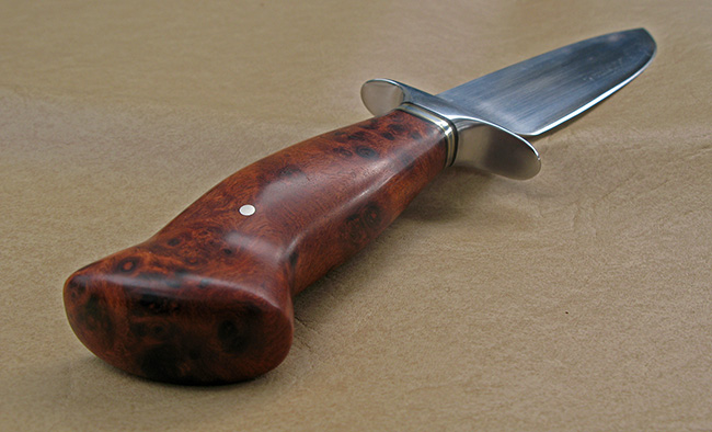

Yet, I use a gun finish on some of my hard wood handled knives (such as amboyna and snakewood which have a lot of open voids), but it is only to seal the open grain. When I use them, the finish is eventually sanded completely off of the wood handle scales, leaving only finish remaining in the open grain and pores of the wood.
Here's an example. There is no remaining thickness of coating on the knife below which was sealed with "Pro Custom Oil" which is a hand rubbing gunstock finish made by Chem-Pak, Inc.
