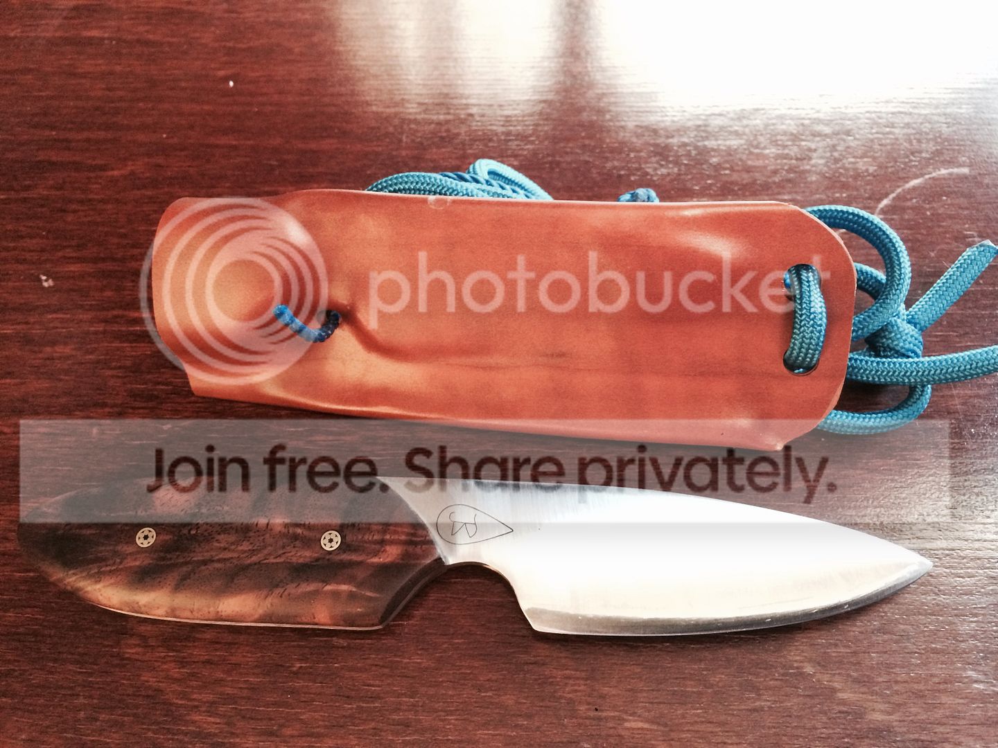

I've been away from active making for a couple of years and finished my first of the year at the beginning of last month. Walnut scales were chosen and as I was looking through the threads on gunstock finish etc, I noticed one conversation that stated that it was really not needed or useful taking Walnut past a 600 grit finish.
I was wondering if there has been a list of woods and when it's wasted labour to continue sanding. I think this could help people not waste money/time/effort, as I probably would have taken the walnut to 1000 or so at least, but was very happy with the results at 600

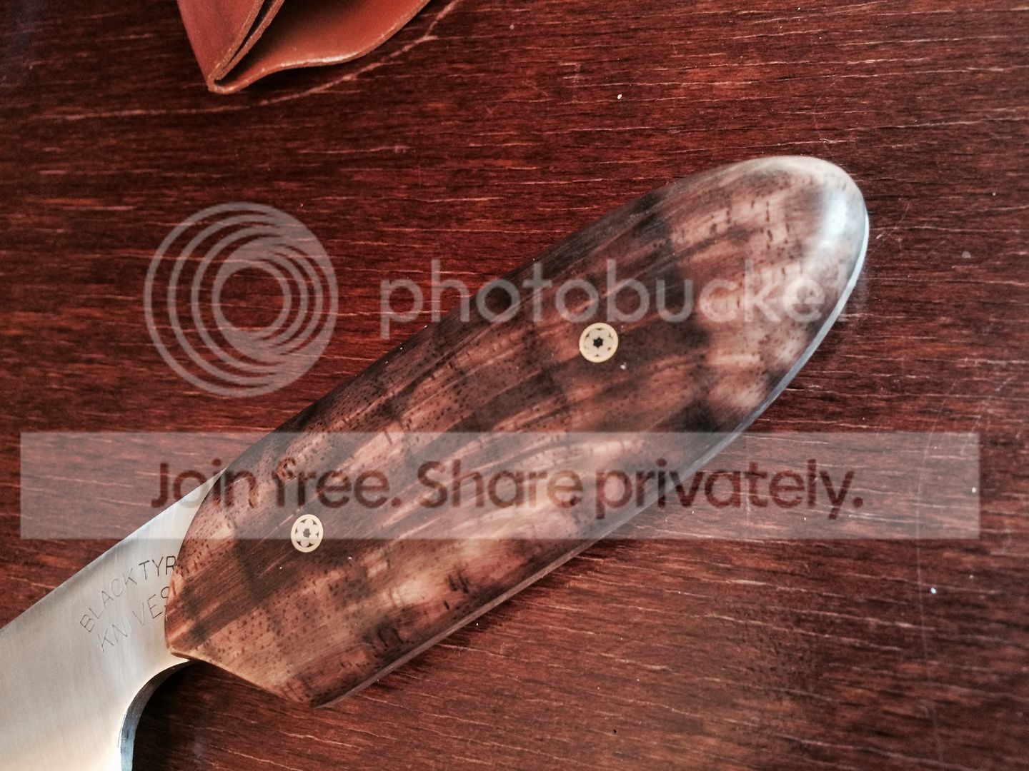

Seen here (critiques welcome) both sides cut from the same piece of wood, I was surprised at some of the hidden rays that appeared:

My opinion is that you keep going until you like how the piece you are working with looks.
There can be a lot of variations in a type of wood so experimenting and watching what happens is a good thing.
Good to see you back. The knife looks good ! For you it might be 600; for me 1000. I believe you if you just look at and decide is that's enough or not you will have your answers for all the materials you use.
Frank
Thanks guys. That's what I tend to do anyways, but I'm pretty amateur with a lot of Marks awesome wood and want to do it justice (even though I must admit this is from an eBay purchase.... Shhh.... Don't tell Mark I'm cheating on him, although that Afzelia almost had me selling children!!)!
It was surprising to me that I never heard of a grit limit/limiting returns outside of that thread. I believe I took this to 800, then backed down to 600 with a slurry of TruOil starting at 400. Lots of little things to fix with that knife, but I had limited time, and I'm just happy to be creative again, never letting another person destroy my creativity again! This is my free mind time.
