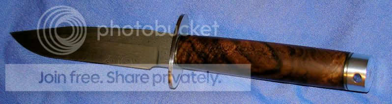

I did the brake vac home treat a couple of times. It was pretty good and I'll do it again. I'd say 3/16" - 1/4" of penetration. Much better than finishing the surface and hoping for good penetration, but not as good as professional stabilization. I did a sanded in finish on top because...I like to do that.
Claro walnut.
