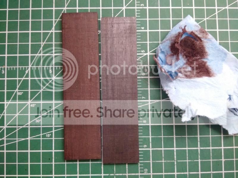

I just asked my wife to smell the cut wood and she said it kind of smelled like perfume. It's not unpleasant.
Last thing is to wipe afresh piece with the acetone cloth. Report what it looks like or better yet post a picture right after you wipe it.
The one on the left is natural and the one on the right was wiped.
Yep. Its 100% blackwood. Rosewood is often used in perfume, while ebony smells a lot like old socks. Wiping ebony yields mostly clean with a few black streak while woods in the rosewood family stain the rag completely in a deep brown. Personally i prefer blackwood over ebony. Its more stable, doesnt have nearly the cracking issue, just as hard if not harder, smells nice and i prefer working it, and it doesnt make you smell like a locker room.
