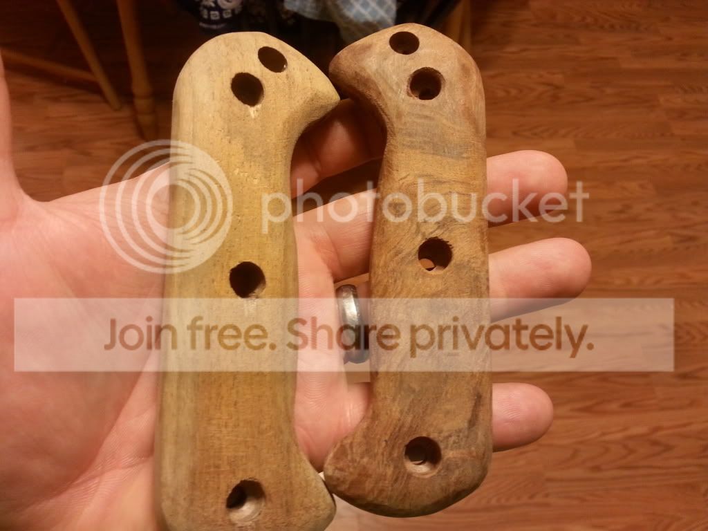

I have a set of wood scales someone made for me. all I need to do is put some type of finish on them. what do you guys recommend?
Would need some more info. What kind of wood is it? Has it been stabilized? What is the knife used for? Some common finishes are tung oil, mineral oil, shellac, varnish, wax: it all depends on what you have and what you want.
they are for a becker, so therefore hard use. one is walnut, the other I believe is dymondwood--is there anything I can use on both of them
Neither look like Dymondwood.
Why didn't he make them out of the same material?
If you want a good tough finish, I use polyurethane. Rustoleum water based poly for floors for a satin finish, Deftane oil based for a high gloss finish. Both have worked well for me, I like the water based because it is 90 minutes between coats and has almost no odor. for a quick and dirty that works ok and is super easy, mineral oil.
my grandpa made them and one of the supposed dymondwood (I think it looks like cocobolo) blew apart because of a knot. he only had walnut so he made the replacement out of that. he's too sick to make any more
10-12 coats of Tru Oil is what I would use. Lightly sand with 0000 steel wool between coats and you'll have a high gloss finish that is pretty tough.
how do you apply the mineral oil? I think I want to use that to clean it up and protect it. I think I want to sand it down more later. can I put a different finish on later? like tru-oil or a poly
One scale appears to be a rather plain walnut. The other is perhaps Bubinga or Rosewood..... but certainly NOT Dymondwood. Dymondwood is a type of knife handle plywood with colored layers.
http://www.knifemaking.com/category-s/298.htm
Any good oil finish will work fine on those scales. You can say it is a Scagel inspired knife when done.
