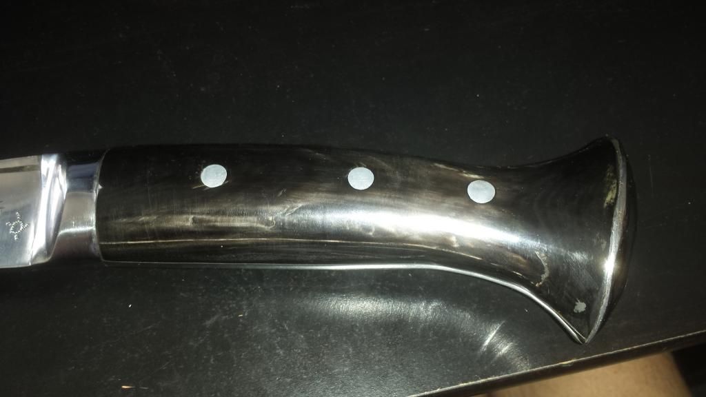

Horn does lack the grain that wood does so you will feel it when using the blade.. horn does slip a little,, I think wood grips better. Visually horns are beautiful,, especially some of the legendary deer antler handles from the past, check out the grain-age on my micro bowie: http://www.bladeforums.com/forums/showthread.php/1208040-Give-it-up-for-the-IBBB

Your horn grip is spectacular! Just gorgeous, I hope the grip I receive is even remotely as beautiful. I agree that wood and horn aren't the best for "surivial use". I have G10 on my Bark River Bravo 1 in A2 steel (blue/black G10. Most of my rifles were wood however and I prefer bone or antler/horn on my knives, bit my bushcraft/survival knife is definitely my Bravo 1. Its light and tough as nails. I love the warmth of wood. Most of my horn or stag material is just scales and not full grips. The WWII should be here in a few days and it will be my first true horn grip.
