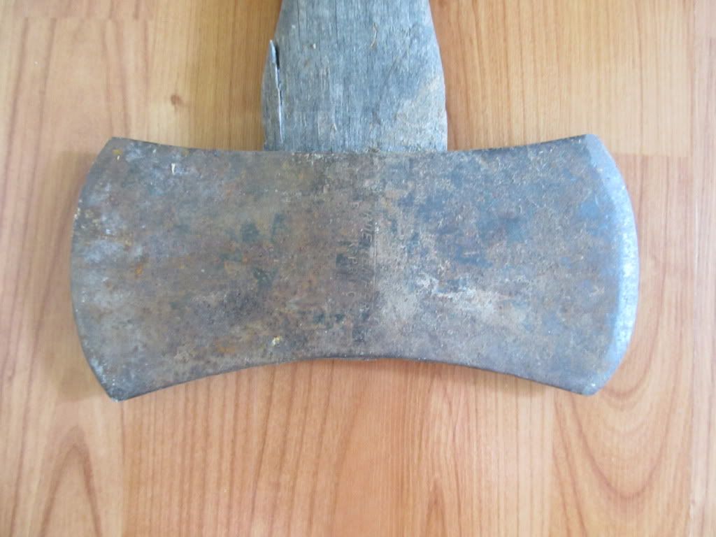

Oh, Ashley. I was going to mention that I just picked up a True Temper Black Prince/Walland Vale double bit up at a local garage sale for $2.00! Its in great condition too! looks almost exactly like yours:) Can't wait to start fixing it up. I will post some pics a little later, still have to take some:o
That's a great find! Can't beat $2 for an ax that's probably better than most $50 axes sold today. Looking forward to the photos!

Whoever hung this bad boy last put the head on upside down...So I (or rather my little brother) took the picture upside down, so you can see the head right side up! This is going to be a great axe after a little TLC:)

Whoever hung this bad boy last put the head on upside down...So I (or rather my little brother) took the picture upside down, so you can see the head right side up! This is going to be a great axe after a little TLC :)
Whoever hung that axe last may have deliberately put the head on upside down… My dad has done this a few times with axes that are very worn on the top of the face, to wear the lower end down and thus even out the face through use instead of lots of grinding and reshaping. This one was slightly more worn on the top, but not too much. It looks to be in great shape; have fun with it.
And thanks for the photo. :)
