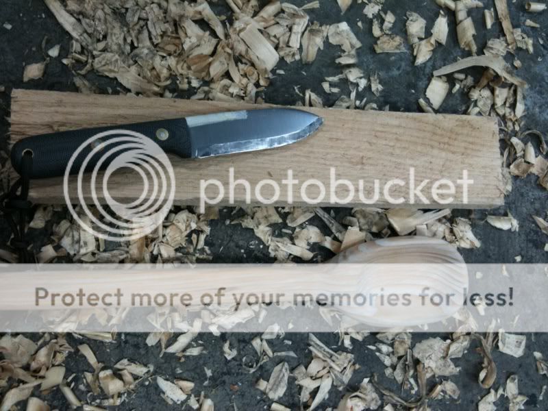

Would anyone be able to determine the type of wood if I put a picture up?

I'm pretty sure this is untreated wood. My boss buys it from a local sawmill and it's rough cut and pretty inexpensive. We only use it to reinforce pallets and boxes for shipping so I cant see him spending the extra money to buy treated lumber.
I will try and get a picture of the spoon up asap

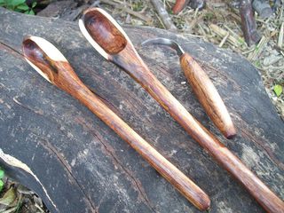

Using "green wood" (freshly cut or oftentimes soaked for awhile to soften the grains) helps in the making process especially when working with extremely hard wood, i.e., mesquite, TX ebony, guayacan etc.. You'll dry the wood then douse it with food safe mineral oil (that's what I use) or natural linseed oil (not boiled linseed oil) or walnut oil or the like. Regardless, once the spoon has been used and thus dipped in water and washed it will start to degrade. In other words, splinters will rise. That's simply the nature of wood. All wooden spoons when subjected to repeated submersion will frizzle up. I've made many hundreds of wooden spoons and frizzing is just part of the deal. On the other hand, you might decide to make a "dry scoop" for coffee or tea or things of like that. You will never wash or immerse a dry scoop and it will always look nice. Remember that all organic products degrade over time when subjected to prolonged water exposure...and that's what you'll get from wooden spoons dipped in water.
Check out the spoons on this thread. They are dry scoops and look as good today as when I first made them. I made the tools as well.
http://paleoplanet69529.yuku.com/topic/29428/Some-crooked-knives-and-spoon-knives-and-spoons

Here is the spoon and a piece of the board it was carved from
Well done!!!!! I like your BHK as well. :thumbup:
The un-carved stock vaguely resembles oak. The carved spoon vaguely resembles ash. Kinda hard to tell. Both are VERY hard, so if it was oak, or ash it would have been a PITA to carve. It also resembles hemlock. That would have been much softer.
There ya go!!!!! Do I have you all confused yet..... I am. :confused:
It's hard to tell without touching/seeing it up close. Sorry I was so worthless. ;)
Thanks Cascade!!
haha!! I thought the wood was pretty easy to carve but using a scandi ground knife makes everything seem easy to carve IMO haha.
