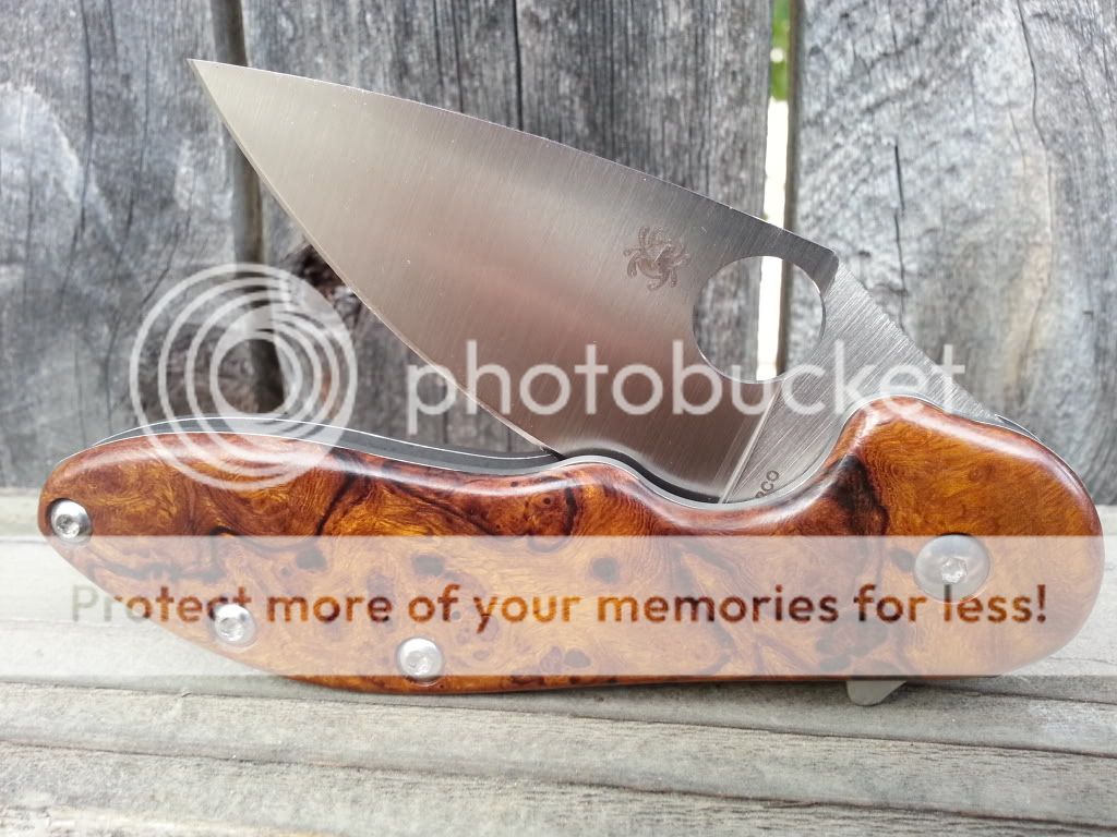

Wood. I understand it's higher maintenance but nothing beats a nice burl.
H/T coiledwire for his far superior pic of our respective sketchen-enhanced Dominos.
