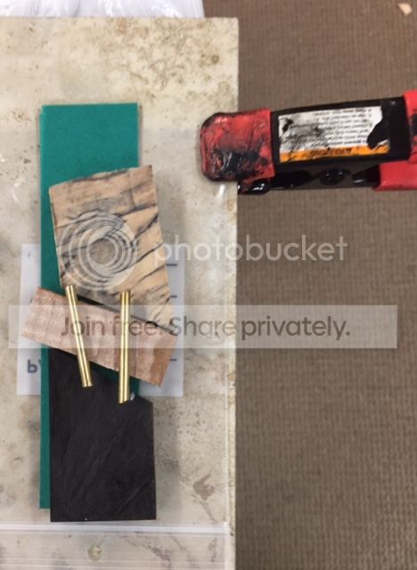

Since you've not had a "how to" response yet, I'll tell a bit how I glue up a scale using a wood bolster with a spacer between the two types of wood.
Do all your cutting, sanding, shaping of the joints so they fit together nicely. I'll then drill a 1 (or 2) holes into the edge of the bolster wood that matches two holes drilled in the scale wood. Then drill matching hole thru spacer, put a 3/32" pin thru these holes to hold everything lined up. The holes can be oversized and filled with epoxy if desired for easier fit. When it all fits, I'll then lay all three pieces on the liner to make sure it all lines up similar to photo, but fitted nicely.
Next would be to expoxy everything nicely because sure all holes are filled with epoxy, then insert pins to hold everything in place while clamping. Do NOT sure strong clamps that will squeeze all epoxy leaving a starved joint.
I hope this helps, just rough layout to show the idea.
Ken H>

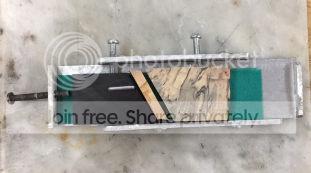

This is a wonderful idea.. question Ken, do you have a jig of some sort to ensure proper spacing on all pieces? And have you ever had issue with exposing brass while shaping the handle?

YES!! VERY careful about location of holes for pins. I try to place those in the lower portion next to close to liner to be sure the hole/pins are not exposed during handle shaping. Yep, I did learn that the hard way - had my wood fairly thick, drilled in center..... after shaping I had a tiny spot exposed. It was in solid black ebony so I mixed up some black sanding dust with epoxy, used a ball grinder to make a recess, then filled with the ebony dust/epoxy mixture and it "almost" disappeared.
I did rig up a type of jig to hold all pieces in place while gluing up - I'll try to get a photo later today..... maybe after Alabama ball game - SWMBO has Alabama games at top of "to do" list for me during football season.
edit to add photo: I think you can see it's just a rough jig, with the two screws on top holding the wood blocks down against bottom rail. In actual use, one block would be a good bit longer so the screw on left would hold blocks all together. I always put a sheet of plastic (saran wrap, etc) between liner and jig so nothing sticks. The pin shows direction of holes in everything - doesn't have to be long - extending thru the center spacer into the bolster and scale 1/8" or so is plenty. I usually use two pins, but suspect one pin would be plenty. Perhaps I should have shown a couple of clamps holding wood pressed against green liner also - a weak clamp is all that's needed, just to make sure the whole assembly is pressed together, but not pressed enough to press epoxy to starve joints.

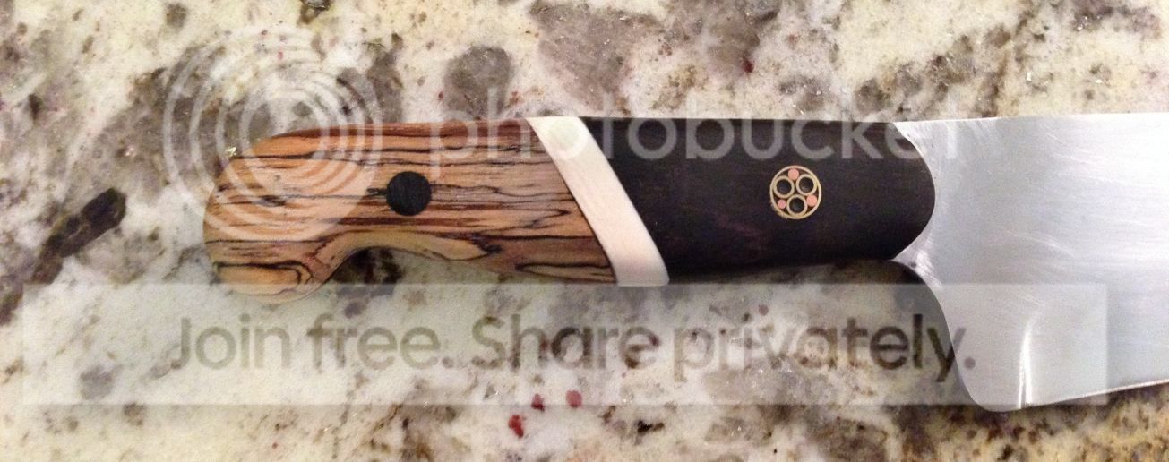

This is an example of finished product - stabilized spalted pecan, mammoth ivory, and ebony.
