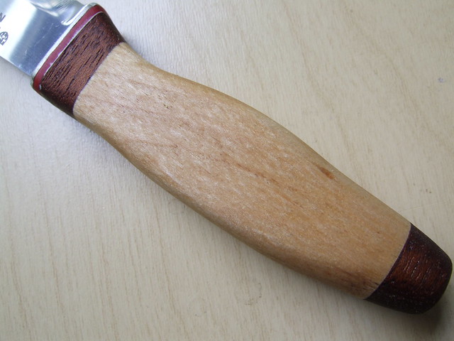

I am assembling a Scandinavian-style knife; hidden-tang. Instead of the traditional metal fitting, I would like to use some scrap mahogany or bocote, to shape a bolster. Problem is, I don't see any knives with wooden bolsters, and I wonder if there is a reason for that, like maybe..."Wooden bolsters suck?"

Just finished one, and I liked it enough to plan a couple more.
The Next one's will be with more contrast, planing ebony up front with a Lighter (maybe maple) in the back. So Go for it!

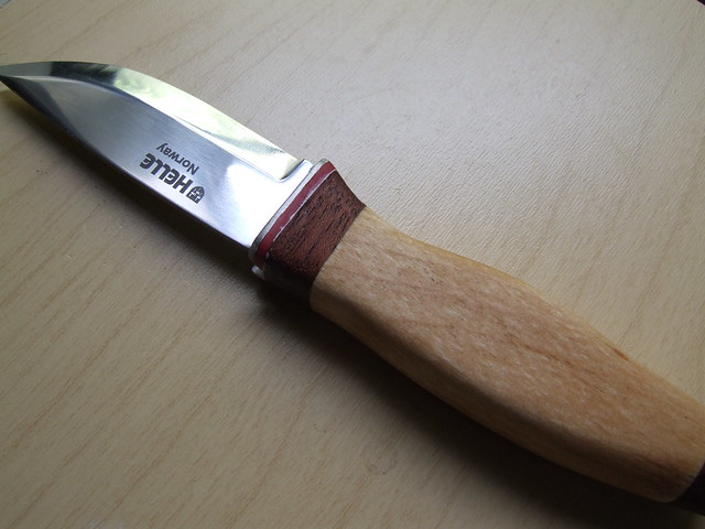

I made an ebony bolster, but I didn't like the look of it, so I made a metal piece, and some spacers to put on there.
Blade is 2 3/4". O.A.L. is 6 1/4".
I don't have a belt sander, so I don't make blades. I just make handles.
What do you think? Would it look better with some kind of pommel or nut on the butt?
