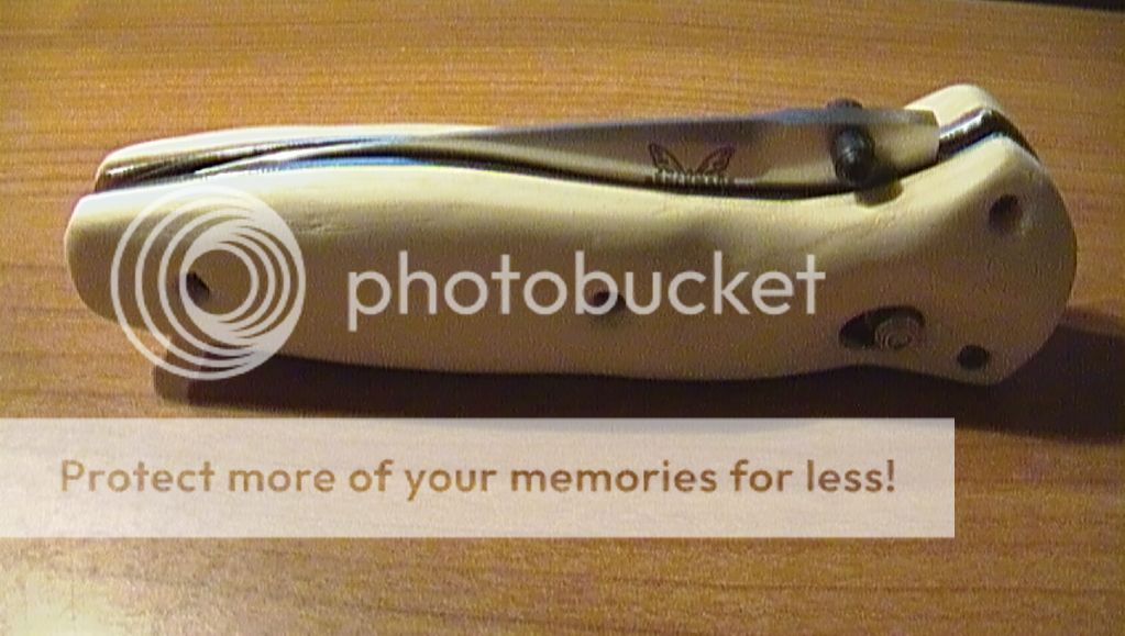

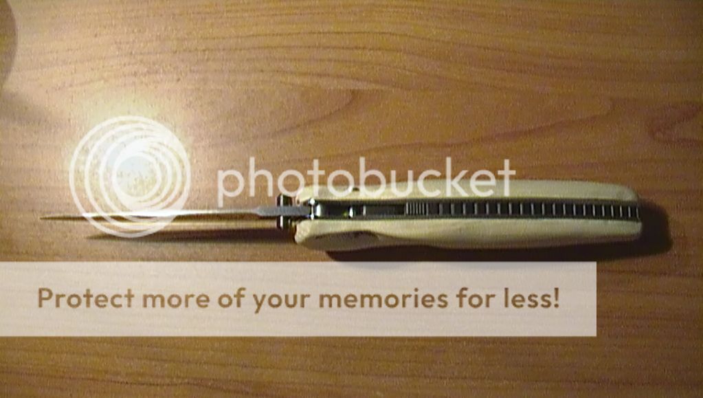

here are some pictures. I haven't done anything to them yet, and they are still a bit rough.
some might say they are to thick, but I made them for myself, and I like them. it feels good in my hand.
I used a video camera to take the pictures, so they aren't crystal clear.
You could get some combination stain/polyurethane at the hardware store. There are a lot of choices and most of them will work. The pine will probably stain darker than the color on the can. Just follow the directions. I think you did a good job for your scales. If you know someone who does a little woodworking they might have some stain and coating you can use. And they might have some advice that would be helpful (ie interior vs exterior coatings). Good luck and let us see your final work.
You did a good job on those scales!
If you have problems with the pine getting dents, you might want to upgrade to a hardwood. Check with some local cabinet shops or flooring installers, sometimes you can get some scraps from them which are big enough for scales. I've had success at some of the places that sell recycled building materials, they usually have some hardwood flooring scraps. I found some ipe (Brazilian walnut), oak, bamboo, birdseye maple, and black walnut flooring scraps.
