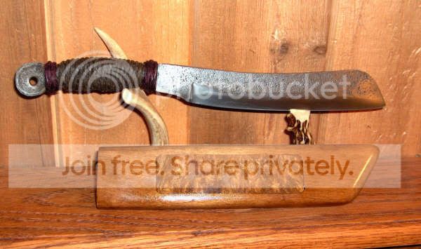

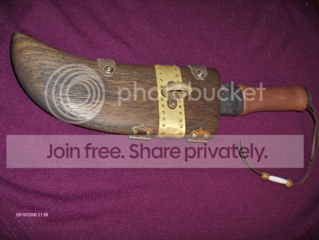

Wooden Sheath Finished
Jul 10, 2007
10
Finished my wooden sheath...not a very advanced way to make it ... but it works well enough.
That turned out pretty good. I like wood sheaths and I have made a few of them. There are so many ways to add "bling" to them and jazz them up a bit.

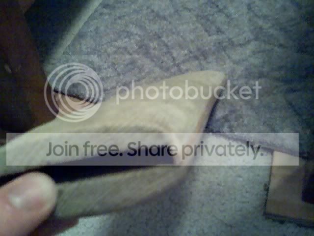

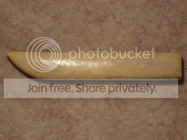

One trick I learned to get the fit perfect is to glue the halves together with a very small amount of elmers wood glue. It will hold it securely to see where the blade might be binding. I use a black dry-erase pen to completely darken the blade then slide it in and pull it out. Then I soak the sheath in hot water for around 20 minutes and the halves seperate. Once they are seperated you can see where the binding and pinch points are and sand/chisel/scrape them out.
Once you know the fit is perfect (or close) then you feel better about finishing up the contour sanding.

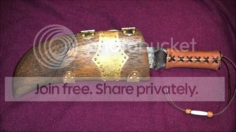

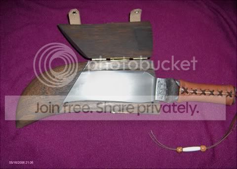

This is the most complex wood sheath I have made so far.
For fun................. of course.
Unique as far as I am concerned and it looks good too.
Syn
Thanks, the knife has a very pronounced persian clip and it would not just slide in and out of a solid wood sheath. The hinged lid gives it more wiggle room. That and I wanted to see if I could make it work.
This one I did a maple burl inlay on it.

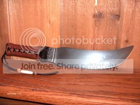

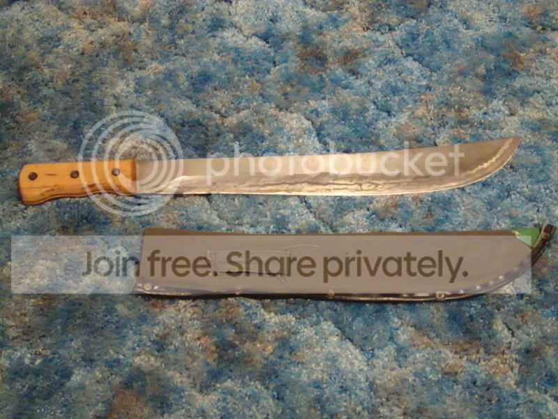

ah yes... I had a bit of a sticking issued with my machetes curve.. but the wood one is much better than the one it came with.. original sheath pictured below the machete.

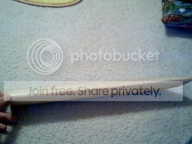

A good trick (and much better than gluing and soaking the sheath) is to "hinge the two sides with duct tape. Clamp them shut with a couple of woodworking spring clamps. Black (I use Dye-chem) the blade and insert it a couple of times. Un-clamp and route/carve out the places where the paint rubbed off. Re-clamp and repeat until the blade is a smooth fit. Then you can glue up the sheath for final shaping.
