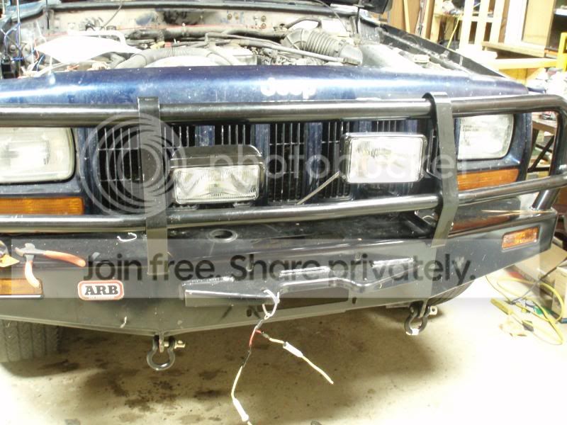

Went on NC4x4 and picked up an ARB bumper for dirt cheap. Its large and ominous looking, may not have good clearance for rocks, but it WILL clear trees out of the way when I do odd camping activities and it clears deer from the road with minimal damage.

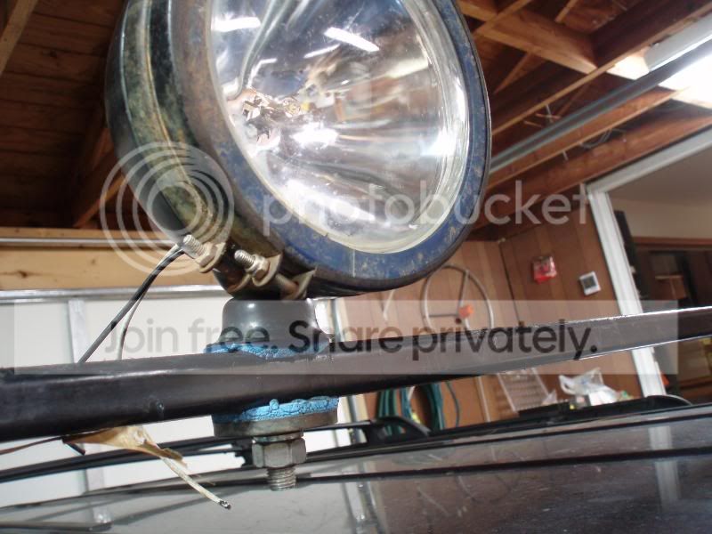

I then went to four-wheel parts and got 100w for the front bumper. Originally I had thought I would put all four lights on the front bumper but the lights that I had left over from the wrangler wouldn't fit. I had to put them up on top, drilling through my thule rack.
Oh yeah, I found a Thule rack in the dumpster that worked well for holding the canoe.
I spread apart the lights far enough so I could still fit my canoe on there, but I don't like the lights up on top and may move them to the cowl thingee near the front where my old wrangler ones used to be.

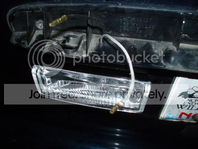

I need optimum light setup for snake hunting. I installed these lights on the back too for turning on after we pass snakes on the road. Normally we spot them with the big lights, after we pass em we run out in the back, dangling spot lights behind us. These new lights on the back help. They also do well for wheeling (duh) at night, lighting up camp pretty easily, and really pissing off tailgaiters. I may move them to the sides of the bumper. I find myself having to get access to camping gear in the back most of the time so it messes up the light use. I did short one out once when I slammed the gate to hard. But we were dealing with a 12 foot python in the everglades, so I'll just blame it on adrenaline. If I do move the lights to the bumper, I'll wait until I get a better bumper. I'm really hoping on one with a 5th tire carrier and will rig it to that methinks. Who knows, options for your options when one works now right.

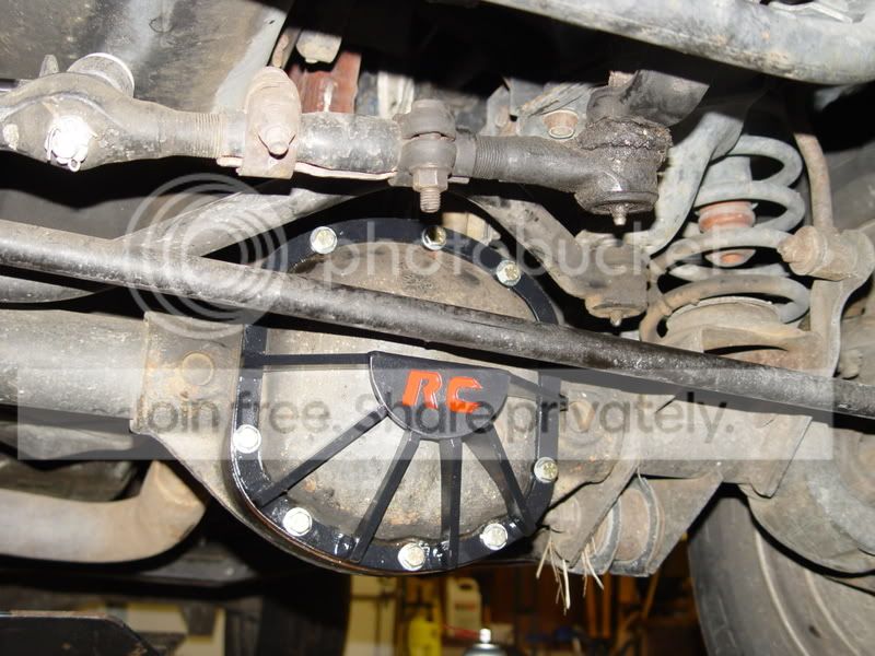

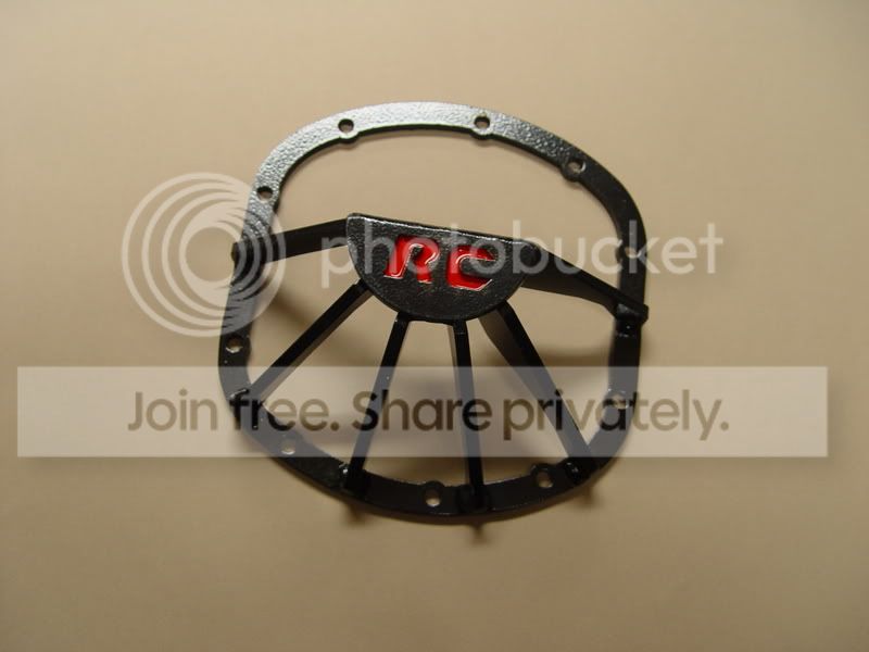

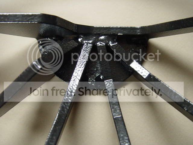

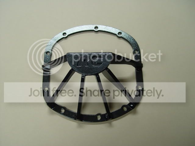

Diff cover

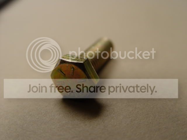

Came with tough bolts.
I painted Red letters for chits.

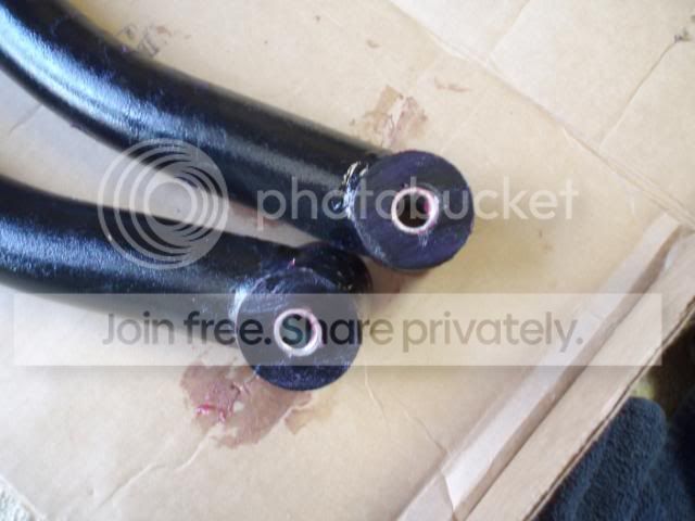

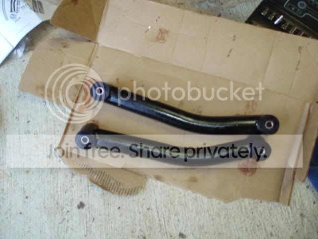

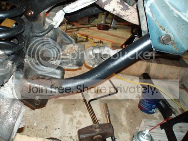

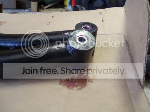

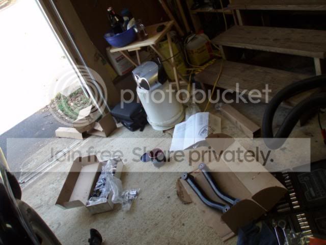

LCAs
I greased the crap out of everything. It helps after I break it later.
I won't spare you on the intricate details of the installation. I only have very humble mechanic skills, and have only fixed or worked on what I have either broken or installed, so that is about all I know. The directions though were distinct. I had to call in regards to a part that Saturday and was surprised when someone picked up. He replied "of course we are open now, who installs a lift kit during the week?" He was right, the time people would probably need the most tech assistance was on the weekend.Turns out the reason I called was a dull point too, as they included both the u bolts for a dana 44 and a 8.25 in the package. Score!

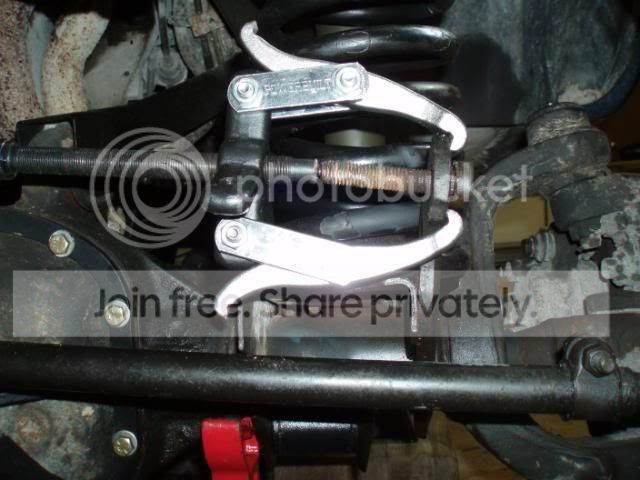

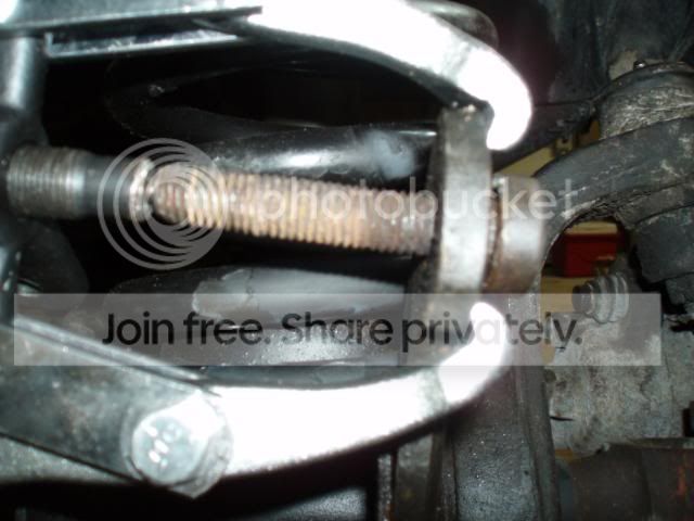

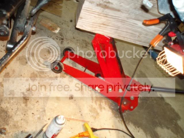

Well, the usual trials and tribulations of installing a lift on a cherokee. Sway bar stud nut bolt had to be pushed out with a gear puller.
Shock mount bolt broke, but that was a very quick fix with a bolt fished through the back on a magnet and pulled through with another. Both of these remedies I found on jeepforums.

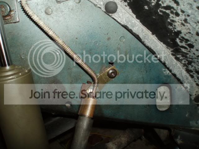

Brake line bracket. might invest in a new SS line later.

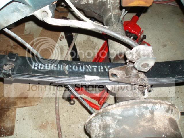

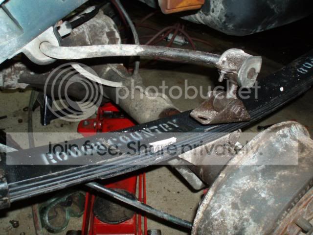

rear spring pack

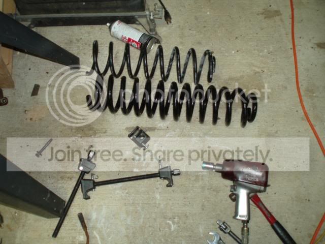

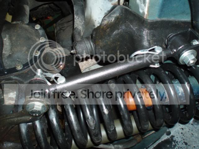

Stock coils next to new ones. Yeepppaww.

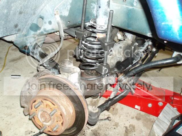

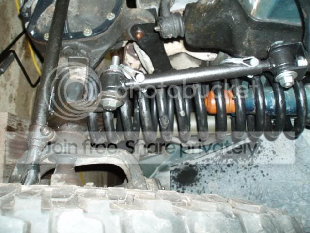

The directions didn't talk about installing the coils with a spring compressor. My new coils were so large I couldn't imagine doing it without one. Also, about 2 hours into the install I went and got the air tools from a buddy and an air compressor from my wood shop. OOOOOOOOHHHHH the glory of air tools, the sound of the impact wrench.

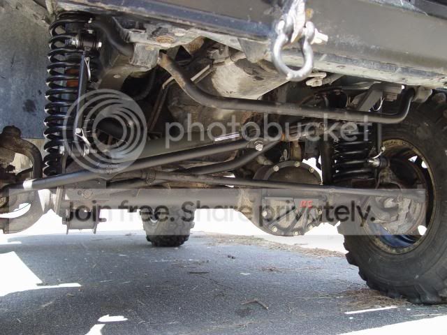

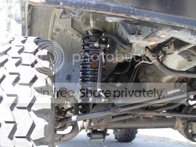

Coil and rough country sway bar disconnects.
with the 31s on there...
I also owe a special thanks to those who told me to go through and thoroughly coat everything in penetrating oil a week before hand. That helped out immensely. I still had to break out the sledge hammer, but who doesn't.

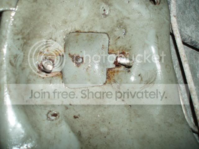

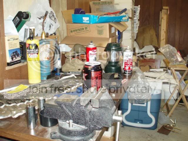

The biggest woe of the whole install was the transmission stud nut. They wanted you to use a two nut method of extraction. That worked on one side but not the other. I went out and bought a mapp gas torch and heated it, and used vice grips, working from side to side, to loosen it. Worked like a charm. I also found that remedy on jeep forums, once again, thanks guys!!!!

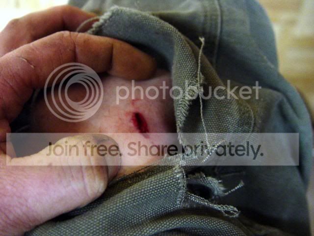

One thing I am pissed about. I got lazy and cut through the stock sway bar connects with the sawzall for fun, and left them there as I went about some other business. When I made the cut I left about a 45 degree cut. Wasn't paying attention and the point made its present known with a very deep puncture wound. Horay for butterfly bandanges! I'm not worried about the cut, BUT THE SON OF A &*%^#@ TORE MY &%$#@*&( CARHARTTS. ARGGG.

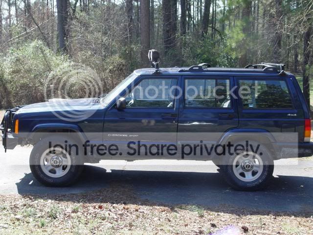

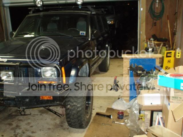

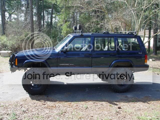

The almost finished product
FROM:
To

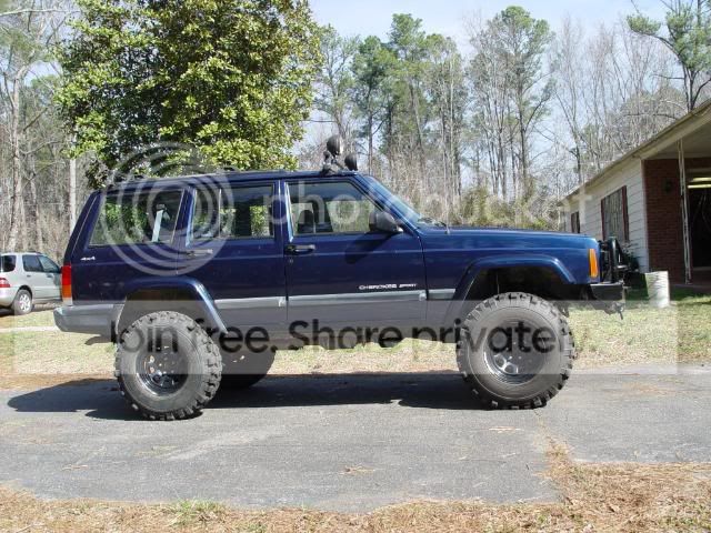

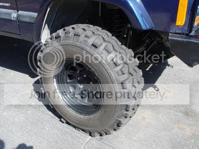

32" x 9.5 super swampers. Louder than any other mudders I've had.
I painted the shocks and dampener black and OD. The used to be white but it clashed with the rest of the jeep.

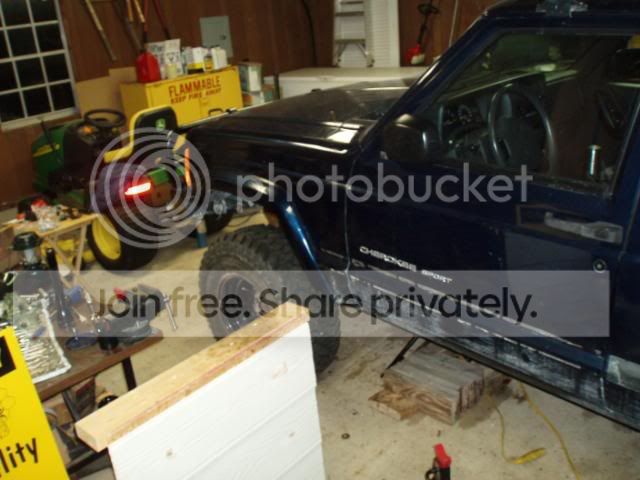

This weekend the rough country rock sliders go on. I also have a transmission skid plate from skid row for the bottom. I'll post pics up as soon as they are done.
So far I'm happy with it. Less than 30 miles total on the lift. I've had to do a little tightening and of course take it to go get it aligned. I had 31s on there but couldn't wait, the 32s in the back yard seemed so crunchy, I had to get them on there and sell the 31s. Anyone need a set of tacoma rims?
