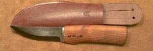

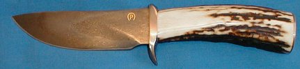

I have one wootz blade by the late Al Pendray, master smith. The other, which is called UHC / wootz, is a hunter by Heimo Roselli of Finland.
