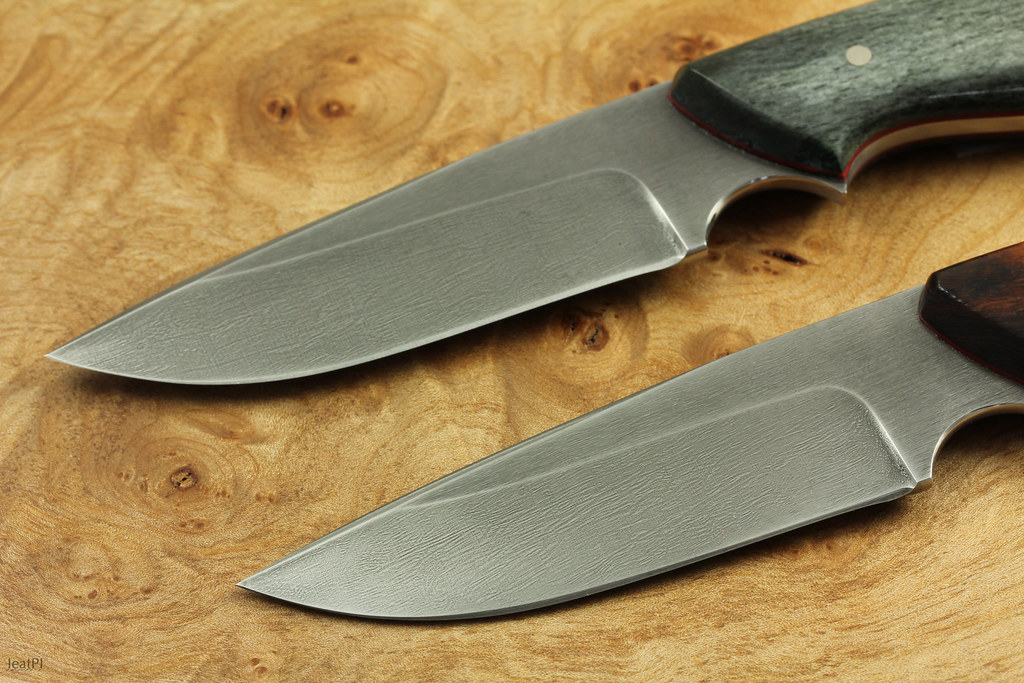

Someone from Carter Cutlery posted a pic of these two knives back in 2012. He mentioned his boss had made them. I can't find the thread, but the posted picture completely showed both knives.
I was just looking at pics of wootz knives today & saw the knives again on this thread, but the photo was cropped to show the wootz blades. No one here knows seems to know the source of the steel or the knife maker. So like Paul Harvey used to say on his radio show, here's the rest of the story:
The steel for these two knives was made by Ric Furrer from Door County Forgeworks in Sturgeon Bay, WI.
I purchased the steel from Ric in March 2012 and Ric, in turn, sent it to Murray Carter whom I commissioned to make a wootz knife. He ended up making the two knives you see in the pic.
For some reason there is no maker's mark on either of the knives. I had expected to see the Carter mark on one side & MS on the other side just like another neck knife I commissioned him to make from tamahagane steel with mammoth ivory scales. I was told anyone would recognize who made these two neck knives. This thread sorta proves that's not the case.
I think a maker's mark is essential to ensure a smith gets credit for his work as stamping MS on a blade recognizes the maker for their years of skill, experience, and hard work.
Carter used a new design he named the "Perfect Neck Knife" for these knives. One knife has green giraffe bone scales and the other has ironwood scales.
I wasn't impressed with the green giraffe bone scales. So my sword polisher arranged for Jose DeBraga to carve a design on the giraffe scales. Jose did a super job. The ironwood scale knife remains as it was made.
