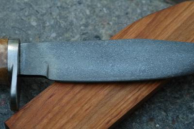

I am by no means an expert on wootz (an entirely modern term used to describe varying types of ancient crucible steels) but I have spent my time goofing around with people who are experts. Ric Furrer makes his own style of actual crucible steel and I have made some with him as well as doing quite a bit of analysis and metallography on it.
In the ancient world the ability to make homogenous melts of steel were darned near impossible. By far the most common material was bloomery iron and steel, which was a smelting process but not a melting process where true liquid metal was produced; instead it more resembled some of the modern sintering processes. Old world fires typically didn’t burn hot enough to reduce the ore and take the pure iron to liquid for proper alloying, so a super heated chemical process was used to reduce ore to spongy blooms which were then consolidated through forging (yes at one time forging did produce the best blades on earth!). Bloomery iron was pretty inconsistent and carbon levels were rather unpredictable and touchy.
In the midst of all of this the peoples of the east, India and areas to the north came up with a very ingenious process to get around much of these issues. Normal forge fires have a hard time achieving long term fires capable of the heat in excess of 2,800F with proper atmospheres to produce liquid iron. But as you add carbon to iron the melting temperature lowers quite a bit. In this process the refined iron was packed into a crucible with various fluxes and plenty of carbon bearing materials and then sealed air tight. The crucible was heated as hot as they could get it and inside the absence of oxygen allowed the iron to absorb the carbon without losing it. As the iron soaked up carbon the melting temperature lowered thus allowing even more carbon absorption, resulting in a useful vicious little circle. The result was a steel made from true liquid iron, much more homogeneous than anything else at the time, but it was also ultra high in carbon content.
The extreme proeuctectoid carbon tended to segregate out into interesting sheets within the matrix that resulted in a pattern visible to the naked eye.
Very impressive for the 4th century, not so much today despite what all the hype indicates. While the blades could cut due to carbide action alone overall strength was quite limited due to embrittlement problems. Heat treating the stuff like other steels would result in something more like cast iron than tempered steel. In fact something that we rarely hear about despite the overwhelming evidence is that the vast majority of ancient wootz blades were rarely over 38 HRC in hardness. Remember a recent thread on scratch hardness vs. penetrative hardness? This is an excellent example of it. The stuff will cut soft targets like crazy on carbide action alone but isn’t so great on heavy impact applications.
Many folks today use alloy banding to simulate wootz but if they didn’t put the hard work into working the crucible process they are not being entirely honest. If you want some wootz to play with Ric Furrer is a guy who is very generous with sharing both knowledge and products.
On a side note- shear steel is blister steel that was refined by shearing staking and then welding. When the need for accurate chronometers was overwhelming, an English fellow by the name of Huntsman put shear steel into crucibles and heated the heck out of it to produce a steel homogenous enough to make very fine clock springs. Does this process sound familiar? It also happens to occur around the time that England seized India in its imperial grip, hmmm?

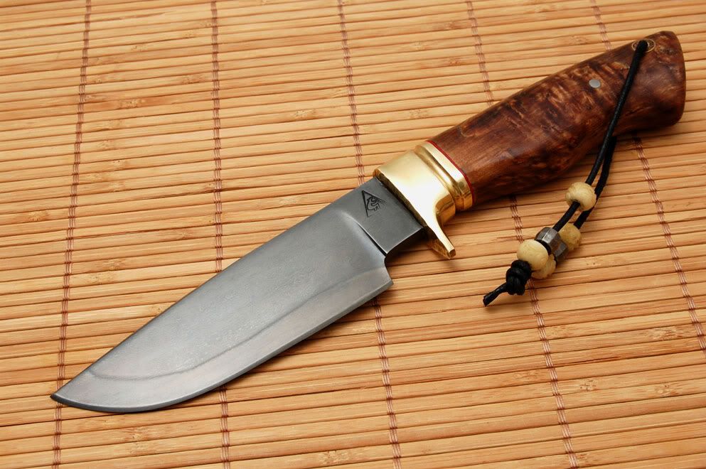

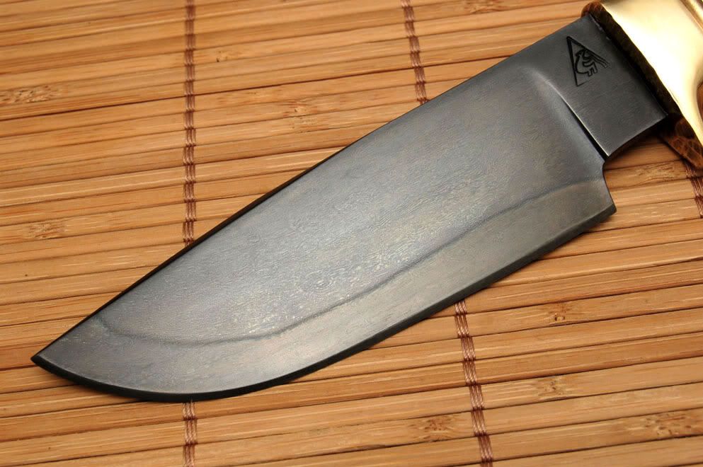

As far as I know, you can get wootz from:
Al Pendray (USA)
Achim Wirtz (Germany)
Fabian Damanet (Belgium)
All these makers make their own crucibles and forge them into Wootz.
I got a wootz bar from Finland too but don't know who makes them over there. Some guys in Russia make Wootz too.
The only wootz knife I have now is a hunter by Fabian Damanet.
