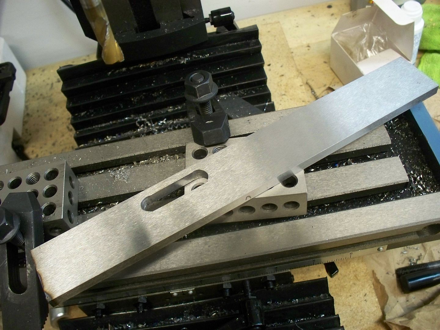

I used the mill to cut a slot. This part took a while! This is a piece of 1.5" tall .315" thick A2 tool steel. The slot got cleaned up with a file and sand paper.
Profiled, cleaned up, holes drilled, chamfered and everything is squared up on the horizontal grinder.

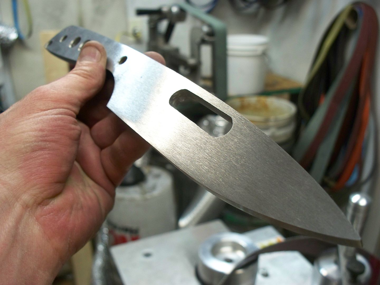

So far it is fast in the hand for a big knife, I think the balance will be really nice. I had to walk back up from the shop in the dark and I wasn't scared of bears as I was carrying it. :D
I might go with MCAM G10 for the scales and some sort of compound grind, it will probably be a bit like the one drawn in.
Looks to be about a foot long, with a 6" blade? I like those specs. Maybe an arched tanto-poon with the wraparound convexed grind at the tip...

Very interesting Daniel. Is there a purpose for that large hole on the blade other than looks?
I'll shoot an idea by you.
11.25" long with a handle just over 5".
Tanto poon, I like it! Good eye too!
Thanks!
The hole will change the balance up a fair bit along with a few other things I am doing. It takes out a lot of metal where it is the thickest. It really does not serve any major purpose though, it's just part of the package. I want this one to be thick yet fast so I'm doing everything I can to get it that way. ...which to me makes all the difference!

It is a hollow chisel with a convex edge, I ground it yesterday. The grind is high and it is thin behind the edge so the geometry is there... we will see! The tip is steep for strength like most of my knives.
I say convex edge but it is close to flat for ease of sharpening. I think almost any time a knife is sharpened by hand (belt here) it winds up that way.
The Pirate Sword is a convex chisel, cool you remembered it! It is a true zero bevel sword and made for cleanly chopping soft tissue. :eek:
