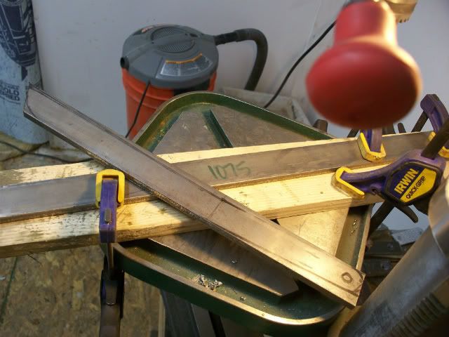

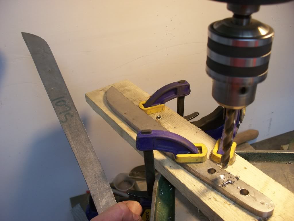

I just used my saw to cut a 16" piece from a 48" bar after roughing out a design with a marker.
I removed a bit of stock with my abrasive saw. That's a metal cutting blade installed in a carpenters saw, I still need a better saw.

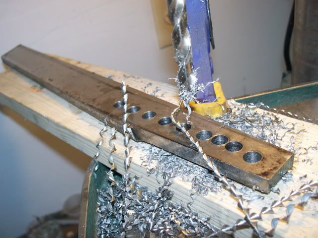

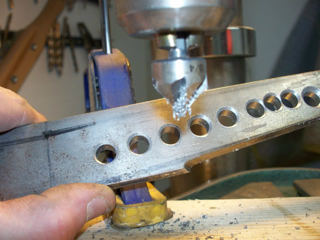

I drilled lots of 3/8" holes to lighten the tang for better balance. I just removed the clamps before the photo but I always use at least one clamp against the blade to stop it from spinning and one holding it down next to the bit.
Holes chamfered...

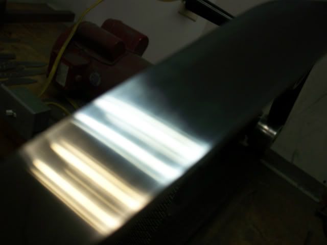

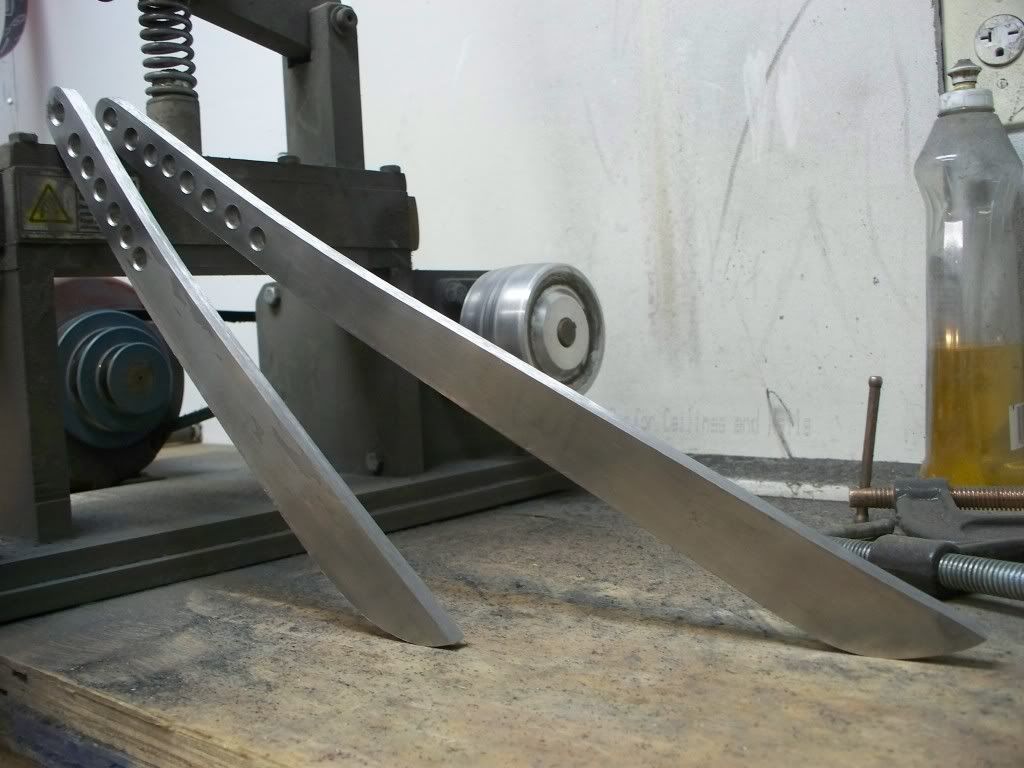

The profile is almost ground. I also rough ground the flats to 120 to remove any rust, scratches or pits.
Looking good Daniel, I can't wait to see this one progress! Are we gonna see a bevel on both sides of the blade.... ;)
Looks good so far. I've got one almost that exact shape/size laying around somewhere that I need to finish.
I love the idea of a camping sword! I'll be looking forward to watching this WIP
I was hoping you would make this a WIP. LookIng forward to seeing it.

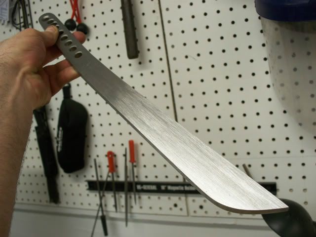

I used my 2" wheel to cut a deep groove in the tang, this makes tapering the tang easier later.
I then tapered the tang, it feels like it has potential to be very fast in the hand.
I sanded it up to 400 grit and I'm ready for heat treat.

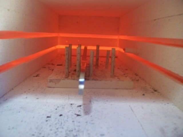

In the kiln!
Here is a photo of my heat treat area, I have my 11 second oil ready to go right next to the kiln. I like this setup and it is semi-outdoors for great ventilation.
The quench went great and "Yushi" is in the temper oven as I write this!

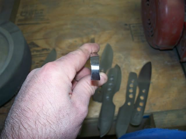

I decided to brine quench the blade which went very well. The blade got an incredible sori from the heat treat, about 1/4" of measurable bend! :cool:
The blade was a little warped so I tried to hot straighten it right after the quench wearing thick leather gloves. I thought the temperature was high enough but sure enough the blade snapped in the vise. I think the vise may have acted as a heat sink because I usually do this by hand with good luck.
The blade will still be used as a kwaiken and hopefully it will turn out great.

Profiled and drilling...
Ready to heat treat!

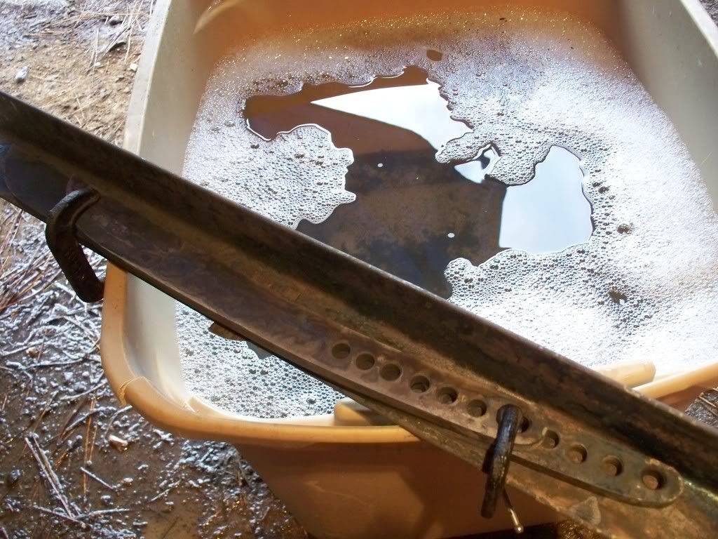

Making my brine for quench
Brine quenched and ready to temper

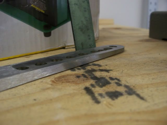

Check out the heat treat!
This was really fun for me to do. All three of this batch got a natural upward curvature from the water quench. This curvature is called the sori.
If you look closely you can see that after the first quench the blade curves downward and after the second it curves dramatically upward! It looks like I also have a "natural" hamon, I did not clay coat but I am hoping the interrupted brine quench will give me the hamon. It sure looks like it did!

The brine hardened them and it makes sense, the steel was labeled "water hardening." I'm thinking Parks 50 would be the safe way to quench Aldo's 1075. (low manganese content) I'll have more information later after testing.

Low Mn 1070/1075 needs a fast oil or brine.
Thanks for chiming in Stacy. That makes 100% sense and the brine worked great.
I have to mention that I noticed a brine quench is much less violent than a water quench. I had more noise when I water cooled my blades between temper cycles.
