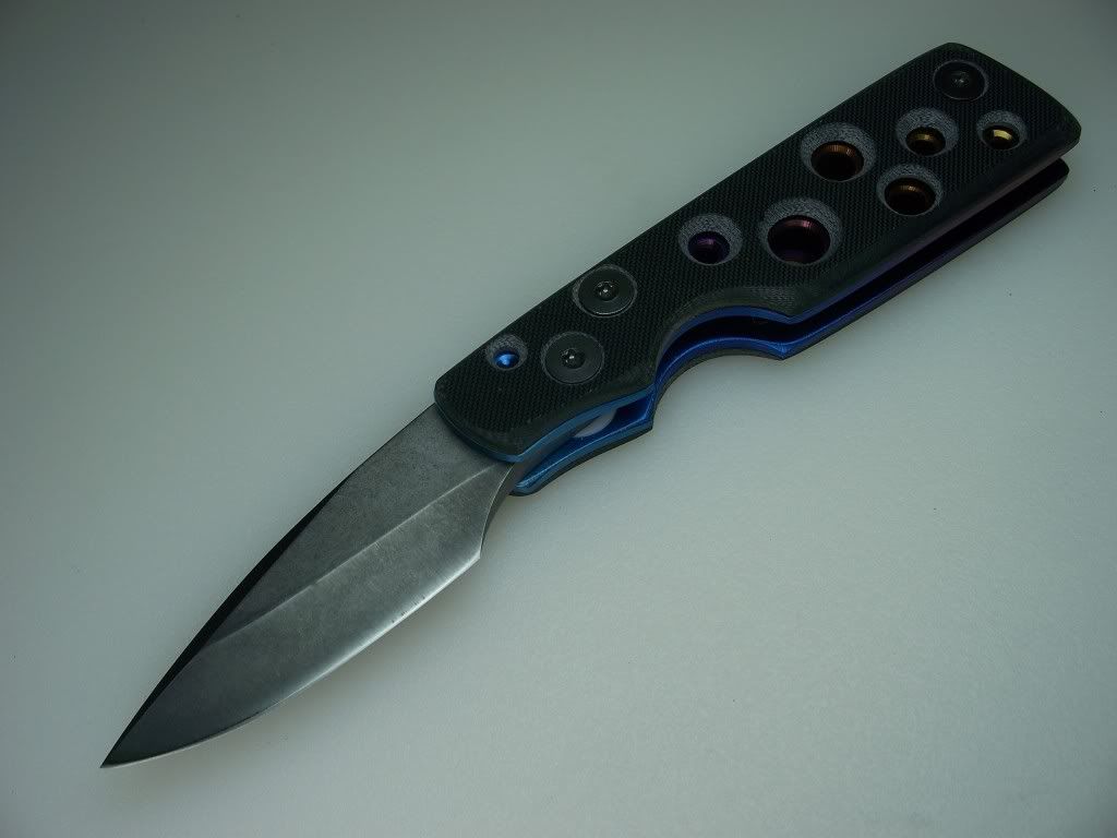

WHOA!!
Kombat friction folder?? :D

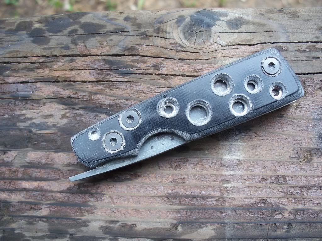

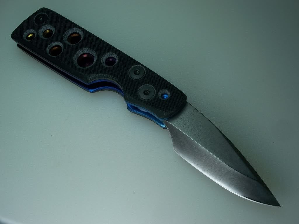

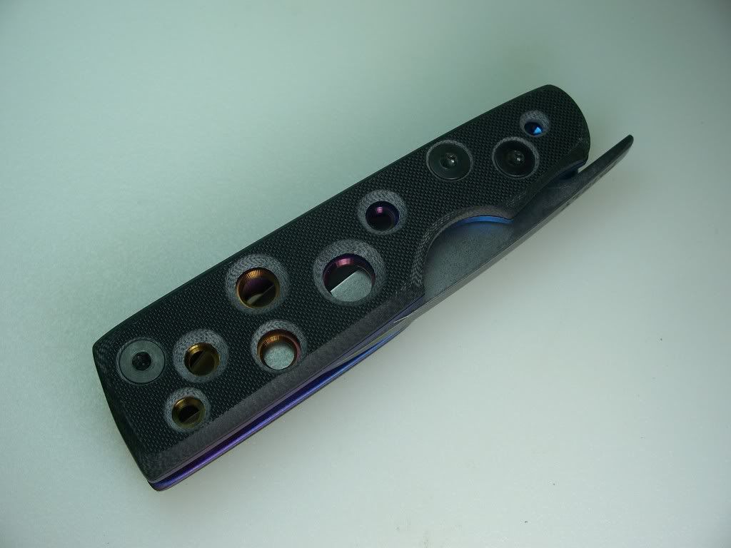

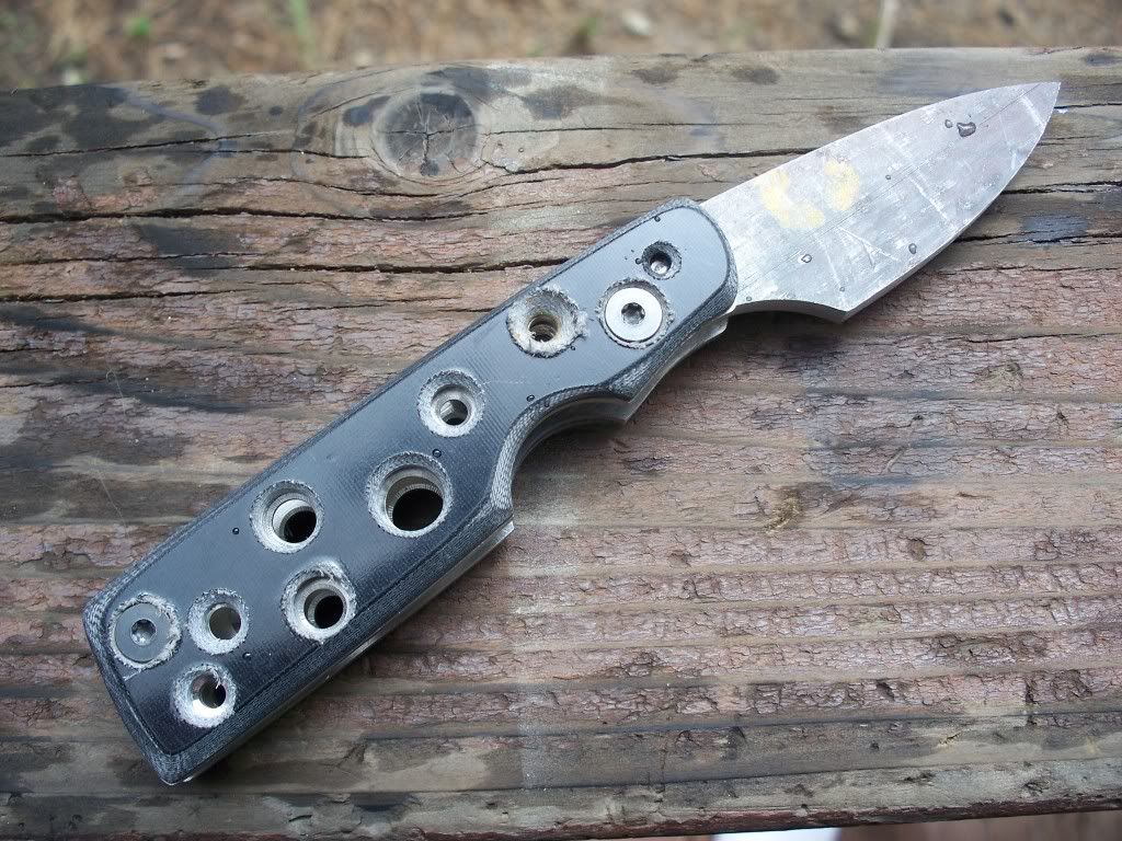

Exactly! It is gnarly to say the least.
is that 1/4"?

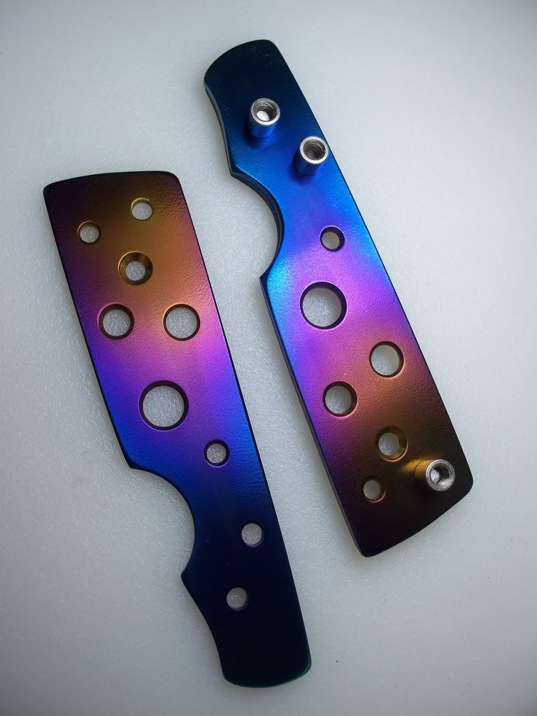

It sure is, 1/4" 5160 with .100" Ti liners and .125" G10 scales.
nice daniel!
Thanks! You have been making some awesome knives, I'm liking them a lot!

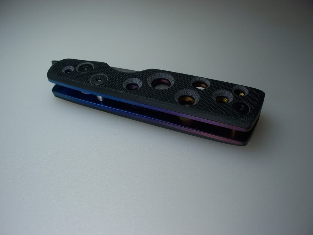

hey where do you get those pivots?
usaknifemaker 1/4" pivots, the last I looked I did not see them but they rotate that stuff out a lot

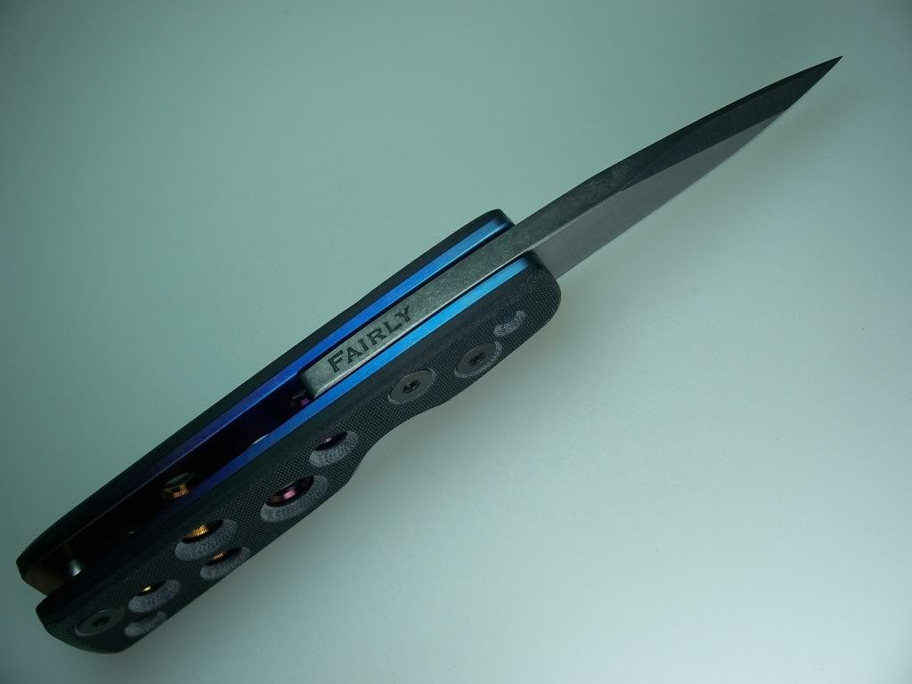

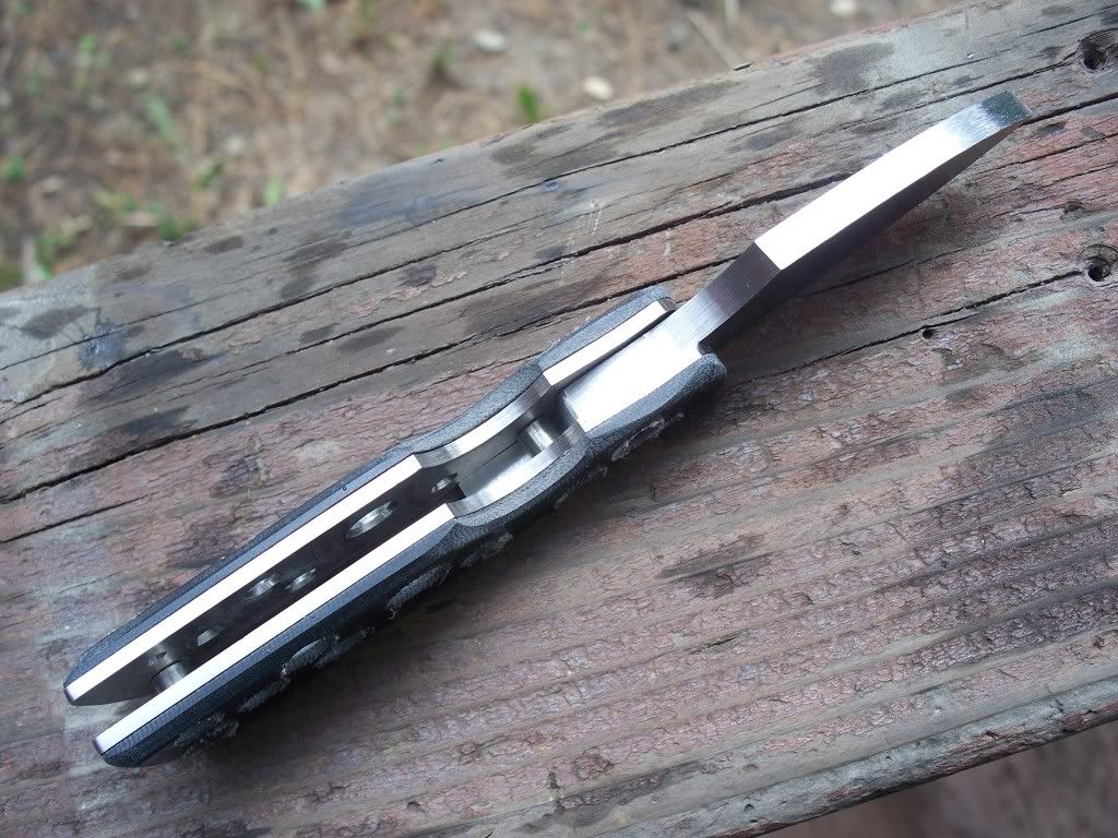

...asymmetrical grind and matching swedges, the grind is hollow with a lightly convexed zero edge
it's finished inside and out!

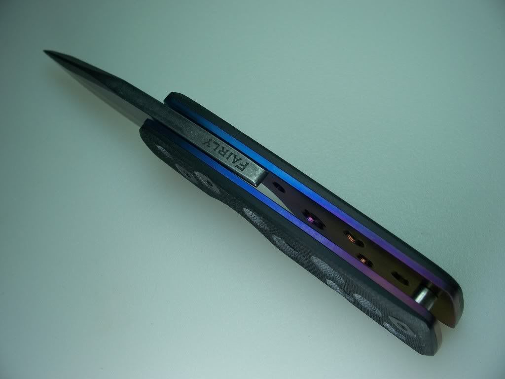

The signature is very deep and doubles as jimping.
