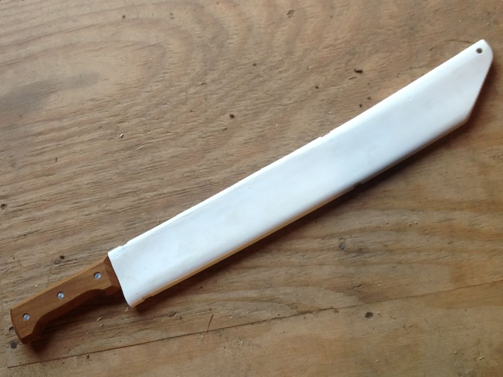

I'm making an oak sheath for my Tramontina 18" workhorse. That fine machete has dispatched dozens of scorpions, a handful of copperheads, and mountains of giant ragweed and brambles on my property, so it deserves a good home.
Here's the first sheath I made for it with 1-1/2" SCH40 PVC.
Those notched areas are where I tied on paracord to make a baldric of sorts. That sheath is very durable...but it is heavier than the machete and it would be hard to make pretty.

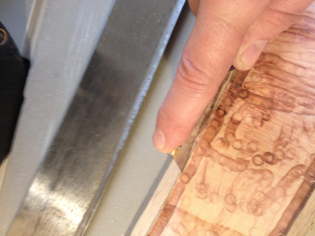

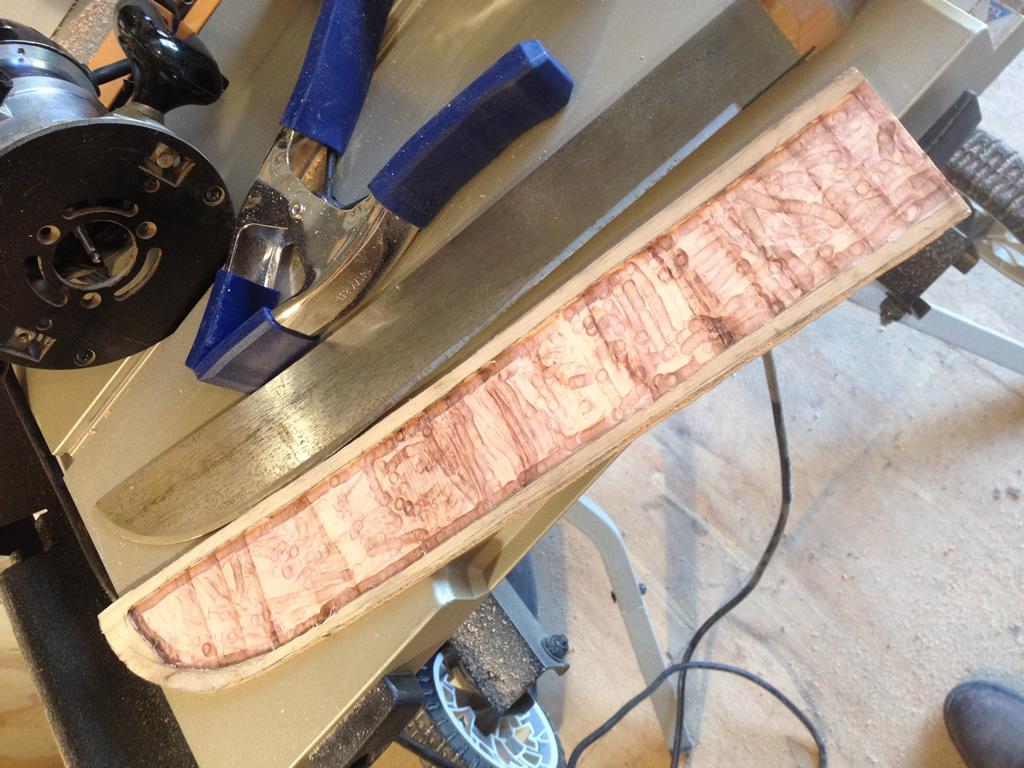

Next I wanted to make a void between the two slabs for the blade to live in. For this I used my router to grind off a layer or two of ply from one of the slabs.
I chose to grind into only the outer slab, and leave the inner one (which rides next to my body) full-depth.

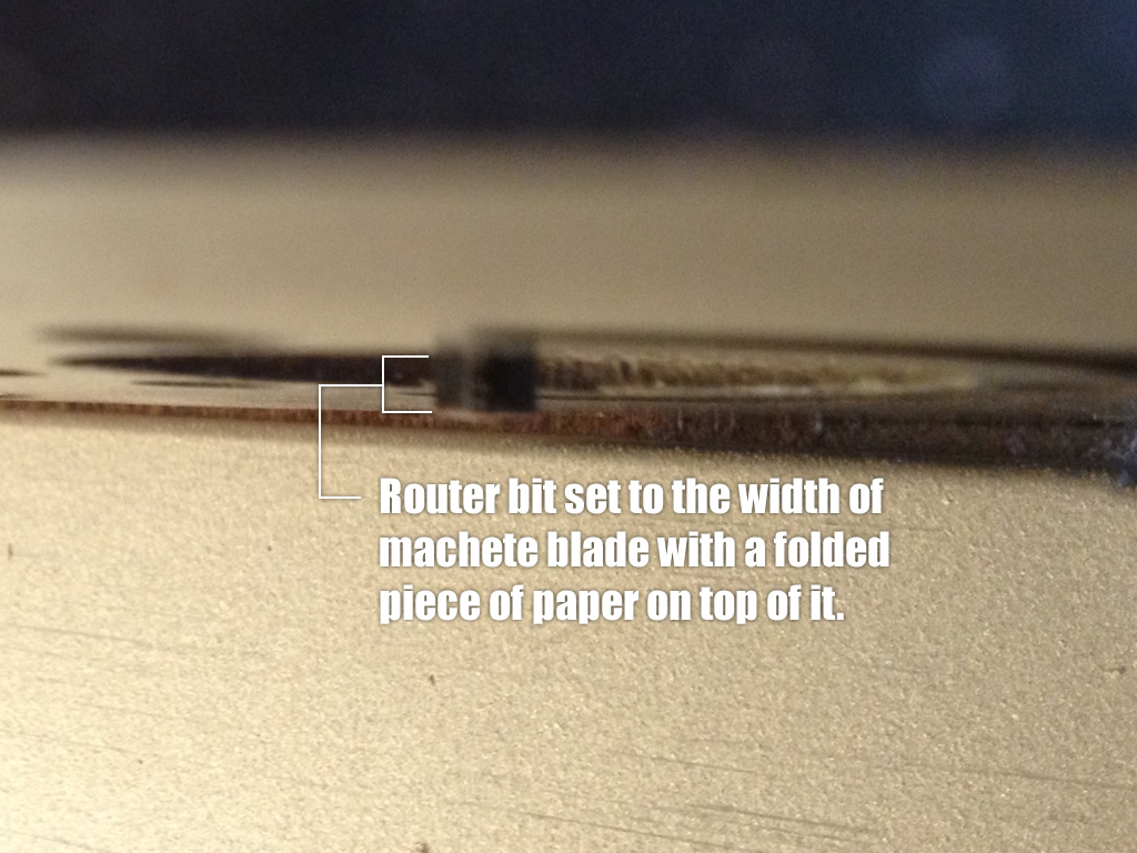

After doing some testing, I found achieving the ideal router depth is to set your machete blade down on a surface, put a folded piece of paper on top of it, then set your router bit to that depth. You just loosen the router guard depth adjuster and set it down with the bit on the table, and push the guard down onto on the blade+paper. Then tighten the adjuster.
With the variances in the blade and wood, this leaves just enough room for a smooth draw, but it still holds the blade in firmly. If you want to have some "tight spots" on this for extra grip... make them down by the point and up by the opening. That helps hold the blade in and keeps it from playing laterally. You just shave down those areas with the router bit set to blade-only depth with no paper.
I worked from the inner-most part of the channel out toward the edges. This helps because when you are working the outer edges, you want to be shaving off a fine amount of material instead of a mass of material that creates debris.
There are two or three layers of ply remaining there, but its fragile and bendy at this stage.
Here I am using a razor knife to clean things up on the edges so the blade doesn't snag. Any knots you encounter inside the plywood can be filled with putty.

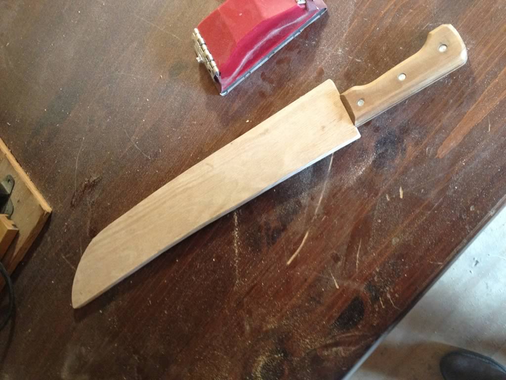

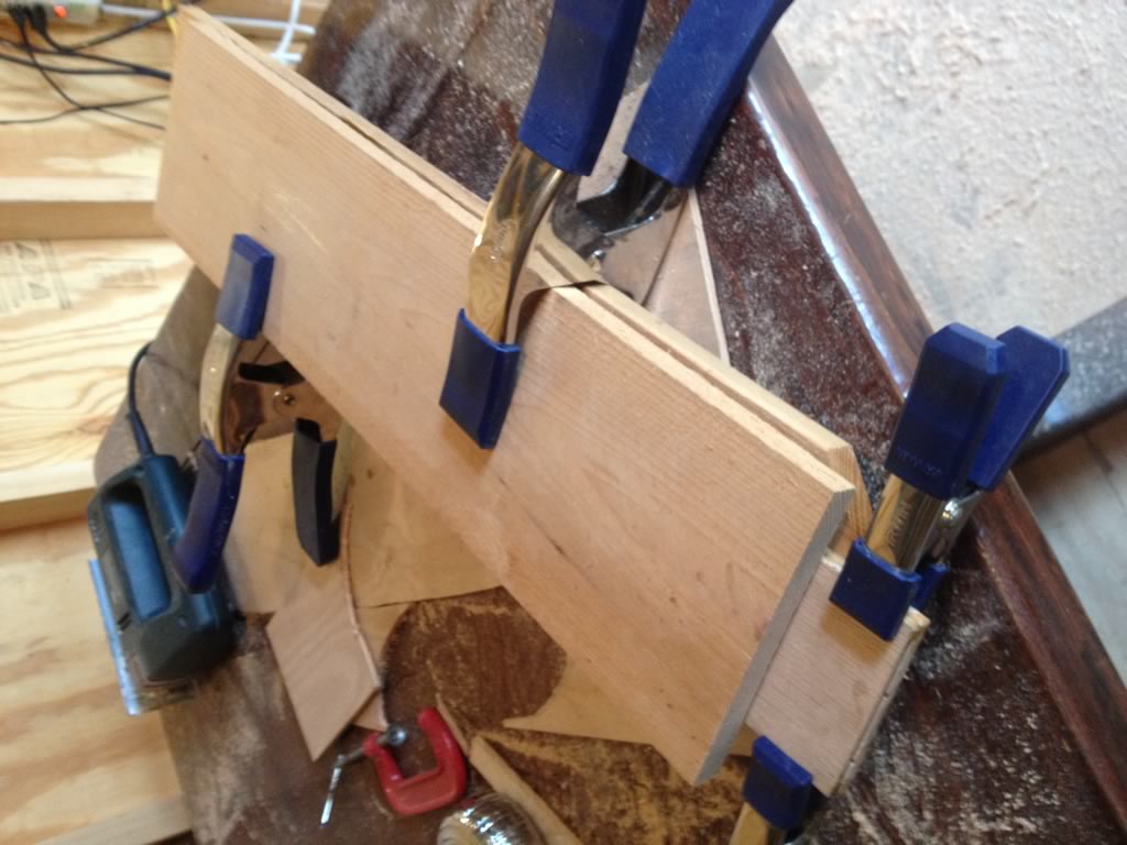

Next I put a bead of wood glue along the outer edge of the "lip" on the voided piece, then clamped them together between two boards. I let this set overnight, while I browsed the forums here to pass the time.
The next day I removed it from the clamps and ran it through some sanding to get rid of the glue that bled out and the variances in the two slabs.

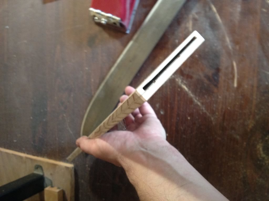

Here you can see the void where the blade goes in.
And finally how it fits together

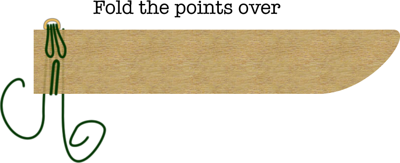

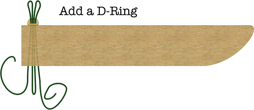

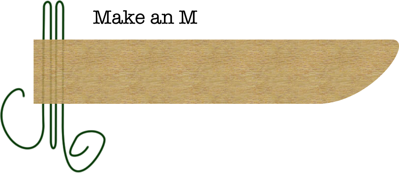

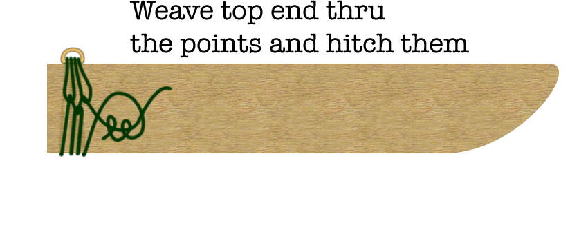

Hey thanks! Since I have so much paracord, I'm going to make some temporary prototype frogs with it before I go with leather.

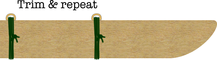

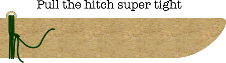

My temporary frogs will be two straps around the thing to secure it together and hold some d-rings for a sling. One right at the top, and the other near the middle. On each I'll zig-zag cordage three times around, and use a lace to bind them tightly on the innner side.
Here's my plan:
1.
2.
3.
4.
5.
6.

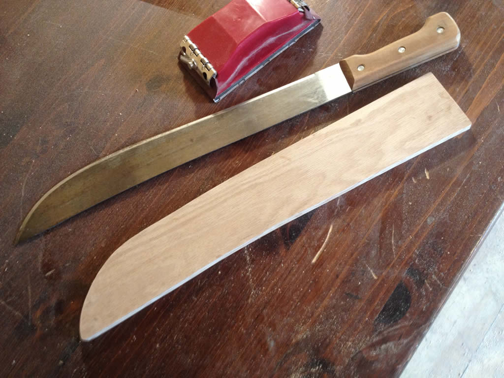

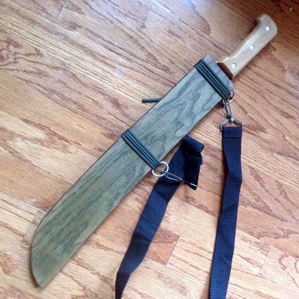

I should have followed up on this! Here's how it turned out (so far)
I need to get a rivet down in the tip of it, and I definitely want to go leather for the frogs and strap... for now its holding up well with the temporary kit. Only trouble I've had is the mouth of the sheath can be difficult to aim straight on. Next time I do it, I'll flare it a bit.
The coloring is from molasses, coffee, and some liquid chlorophyl we had around. After a few coats, I covered it with BLO and beeswax.
