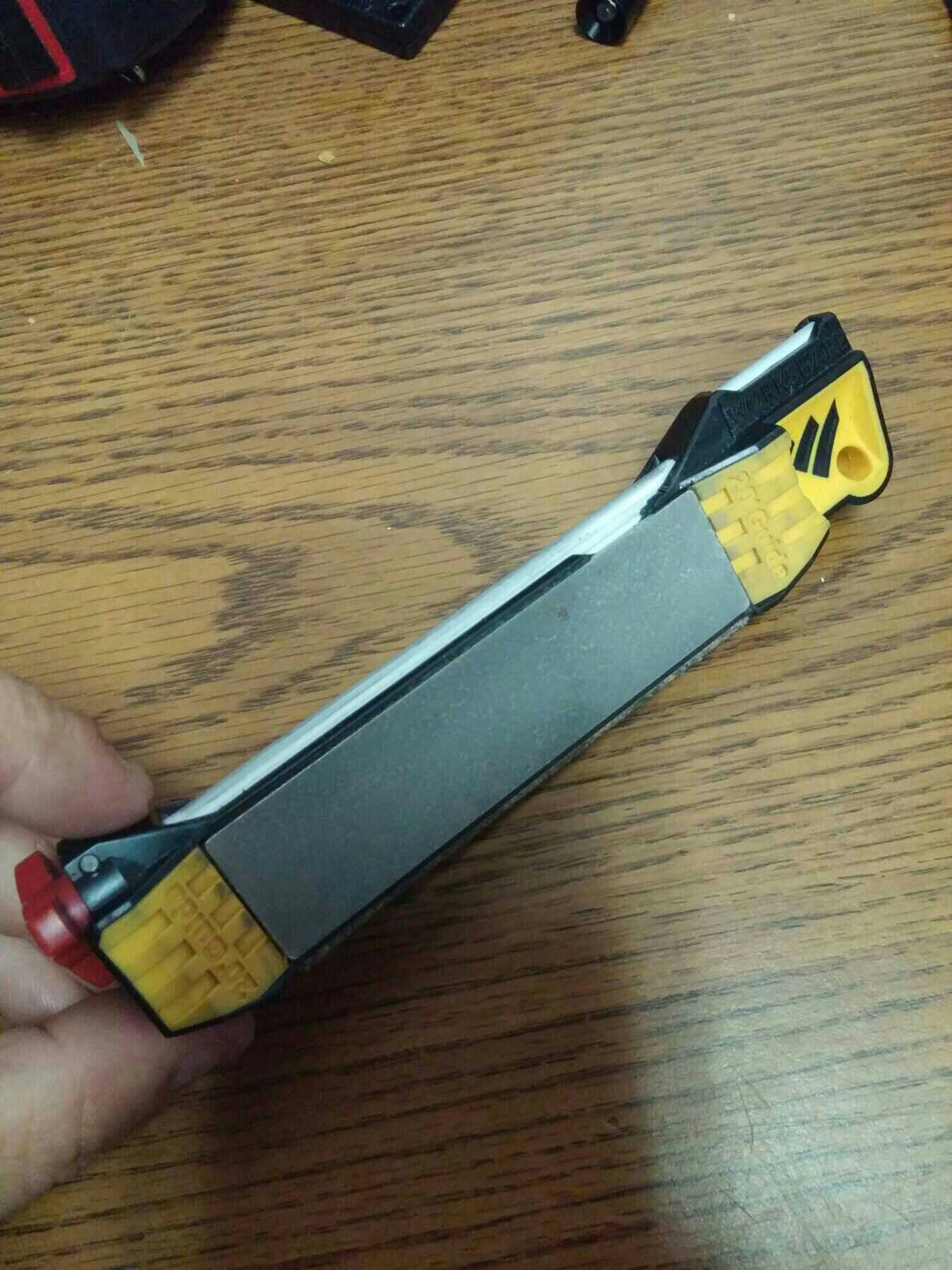

Are you talking about the electric model, or the manual? I have used 2 of the electric models, and currently own the WorkSharp field sharpening system.
I was referring to their manual one. It's similar to the field sharpener but more of a tabletop model. It might be new?
I have used that as well and plan on purchasing that soon. I personally love their products. The one you are referring to is just a little larger than the field sharpener and also has a swivel if so desired which I think would be very useful. In not a super fan of the electric sharpeners, as I feel they remove too much material, but love their manual ones.
Not sure if you have a Cabela's near you, but they have them on display there for you to try out and see if you like it. That's actually where I first tried both the field sharpener, and the one you are speaking of. That sold me. I bought the field sharpener immediately after that. I have sharpened over a hundred knives, and some multiple times, and the field sharpener is still going strong! Carry it every day in my lunch bag to work with me.
