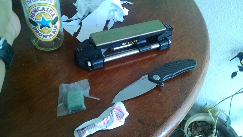

So I finally got around to buying a work sharp bench stone set up to enjoy my first day off in four weeks.
I even bought the extra strop kit with the two other diamond grits to complete the set.
Decided to try out the strop and have a few brews. To my amusment they included a small "starburst" square of green compound and some petroleum jelly in a single use, first aid style, tear open wrapper.
Interestingly, the instructions say to apply the a light amount of jelly to the strop and then crayon on the compound.
Never heard of that.
To my surprise it worked great and prevented caking and streeking and made applications easy.
The compound seemed to melt into the strop. Weird.
The package states "0.5 micron" that's cool but seems skeptical.
The results were great though.

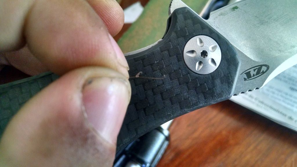

Whittled a hair.
I think there green compound is more abrasive than 0.5 micron. I have 2 other brands that are labeled 0.5 micron and they're definitely finer....It works great but can tell it's removing more steel than the rest by how quickly it turns black compared to the others.
Yeah, I doubt it is, but can't tell. Works good enough though.
