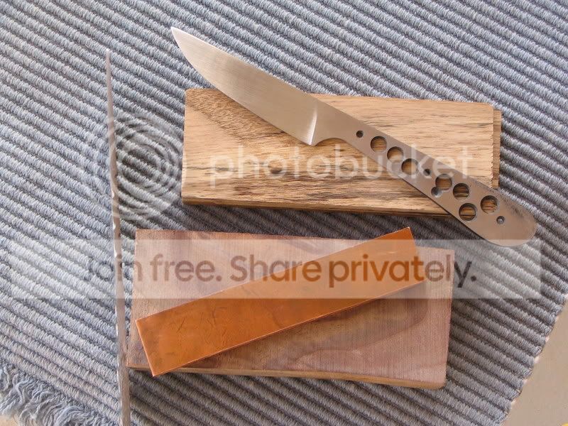

I have some unstabilized spalted wood that I acquired recently, and I'm about to use some of the spalted red oak scales that I received for a knife I'm currently working on.
I understand a mask is a good idea, as the fungus spores could potentially be an issue, but is there anything else I need to know before I start working/grinding/sanding it?
Also, what would be the best way to finish this wood for an attractive and durable end product?

Thanks gentlemen for the advice, I'll check into sending it to WSSI. Hopefully it won't be cost prohibitive.
Here's what it looks like (at the top with the intended blade sitting atop it.) Sorry for the crummy pic:
I have read that unstabilized spalted wood will sometimes split on the spalt lines if mishanled. I dunno, I could be wrong. If you are afraid of the plastic look some folks sometimes complain about finish it with 0000 steel wool.
Yes, clear stabilizing.
The wood in the photo could be broken by hand before the stabilization. Now it is rock
hard.
