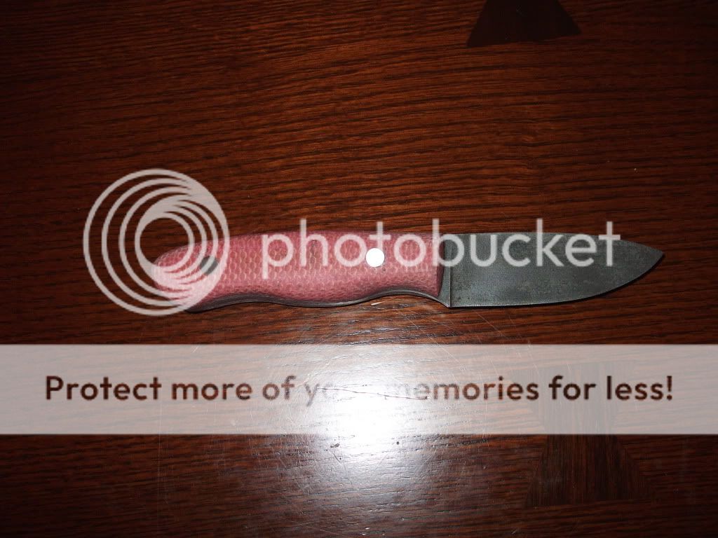

Ok, this might sound like a stupid question but Ive never worked with Micarta before, only wood. I have this knife in progress for a buddy whos wife survived cancer. Ive sanded up to 120 and there are numerous dark patches and brown spots as well as open grain, I guess you would call it. I initially was going to sand up to 500 and stop but now am thinking I should go back down to 60 and start over. Will going back down in grit smooth it up and what are your finishing techiniques for this stuff?

Great looking knife by the way! I think it looks finished, lol.

That is a great looking knife.

Great looking knife!

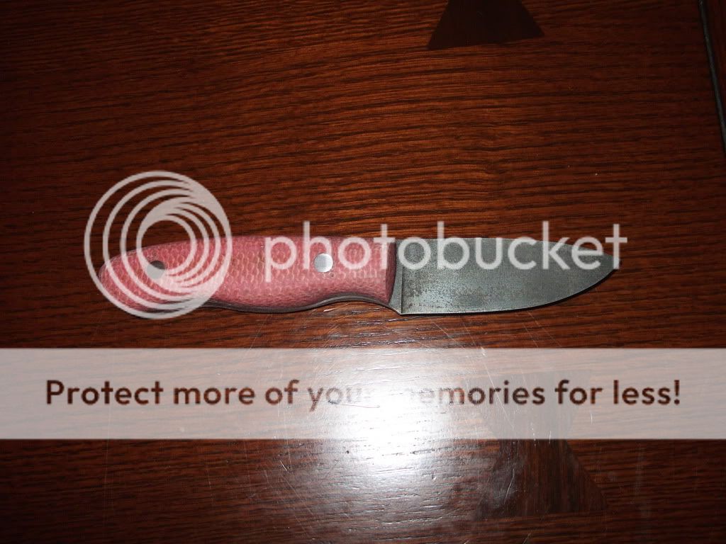

Thanks guys. I think it was from using the belt. I took a little more off, hand sanded up to 220 and finished with the scotchbrite pads like Andy suggested. It looks really nice!
And took very little time to complete also. I love using that burlap.
