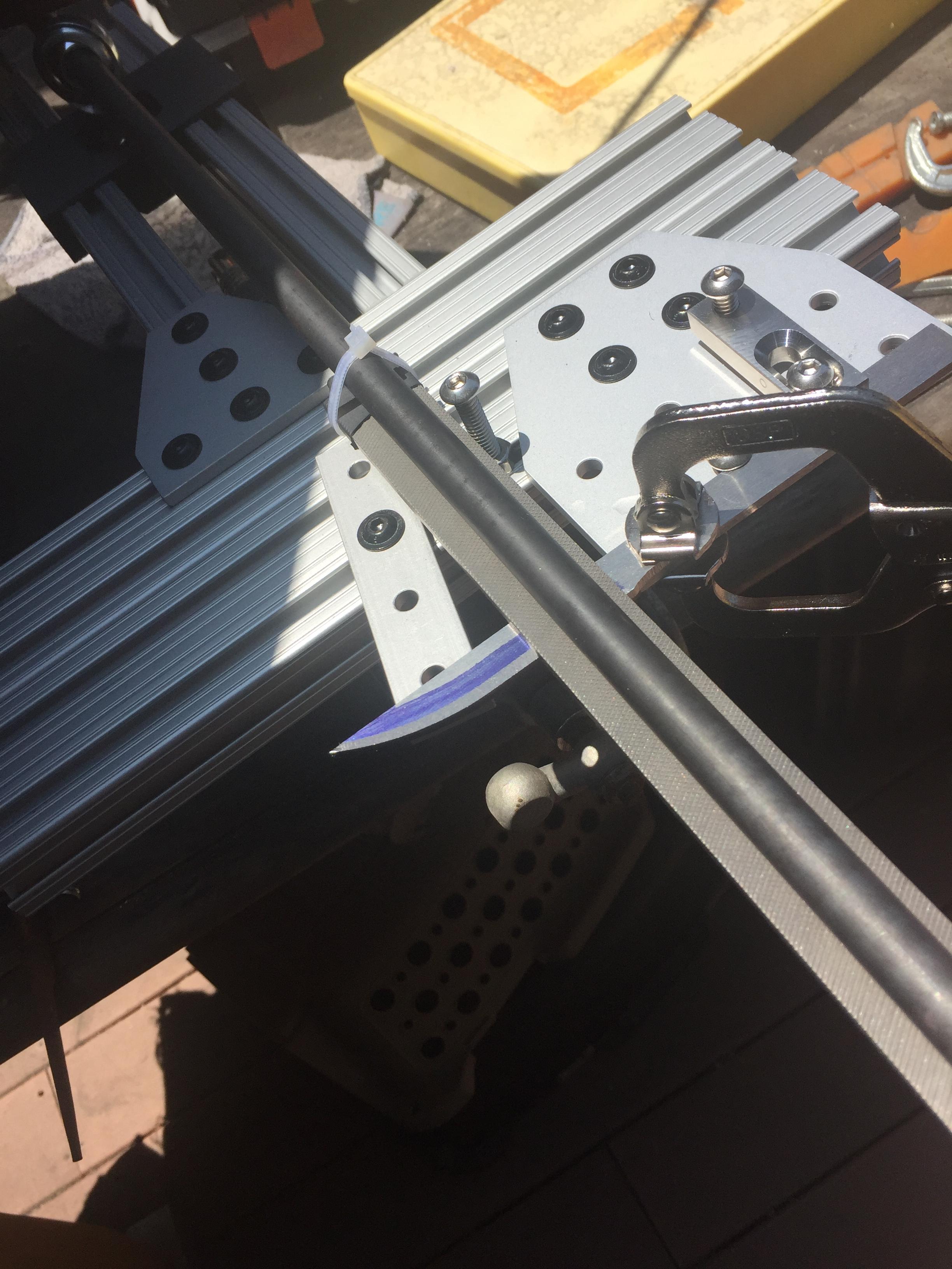

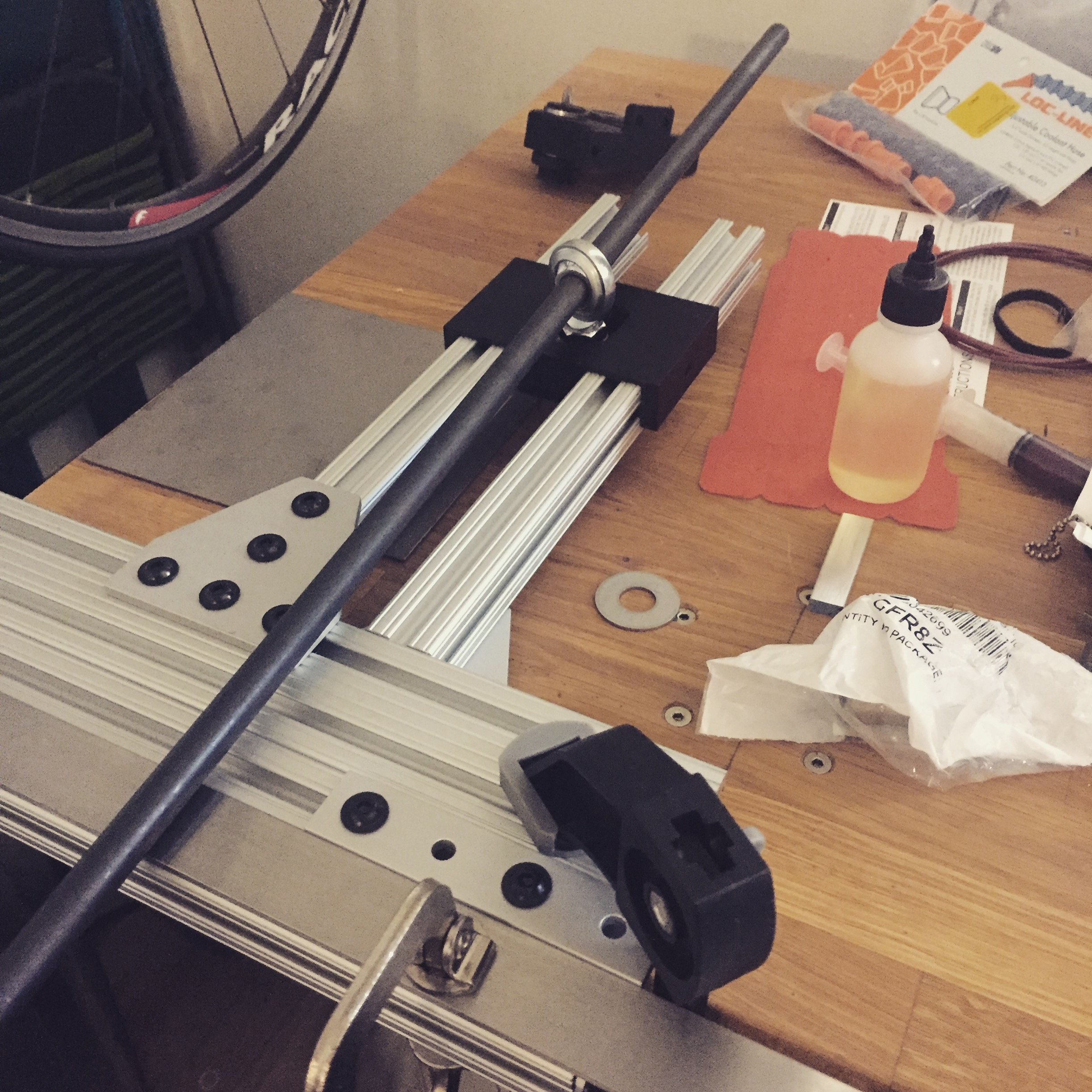

So I start with making a file jig. Belt sanders are cool, but I have too much junk in my back patio, and I want to start small and slow too. Plus, I like making jigs. I used 80/20 parts, and 3D printed a solution to use a rod end instead of an eye bolt.

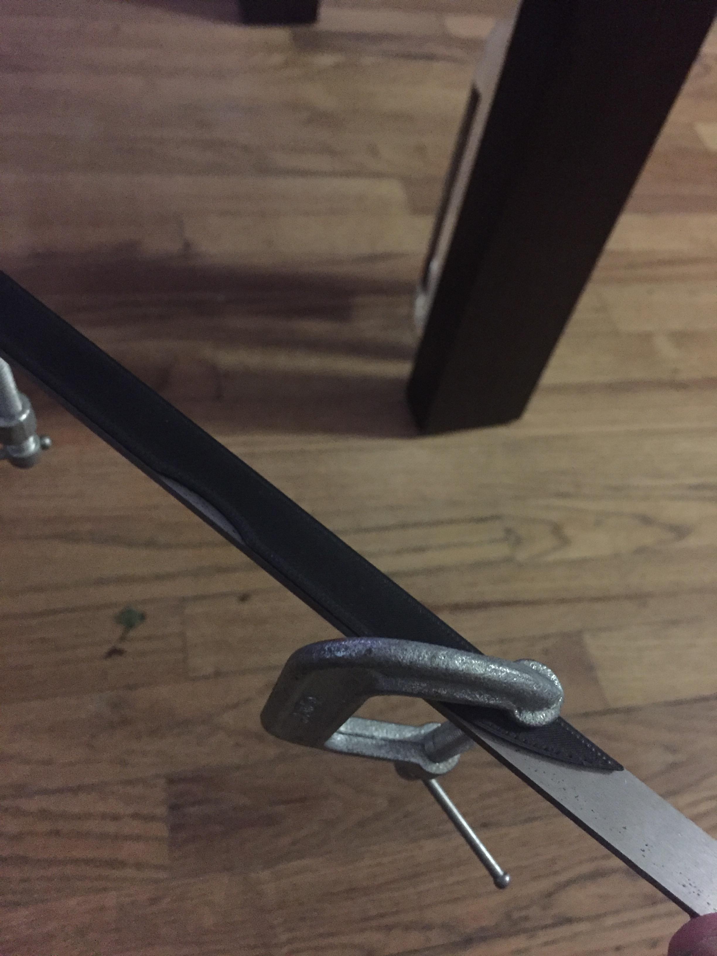

This was pretty fun to make, just needed to fine tune how I was going to clamp the blade and make the plunge line stop. I ended up using screws through the mount holes to provide a back stop, then clamp down on the steel.

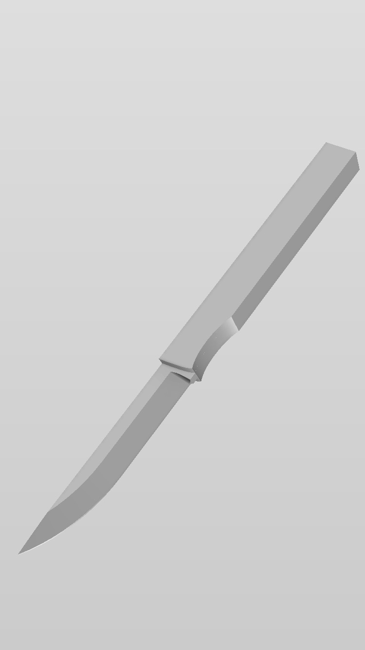

I made a rough model of the knife in Fusion 360 so I could print out various stencils of the blade profiles and handle.
Next I printed up the stencils and got to work on marking my lines and making cuts.

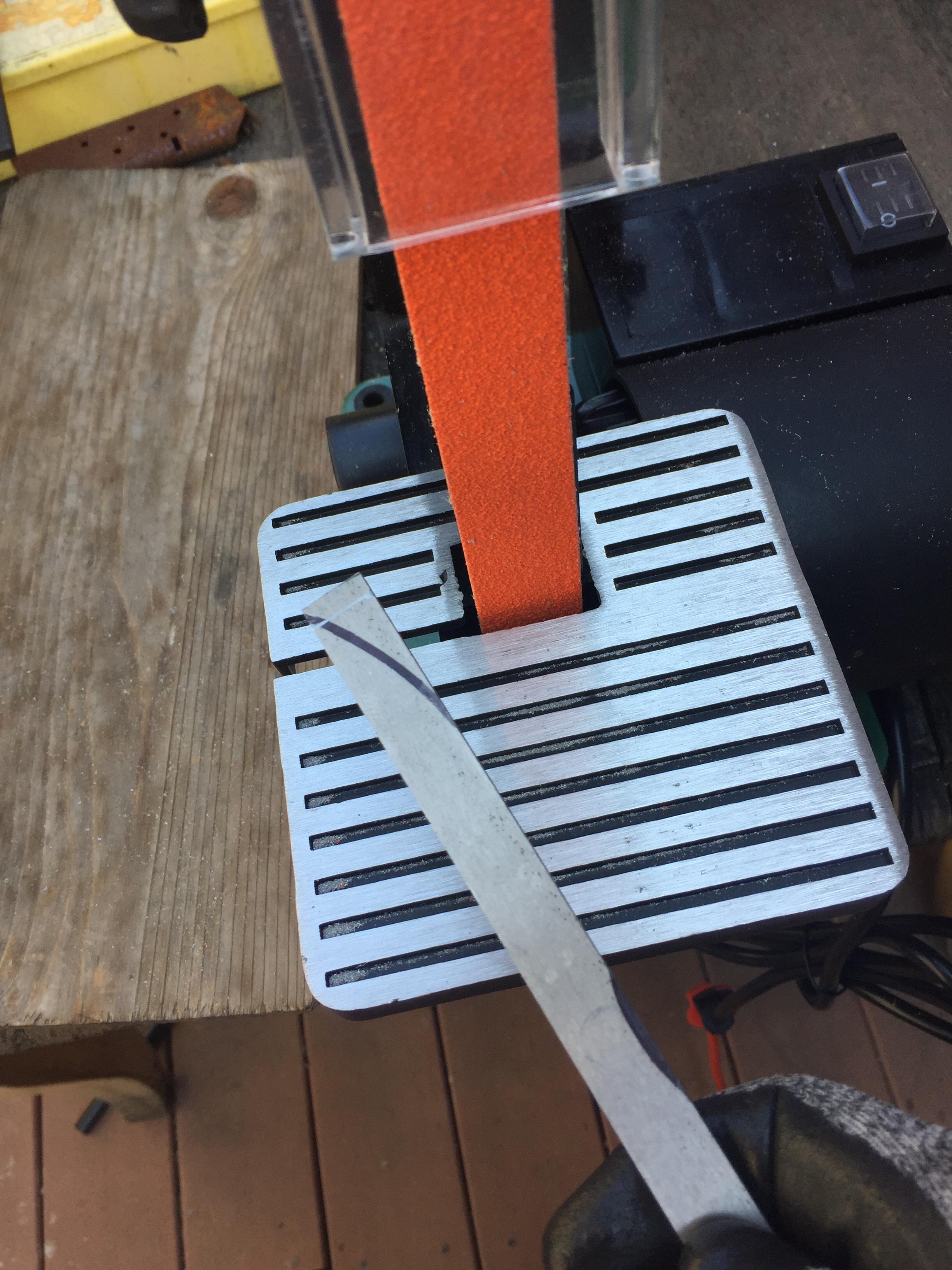

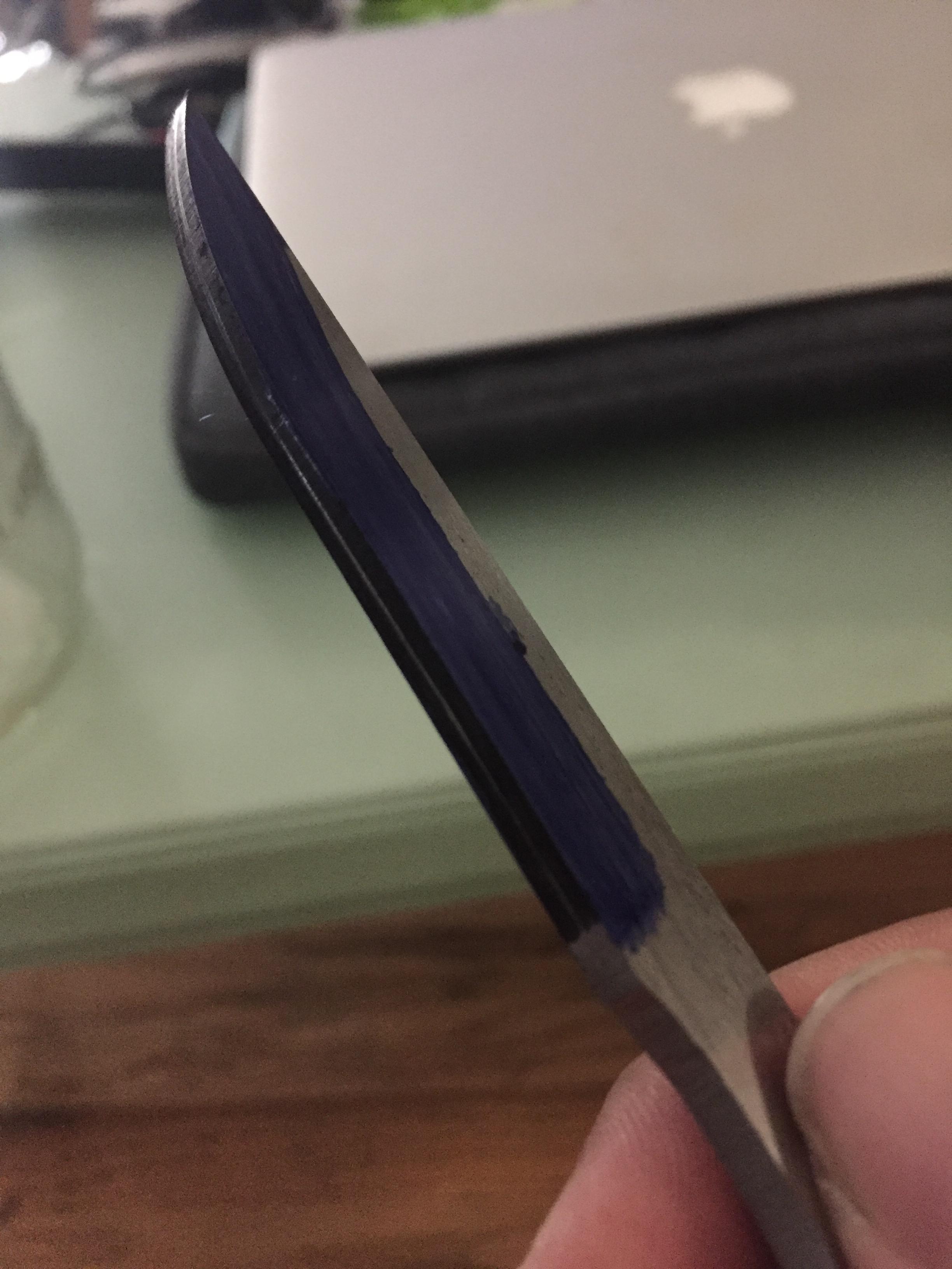

Now time to really get down to the bevel. I did realize I should have just scribed the bevel line, it's much sharper. Maybe I'd use a spray dykem? I originally had my file zip tied onto the rod, but it started to come loose, so I went to hose clamps. I also made a very intricate, cool plunge line stop using a bearing to hold a 1/4" rod... but so far I think I like a simple 1/4"-20 bolt the best.
This takes some considerable time too. A couple hours in, and though I took some time figuring out the best way to adjust my angles, I didn't fully get one side done.

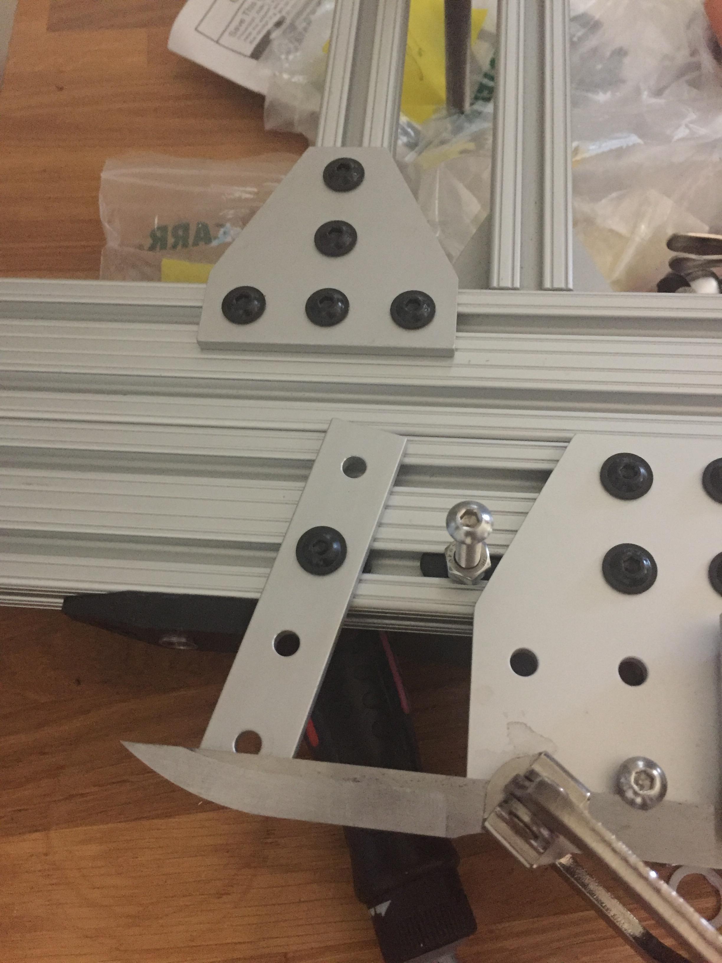

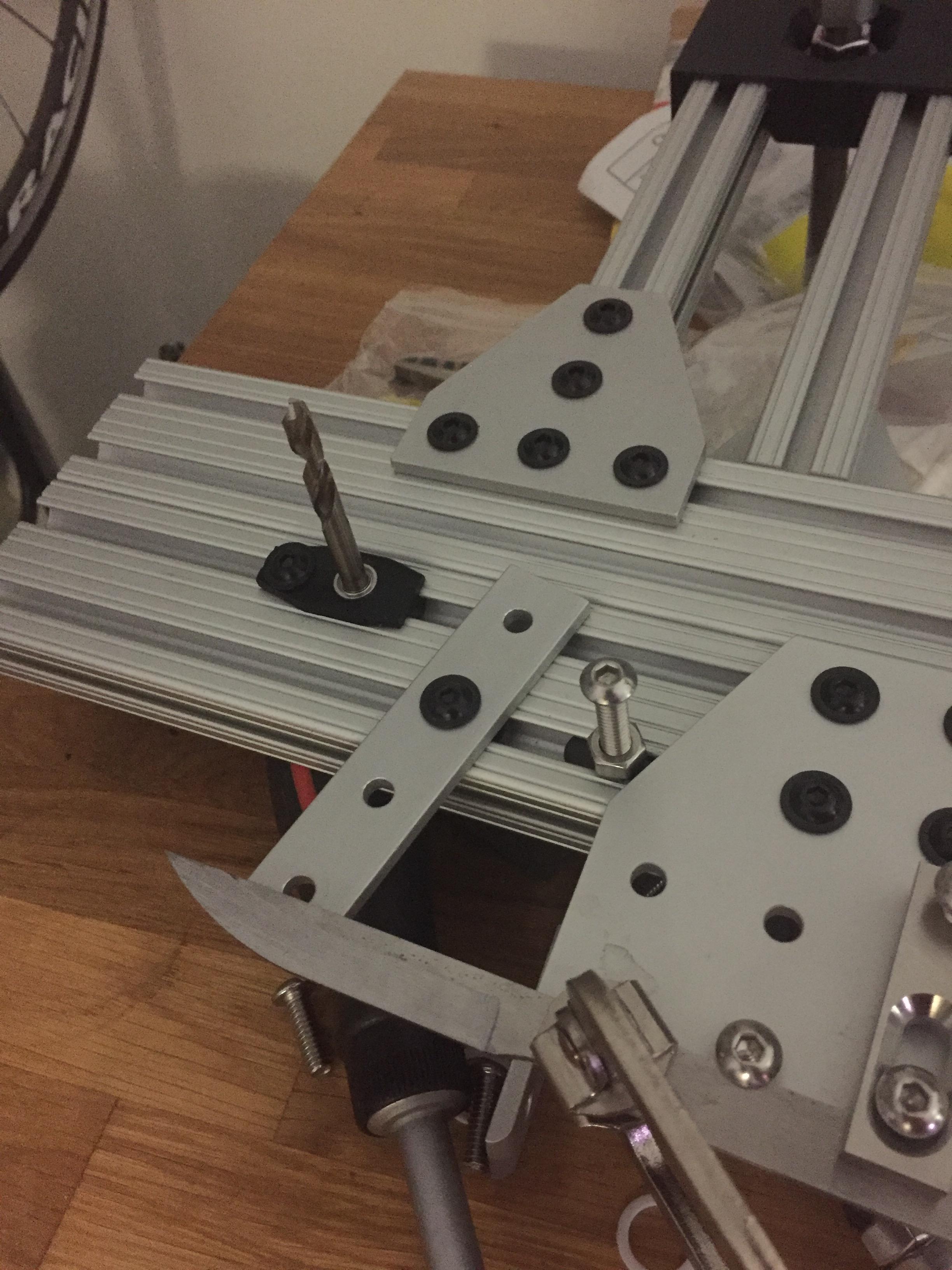

And here's my simplified plunge line stop.
Here's my new revised stop that I'll test out next session.
My thought is that I can set my stops as my first step, then I'll know where to clamp my blade down, and I'll be able to go from side to side to get an even bevel on each side (Not planning to use a drill bit like that in use).
I would like to make a template for my blade in the future that will index the clamping point for a repeatable position.

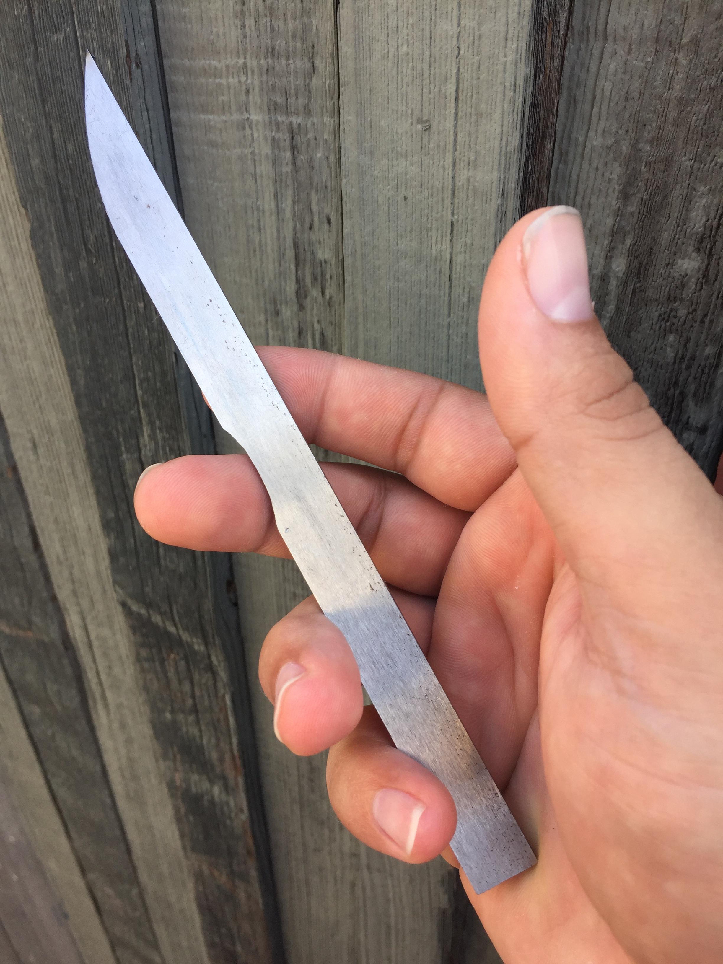

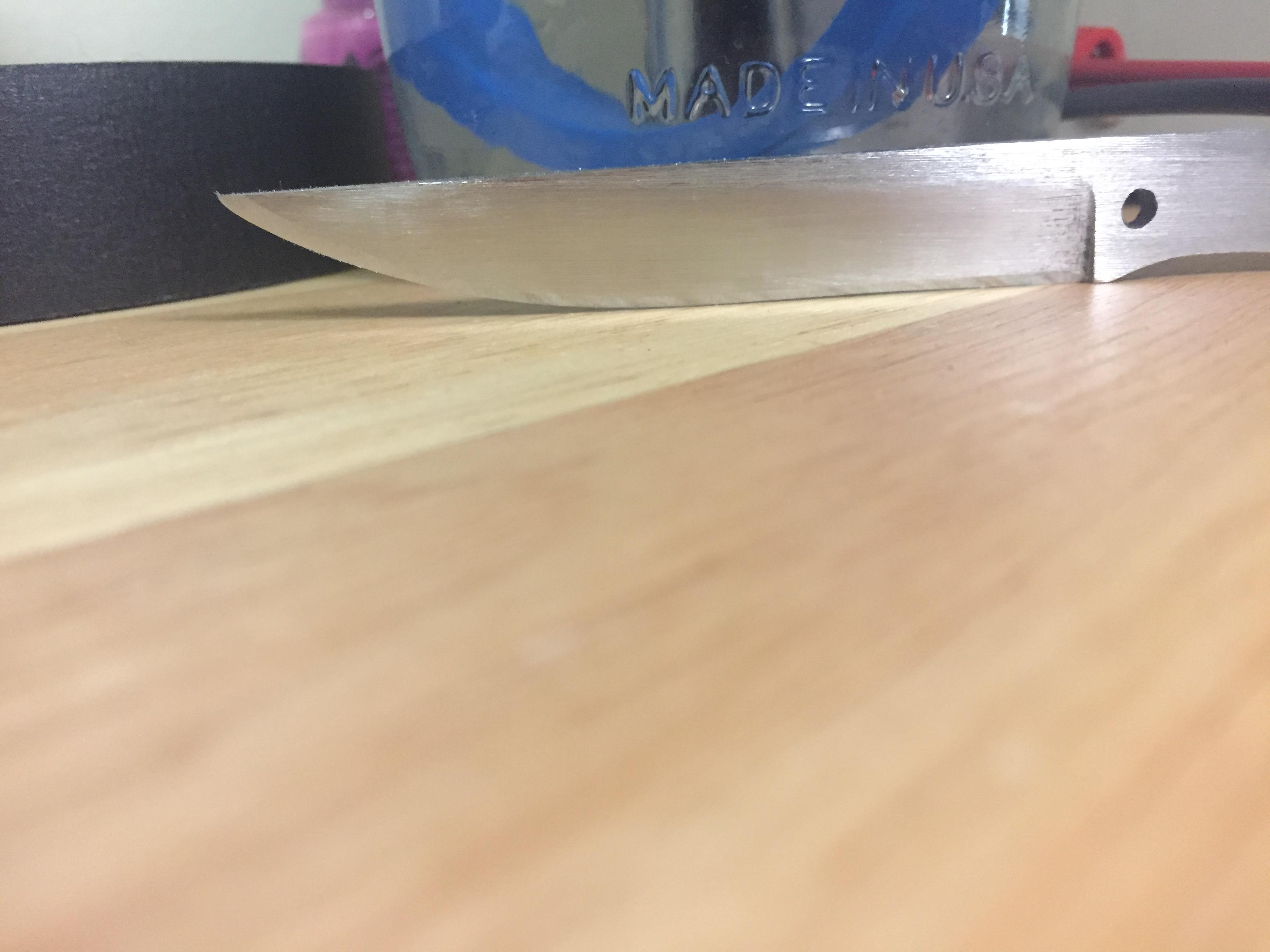

So I got a heat treat in, not sure if it took, but I smacked some maple on the not finished edge and there was no deformation... so eh, I'm not concerned about it either way. My plan has always been to send out for professional heat treat, but I just want to practice getting my shapes down.
I cleaned up my bevels by draw filing before the heat treat, and again afterwards to clean off the scale, but I can't get to the plunge area at all (it's also pretty gouged up by some very faulty early filing). I've already ground up farther than I wanted, but whats the best way to get to that area? Should I put sandpaper on my filing jig and go back at it there?

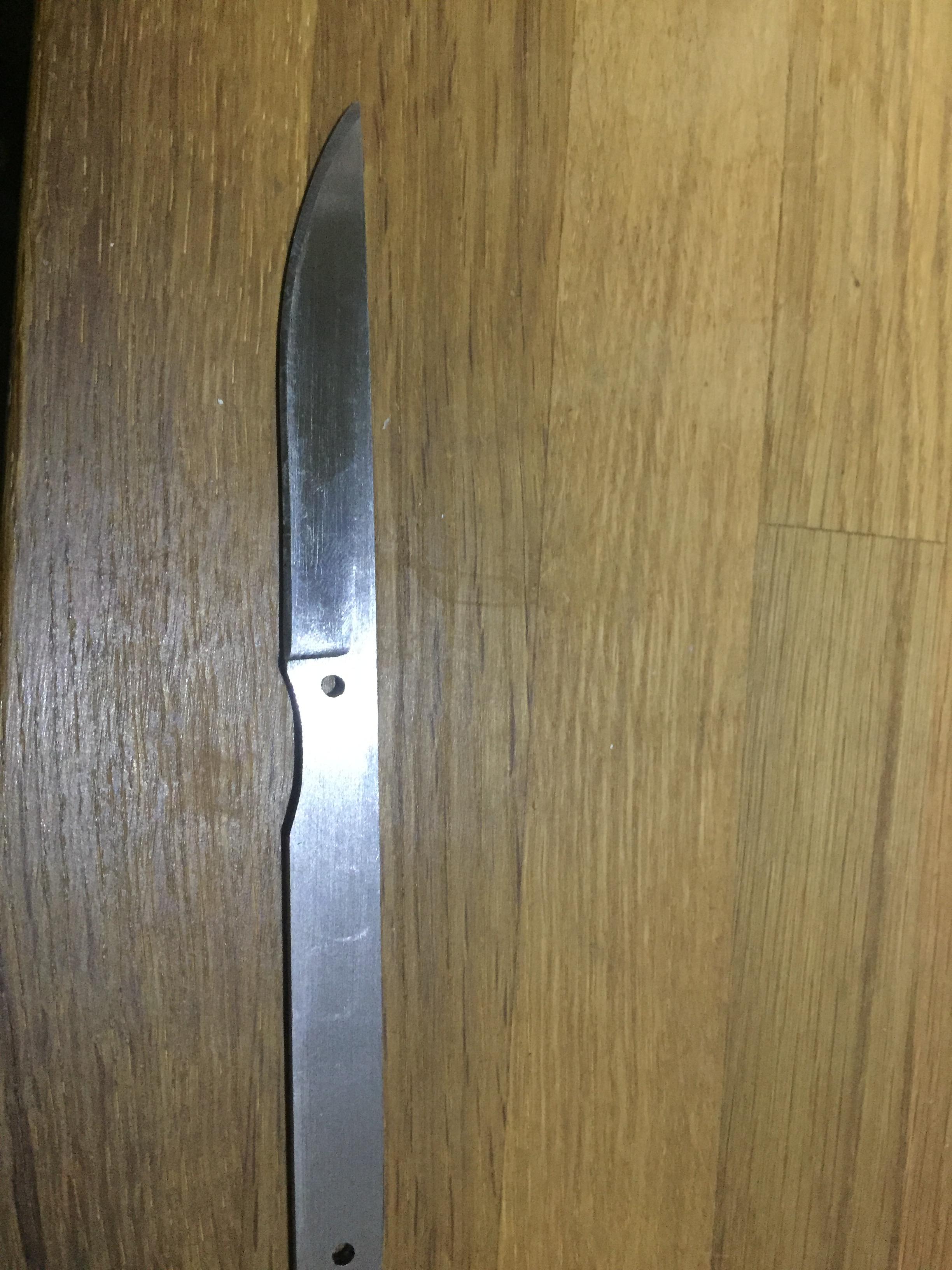

I got impatient waiting for my handle materials, and was really curious if my heat treat took. Then I just caved to some friendly peer pressure and decided to go ahead and put an edge on it.
It's a good thing I did because I can clearly see where my grinds were uneven. I left about .030" on the edge before heat treat with a bit more on the tip, and I was advised to just go to sanding, and then putting an edge on it after the heat treat. Doesn't seem like that was good advice. I think on my next one I'll file down to a minor edge after heat treat, then draw file only the flats, and sand before putting on my edge.
I'm also going to get the super coarse wicked edge stones, even the 100 took a long time to get an edge on this. I basically only took it to a 20DPS 200 grit finish, but it still shaved some hairs and has been opening boxes for a couple days.
